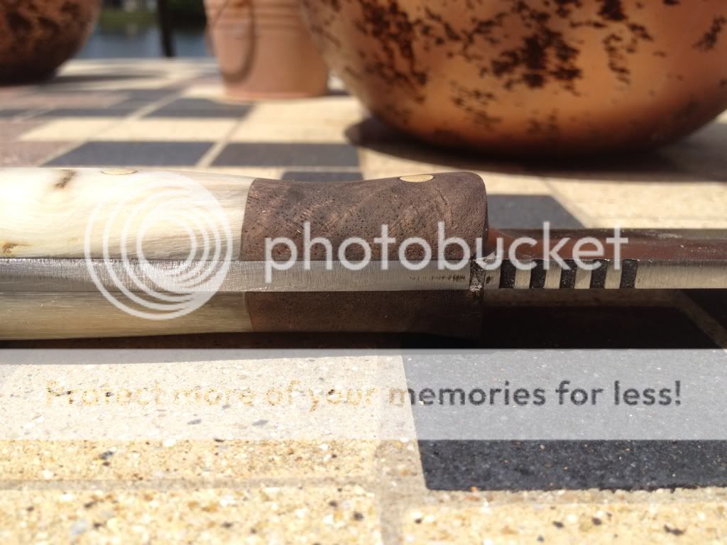

Oh yes, first time doing a bolster, turned out nice, need to pin and polish up everything

can we see some top-down shots? I wanna check out the bolster joint and see if u put the liner in there! lol

I'll snap a few tomorrow, I didn't end up using the liners, the horn and wood was already pretty thick to start and I didn't want to have to sand down almost all the horn and wood to get it to a comfortable level

Here you go, not quite perfect, but close, I learned alot about doing a bolster for my first go at it

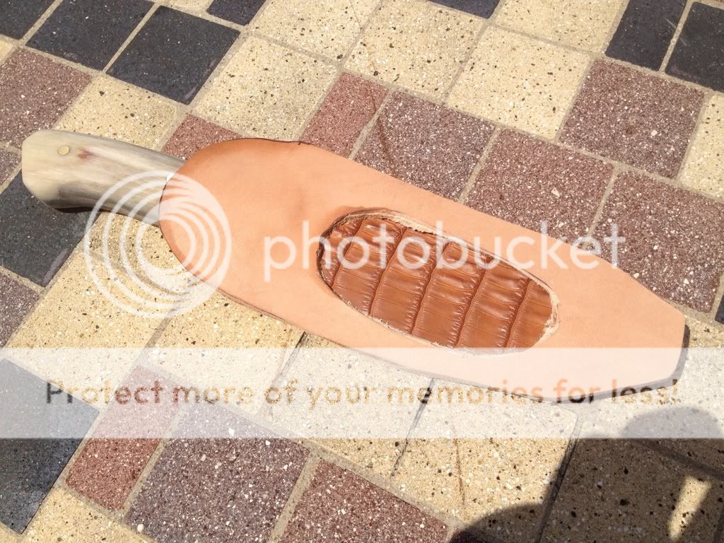

And here's the rough idea for the sheath, can find half my leather working tools, gonna have to pick up a few and some dark brown dye
looks pretty good! I was curious as to if ya beveled the bolster joint. That claro in close-zoom almost has a cork-like texture, kinda cool. I like it man, I should order that set of horns I've had in my cart forever. Were they long enuff to do a tweener without bolsters? or were they too short?
They would have been long enough to do all horn handles, and I almost did it that way. I was a little sad that the outer layered the horn had to be completely sanded/ cut down to make the handle the right thickness, when I do horn again, I'll look for thinner slabs, although they have a bunch of character that has come out, so I'm happy with them.
And yeah, I was noticing that about the walnut the other day, I need to tape up the blade and horn and put some CA glue on it to fill the voids
