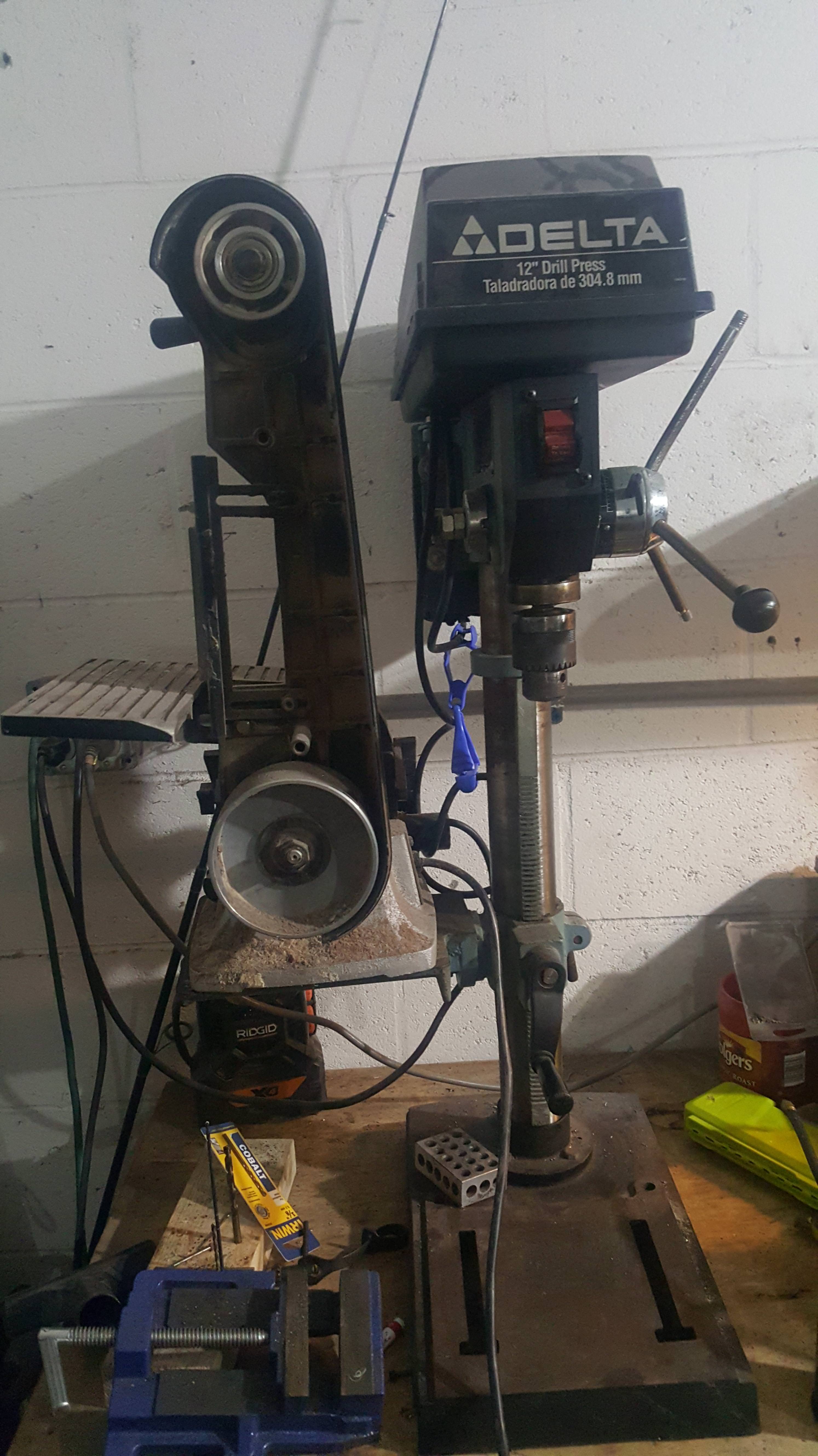

Im contemplating going a different route but it seems way more complicated and expensive so i may not. Im thinking of making a benchtop surface grinder.
Basically use the rack and pinion design of the drill press, with the 2wheel design and belt of a 2x42 ,with the tracking and tension of a 2x72. And a milling table underneath
Just picture the milling table underneath this
