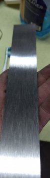

IMG_20180305_211134077.jpg Well, I took some measurements. Varience over a 6" long piece was +-.002". I'm pretty happy with that. I really got it dialled in once I figured out how the GIB adjustment worked (not really gibs, but adjustment is possible to tighten it up). Here's the test piece at 120 grit.

.002" over 6"? Good enough for me -
