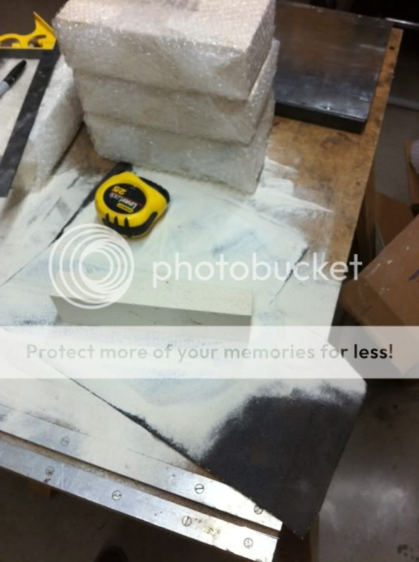

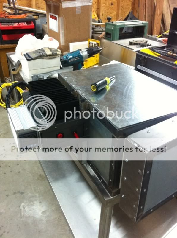

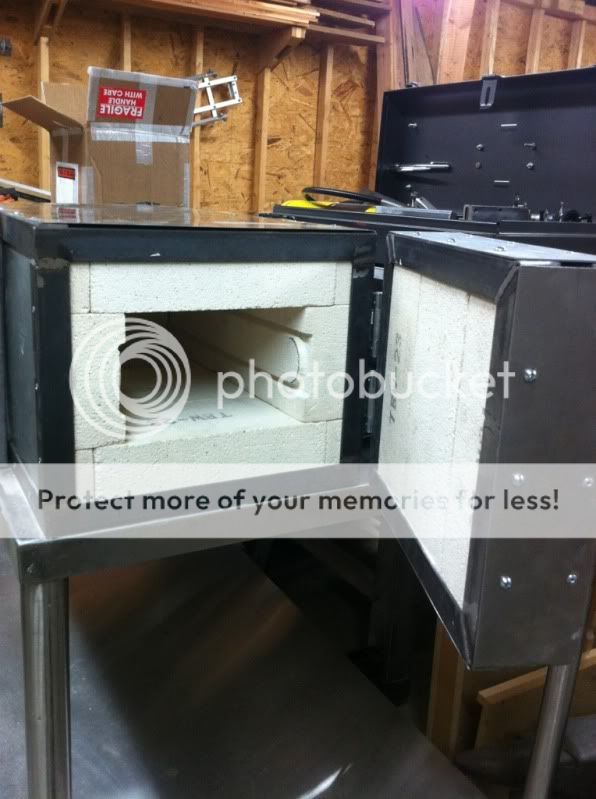

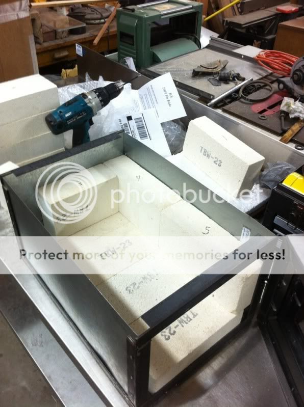

Decided to build an oven. Got the box built. Waiting on the bricks to get here. Also got the control box built and wired up.

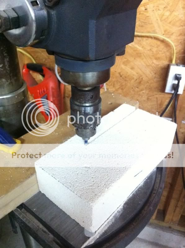

I used a 1/4" core box router bit in the drill press to cut the grooves for the elements. Then used a 5/16" bolt to open them up a bit. The elements are .29" I think.

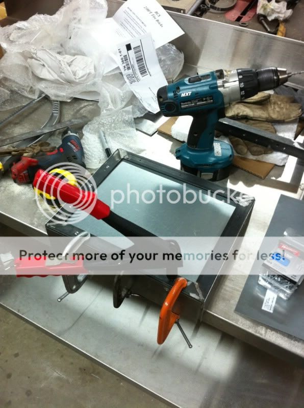

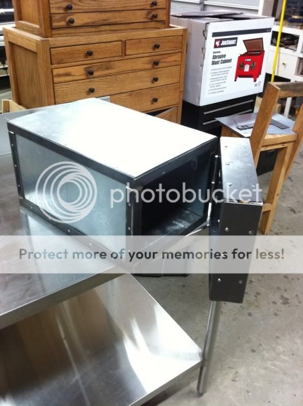

Putting the sheet metal on the door. The c-clamps are really handy when drilling for the rivets. Keeps the sheet metal from bending. Plus it keeps all the holes lined up.

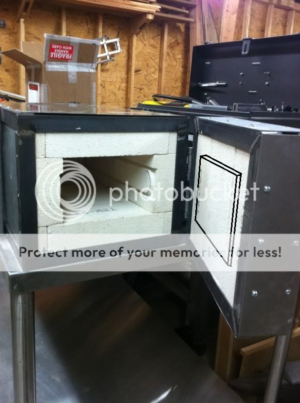

How are you addressing the gap at the door? I have seen a 1/2 thick brick cut to the cavity size and cemented to the door. It acts as a plug when it is shut. I suspect that without something the angle iron is creating almost 1/4" of gap exposing the metal frame to the hot interior.
Kinda like this...

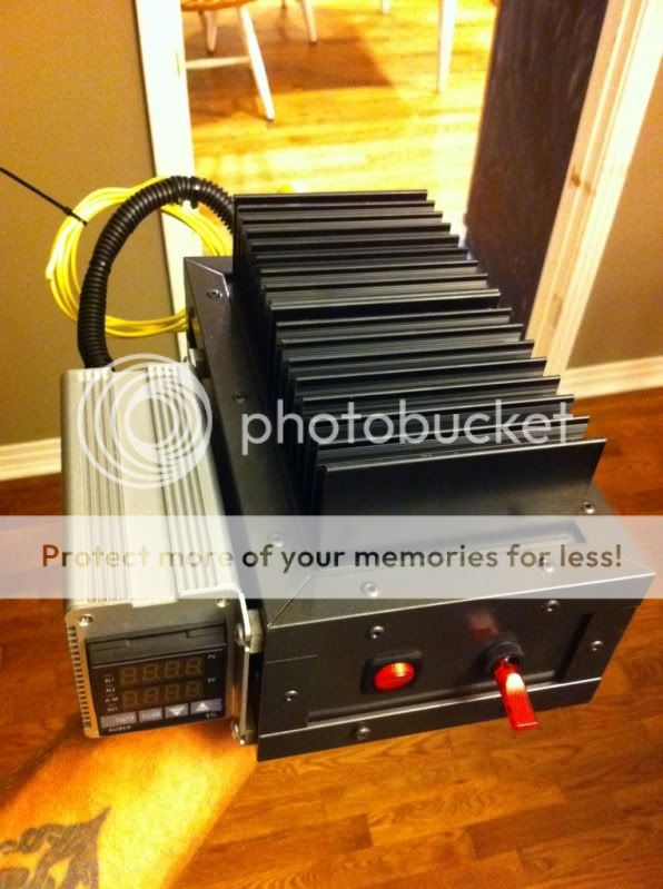

What was your total cost on the control box and relay ?
Where did you purchase it at?

I spent around $200 on the control. Im using 240v so I had to get 2 ssr's and 2 heat sinks. It would be a little cheaper with 120v.
I purchased it all from Auberins.

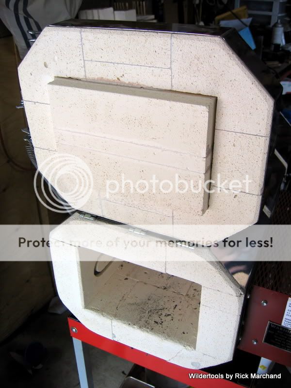

Normally, the door frame is thinner, and the bricks are trimmed so they stick out and fit the chamber by about 3/4".
Her is how you can do to modify yours, without trying to glue on pieces of brick or making a new door:
Mark the inside frame edges on the door bricks with a knife.
Disassemble the door, and set the bricks aside for the moment, keeping them in their positions.
Cut some extra bricks to 3/4" thick, and fit to the door frame so they sit against the sheet metal.
Cut a rabbit in the old door bricks so they fit in place over the thing bricks, and stick out.
Trim in a slight wedge shape (10-15 degrees) so they will self fit the chamber with a few open/close motions. They will show the snug places and you can trim until the fit is dead tight when the door closes.
If you decide to go with adding a piece to the existing door, use a piece of Insulboard and some stainless sheet metal screws, as well as the cement you showed. It will hold up better than thin pieces of brick.
It looks as though Sugar Creek cut a .75" deep pocket in the door and cemented in 1 1/2 bricks. It is not a flush mount like my first suggestion. Perhaps with expansion and contraction, the flush mount is dodgy. Stacy's idea is definately more sturdy. Either way, it's wise to address the seal.
