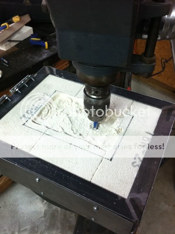

Normally, the door frame is thinner, and the bricks are trimmed so they stick out and fit the chamber by about 3/4".
Her is how you can do to modify yours, without trying to glue on pieces of brick or making a new door:
Mark the inside frame edges on the door bricks with a knife.
Disassemble the door, and set the bricks aside for the moment, keeping them in their positions.
Cut some extra bricks to 3/4" thick, and fit to the door frame so they sit against the sheet metal.
Cut a rabbit in the old door bricks so they fit in place over the thing bricks, and stick out.
Trim in a slight wedge shape (10-15 degrees) so they will self fit the chamber with a few open/close motions. They will show the snug places and you can trim until the fit is dead tight when the door closes.
If you decide to go with adding a piece to the existing door, use a piece of Insulboard and some stainless sheet metal screws, as well as the cement you showed. It will hold up better than thin pieces of brick.

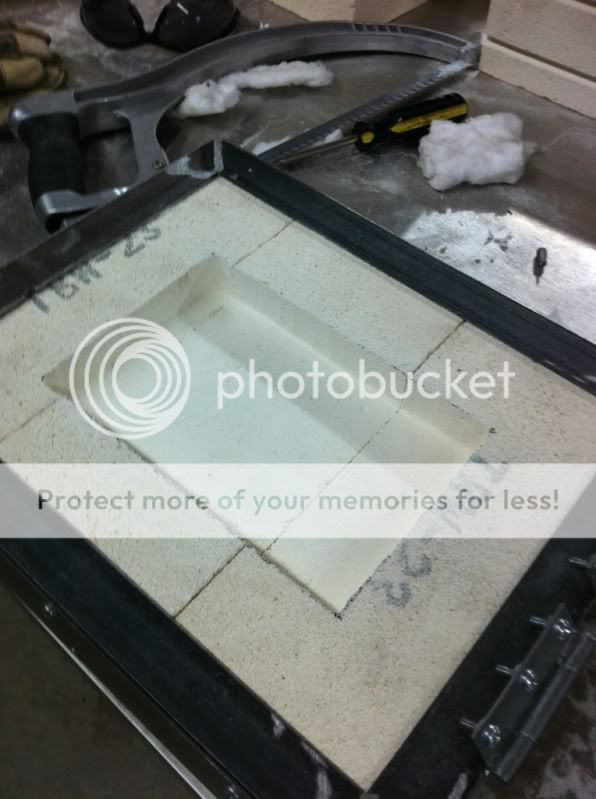

It looks as though Sugar Creek cut a .75" deep pocket in the door and cemented in 1 1/2 bricks. It is not a flush mount like my first suggestion. Perhaps with expansion and contraction, the flush mount is dodgy. Stacy's idea is definately more sturdy. Either way, it's wise to address the seal.

I think I'm going to try the way Suger Creek done it. This seems like it'll be the easiest way. I hope.

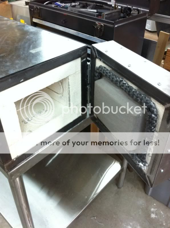

You can also get insulating rope and staple it around the perimeter of the door and the face of the kiln, then when you close and lock your door, it compresses the rope together giving a good seal without worrying about weight or fit. Is this the build from british blades?

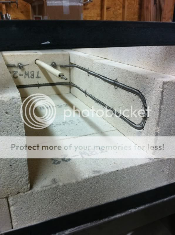

Yes it's the same build as British blades. Except I'm using only one 240v element.

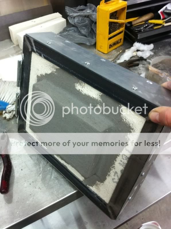

Here it is after I got a little carried away with the mortar.

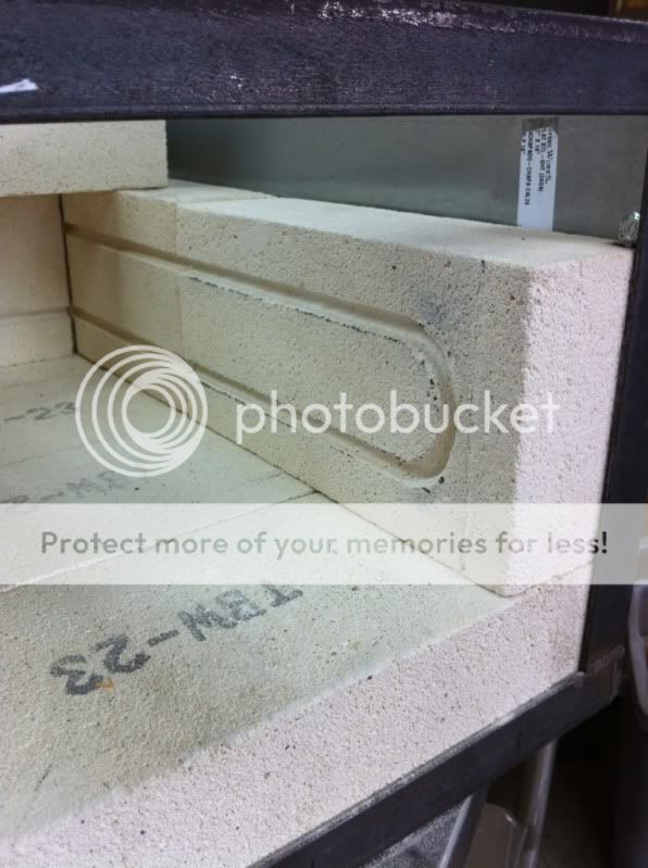

Also had to re groove the two front bricks.
Very clean. How did you line it up with the chamber? Simple measuring or do you have any tip/tricks?

Thanks Rick. When I built the case I made it so that I could remove the top at anytime. So I put all the front bricks in place then closed the door and marked it out. I want to thank you for pointing the door seal out to me I hadn't really thought about that much till you commented about it.

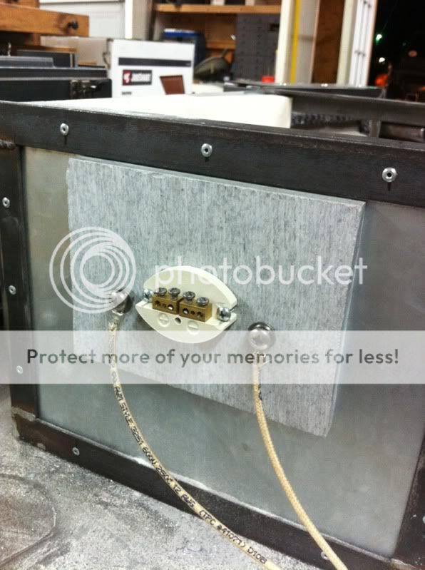

I knew the measurments of the bricks and went with that. Had to use the 60 grit sand paper on a few of them to help them fit. But I was pretty close though.
Here what I ordered.
PID http://www.auberins.com/index.php?main_page=product_info&cPath=1&products_id=4
SSR's http://www.auberins.com/index.php?main_page=product_info&cPath=2_30&products_id=30
Heat sinks http://www.auberins.com/index.php?main_page=product_info&cPath=2_30&products_id=224
Thermocouple http://www.auberins.com/index.php?main_page=product_info&cPath=20_3&products_id=39
PID box http://www.auberins.com/index.php?main_page=product_info&cPath=7_34&products_id=166
Element http://www.budgetcastingsupply.com/Heating-Elements.php I got the 240v one.
High temp wire http://www.budgetcastingsupply.com/wire.php
24 fire bricks http://www.budgetcastingsupply.com/Fire-Brick.php
Electrical insulation board http://www.budgetcastingsupply.com/Insulation-Board.php
I think thats all. Everything else I got locally.
