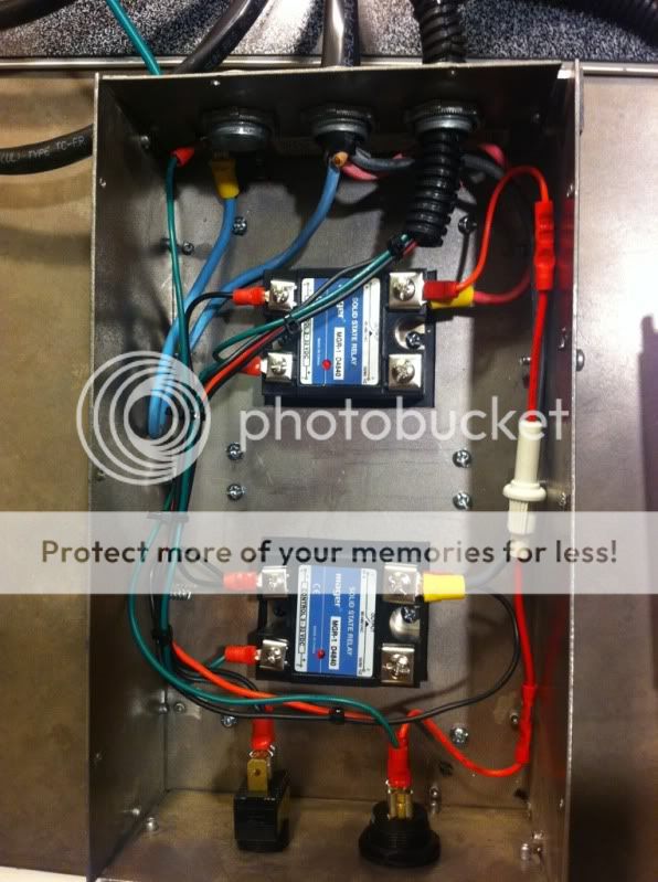

Here's a picture of the SSR's. I havent powered up yet. I don't think my illuminated DC switch is going illuminate. Anybody got a suggestion? I havent connected the element wires yet.
I think I figured it out. I think the negative from the 12v dc SSR output will make it work. Sound right?

In off-forum conversations with JB, I explained the microswitch and its importance. It is just a N.O. switch that is in the 12VDC control voltage line to the SSRs. The door closes the switch when closed, and opens it when open. This can be added at any time.

When making controller circuits, and you want to test them, use a light bulb connected to the power output of the SSRs and you will be able to see the off-on cycling as you test things out. Use a small torch to or heat gun to heat the TC for cycling the unit. If all works right in the lamp test, connect the coils and test the heating functions and readings. (If there is an interlock switch, make sure you hold it closed while heating the TC)
Thanks Bladsmth you have been a great help. And everyone else as well. I finally figured out the PID with some help from this forum. Thanks to everyone that has commented.
