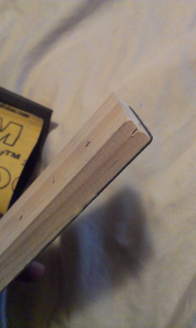

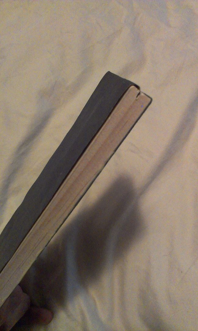

I've only used the back of the strop for using sandpaper because I'm worried about the abrasive contaminating the leather. Same reason why it's a bad idea to sand a partially finished carving. In all reality the abrasive probably wouldn't cause much of a problem if you aren't going for a mirror polish. It wouldn't hurt to glue a bare piece of leather to the back side for a little give under the paper though. In fact, I may try this. I too have heard that a mouse pad has a bit too much give and can wrap around and blunt the apex.
Please do!
Sorry man, I forgot to check back. When I get home I'll snap a pic. :)

Kepha, my field strop is packed, this one has the same feature.
Cut a slot at the top.
Cut paper to fit then you have one hand holding the paper taught at the bottom and strop with the other.
Take 1 or more grits to make a good field kit.
