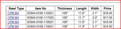

The myth of M4 being a super expensive steel seems to be alive and kicking.
Here is a comparison of the price of M4 and S30V, taken from the updated online catalog of AKS ( http://www.alphaknifesupply.com/bladesteel.htm )
Myth? You list some one-off pieces that do not represent the prices from the Crucible distributors in official sizes.
I ordered both M4 and S30V from Crucible, for a 1/8"x2"x36" bar it was $62 for S30V and $100 for M4. M4 is about 40% more expensive per pound than S30V and 3V, 25% more expensive than 10V.
Basically you're paying $100+shipping for enough steel for about 3 fixed blades.
So, according to your own data, there is a 38$ difference between a bar of S30V and one of M4, that bar allows you to make 3 fixed blades, so a difference per blade of a whopping 13$.
And we are talking about custom knives, which cost several hundred dollars...
True, I only brought up S30V because you did, and my response is that M4 is more expensive. You also have to take into account the higher austenization temperature of M4, and the 6 hours of tempering at a high 1025F, and the fact that M4 is not stainless. So you can see why M4 has never caught on. I know only a handful of M4 fans who would pay an extra $20 for M4 over S30V.
