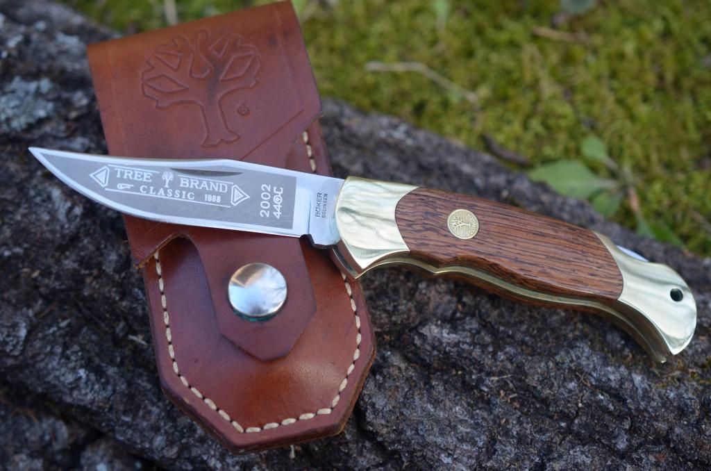

Whooo! That stag is gorgeous! Who did the work for you? I'm noticing that the stag on my Boker is mellowing out nicely through pocket wear.

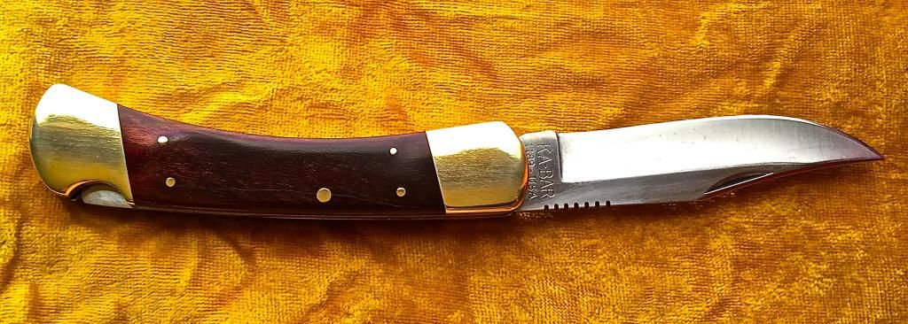

I put this together from a pile of parts that I bought off of eBay. The parts were (and most still are) a royal mess, but with some love and elbow grease I did end up with a solid and lovely old lockback. This is one of Ka-Bars that was made in Cleveland, Ohio after Cole purchased them. I am guessing, from what I have gathered, that this was made in the late 1960's to mid-1970's, based on the tang stamp.
The mark side scale (showing) had a big gaping crack in it that ran the length of knife, through the rocker pin (you can see it in this picture). I epoxied it together and then use some CA glue to fill in the crack, and then lots of sanding and polishing. You can still see it, but it is stable. I debated replacing the wood, but the old rosewood looked very nice otherwise, so I think of the crack as character :)
I am not sure what kind of stainless steel was used on these, but it takes a wicked sharp edge that will shave hair off of my arm.

I've got one of those too and it does sharpen up nice and holds an edge well, my only complaint about it is that it is hard for me to close. I also have some of those Gerber FSII and FSIII.

If you mean the catch is too hard to disengage, I agree. I noticed that when I was putting it together. I ground a little off of the inside of the spring where it engages the spacer in the back so it would travel a bit further when compressed, and it now closes with ease.
I was able to get a really nice fit and final finish on this knife, which really tells me that the main difference between good and great knives, all other factors being equal regarding materials, is the attention to detail on fit and finish.
