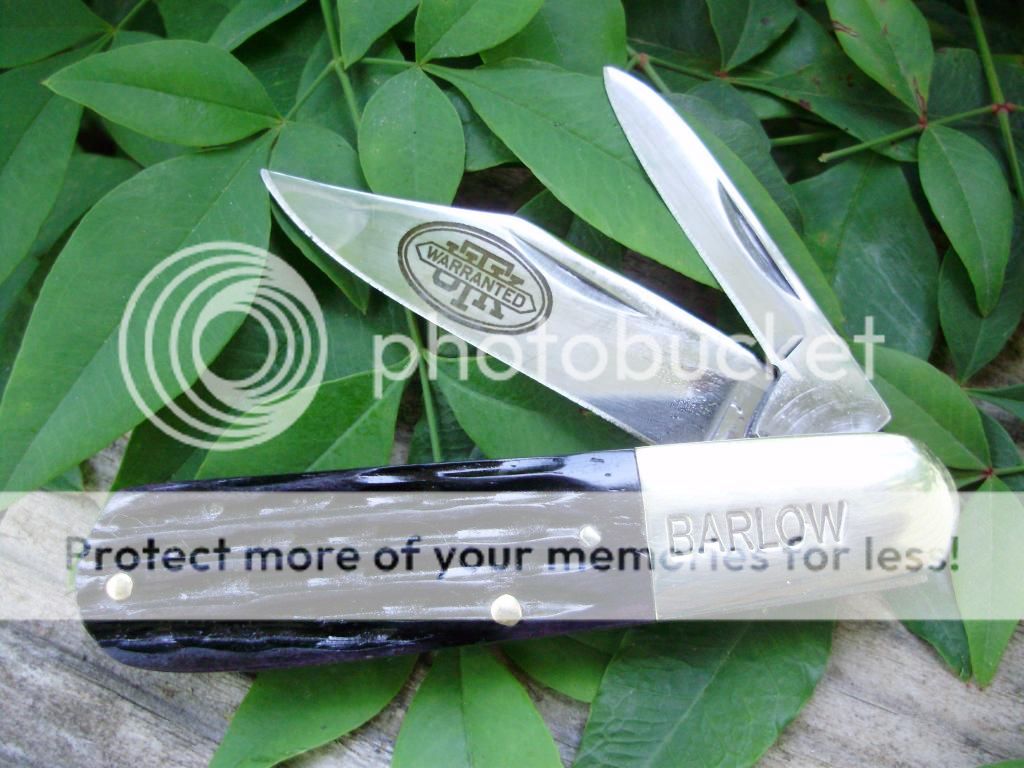

There are other factors besides spring strength that make a blade easy or hard to open. An example would be the nail nick on the pen blade of this Utica Barlow. If it were farther from the pivot point, it would be much easier to open, but that would have nothing to do with the strength of the spring.

Placement of the nail nick has some degree of help depending of the purchase of the pivot point but it will always come back to the strength of the spring in any case, The nail nick that is closer to the pivot in conjunction with a real tough Spring is a knife that would most probably stay in the drawer.
