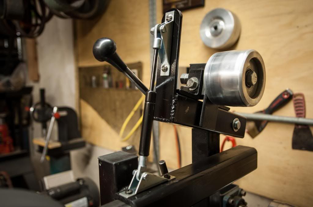

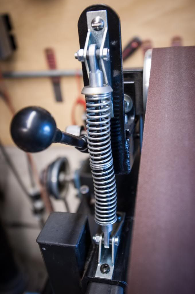

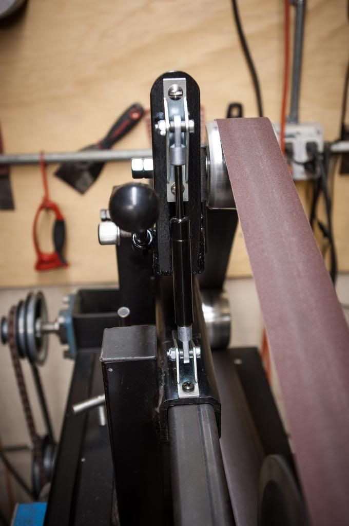

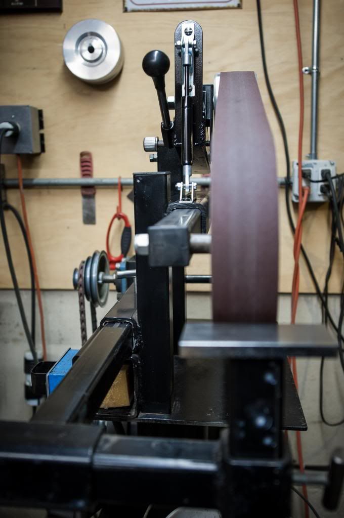

David, your grinder mods got me motivated to get the Fellhoelter inspired gas tension going on my NWG. I advocate the NWG for people with some fab skills - I love it's versatility and I would be happy to put mine up against some production options, but, like you, my next grinder will most likely be a GIB with variable speed. I got the parts you listed for the piston but knew I had some geometry to work out as we have different machines. My parts have been sitting in a drawer for some time. Today, I got off the horse and chopped some tubing off the top end of my grinder (back of the tracking arm - mine was longer than most) to get the gas piston to fit. It fit - tracking went to hell. Way too much angle in my tracking arm for the tracking adjustment to work. After a moment of silence and another type of condolence, I got the welder and some scrap iron out. I put an upright on the front of the tracking arm to accommodate the piston. Now, the thing tracks and responds like a dream, but I will swap that 20 lb piston for a 40 lb one when I have a need to order from MM Carr. Thanks for sharing your build. EA
World's first coil over spring on a gas shock for a grinder - or maybe not, I have no idea. It rocks. EA
Funny... I just ordered a 40lb from McMaster-Carr today. My 20 seemed a little soft for one of my grinders. I like your set up Erik.
Ha! My piston is too weak for my GIB too. I moved my tracking arm out and swapped the rear spring for the piston but it was NOT enough weight. Impossible to use. I moved it back to the original mount and added the rear spring again. Now it runs and tracks great. Piston in front pushing up and a spring in back pulling down.
