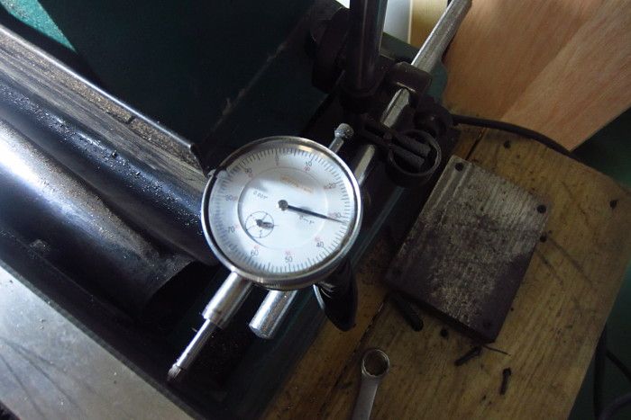

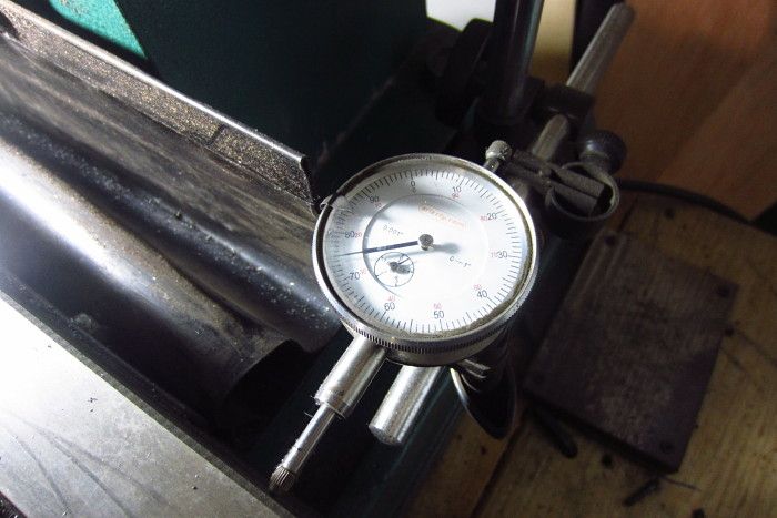

All you need is a mill - of ANY kind, a calculator and a dial indicator on a magnetic holder.

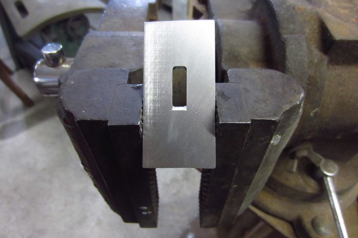

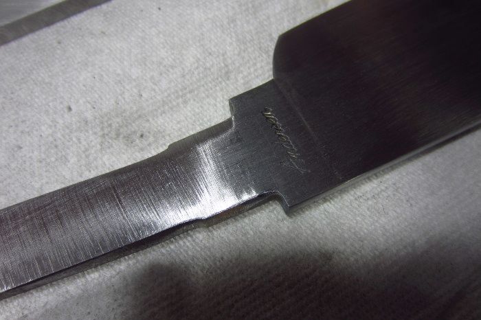

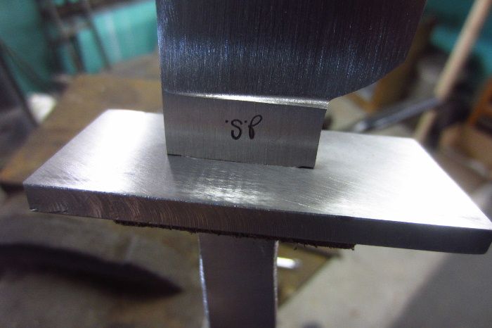

I will start out by showing a picture of a guard milled and slid onto a knife with absolutely not one other thing done to either the guard or the knife:
This is right off the mill:

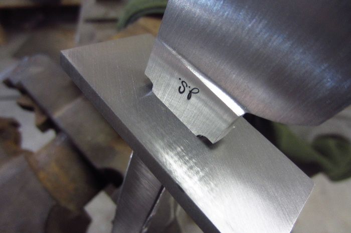

I have to say this, as this is just as important as the slot itself.
If we are going to be slotting a guard with a mill, we have to admit that both sides are going to be equal, parallel and symmetrical.
This means that the knife we're fitting the guard TO! needs to have the sides of the ricasso even, equal, parallel, symmetrical, etc.
Otherwise, things ain't a gonna work out.
So, get your knife flat and trued up first.
It can be done.

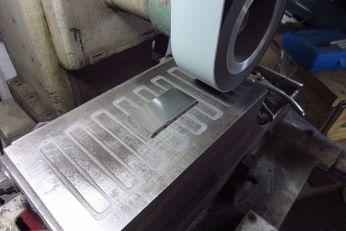

I now have a surface grinder, which makes things easier, but I didn't for the first 13 years of doing this!
Do whatever you gotta do. Get a granite surface plate. You need one any way. Just get one if you don't have one.
Use your dial caliper and a magic marker, sand paper and your surface plate or whatever, but get that ricasso to within .001" or less in dimension from side to side, where the guard is going to fit.

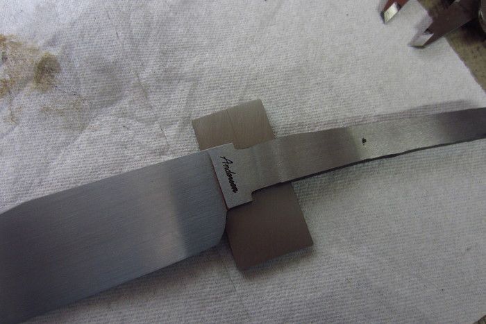

And we'll use a normal type knife with guard shoulders either filed in with a file guide or milled in with the mill.
But the guard shoulders also need to be true and straight.
Then we can proceed.
Preparing the knife itself can be an entirely separate thread, but here, we're just dealing with how to mill the slot.

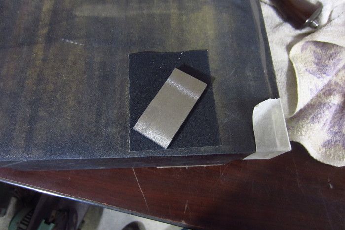

The first thing I do is get my guard material squared up on all four sides so it sits in the mill vice squarely.
I will be using an 1/8" end mill.
If we are milling a 1/4" guard, then no problem, we can mill it in one placement in the vise.
But if we're milling a thicker 1/2" piece, we'll need to mill 1/2 way through EACH SIDE!! So it's important that when we flip the material to mill from the other side, that it's sitting in exactly the same orientation. So, first thing is to get the material squared up.
You obviously have a mill, so get that done - first.
I don't really care how you do it, but get it cleaned up.
Either on a surface plate or on a surface grinder.

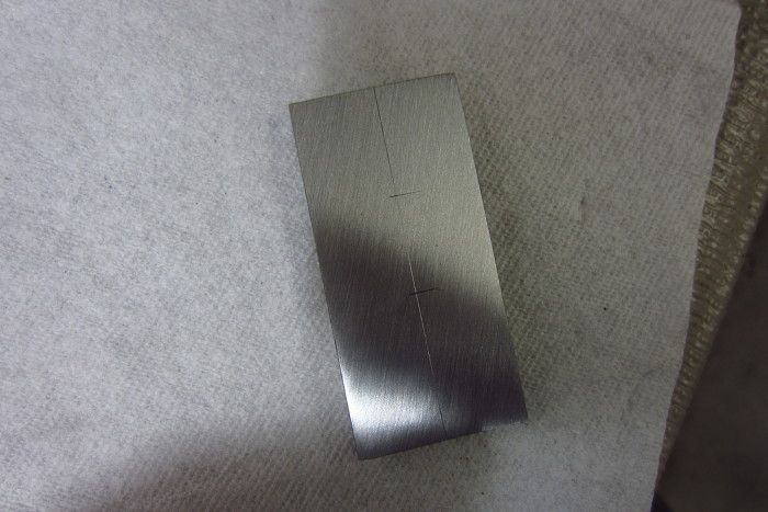

I will then take the FLAT and SQUARE material to the granite plate and lightly clean the surface at an angle, from corner to corner, so as to easily expose any scribe marks.
When you scribe a center line, it makes the line easy to see.

So, we located the center line, as seen above.
Now locate the top and bottom marks by laying the knife on the guard.
Here we have our marks:

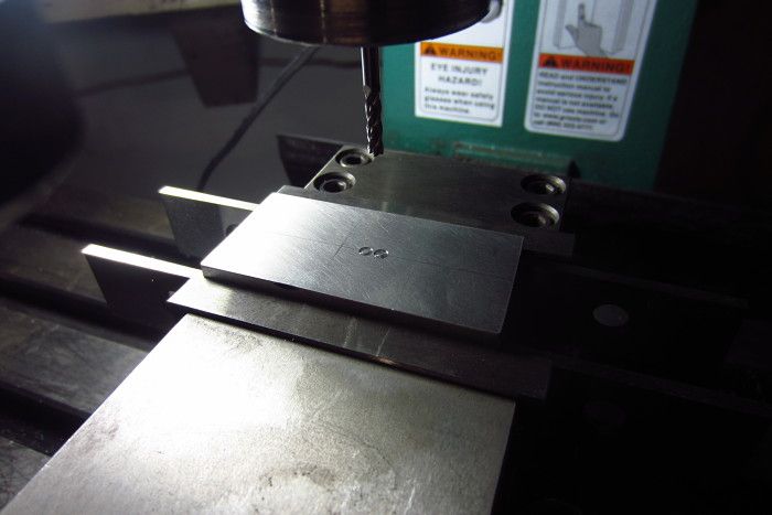

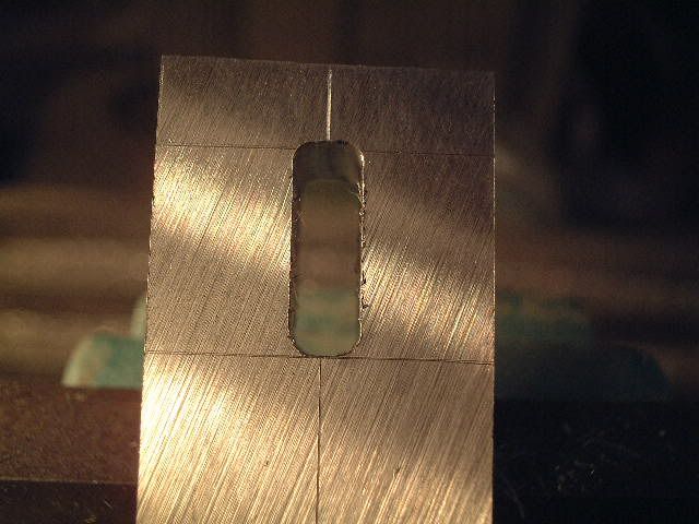

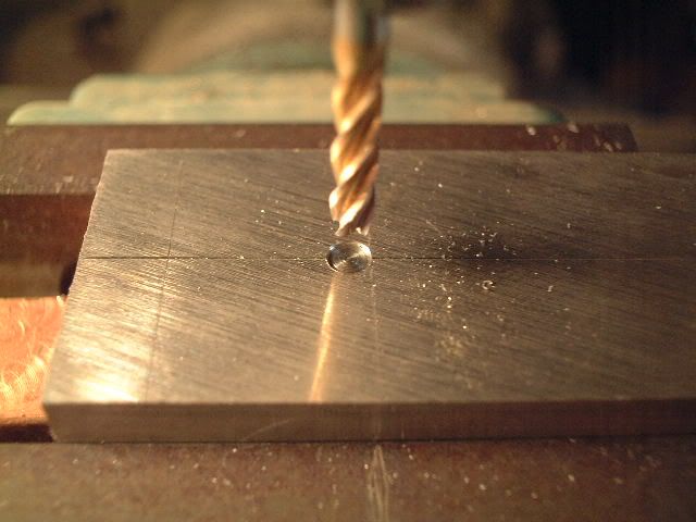

Now, I just want to find the center of the scribe line with the end mill:
(Notice how I have the slot height line lined up with the mark on the vise jaw)
Now, this is the important part!!
With the end mill centered on the center line of the guard material, lock the Y axis - in/out - and place your dial indicator and the magnetic base on the back side of the mill table and set the dial on ZERO.
Now find that top line with the end mill. This is a picture from an entirely different knife with a 1/2" guard, but shows the process quite well:
Now, at this point right here, when you have located both center and one end of the slot, you need to place stops on your X axis - left/right - to stop you travel when you reach the ends of your slot.

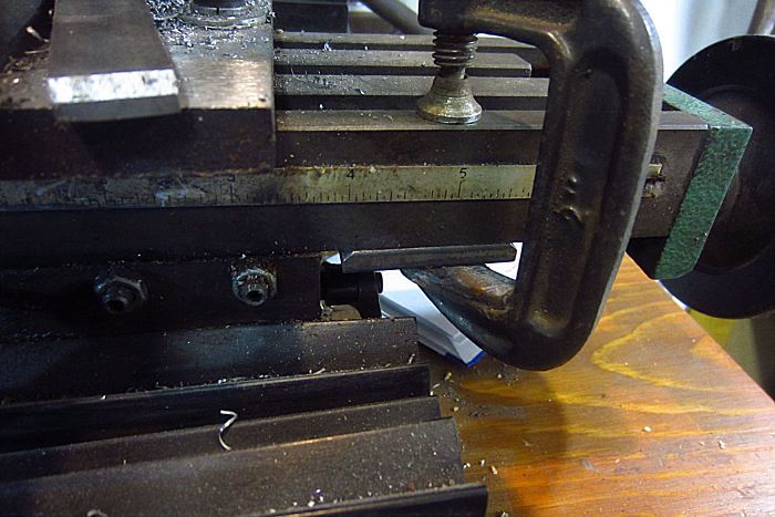

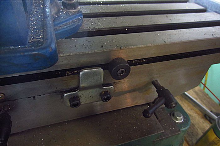

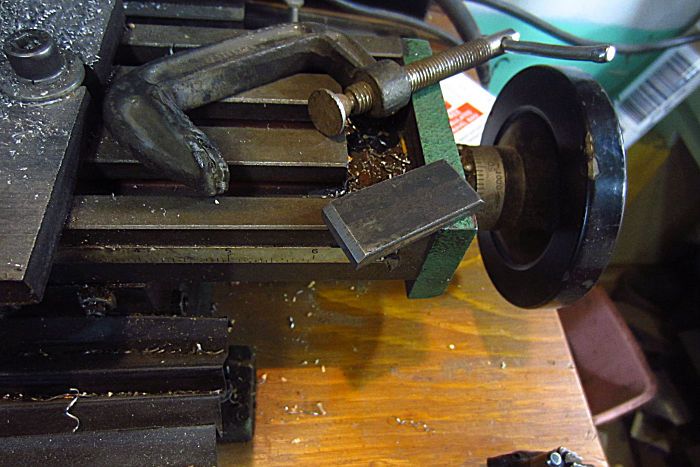

On my newer mill, I have locatable stops like this:
My smaller bench top mill did not have these, so I just used some C clamps and a small piece of steel on the bottom to bump up against mill when I reach the end of the slot.

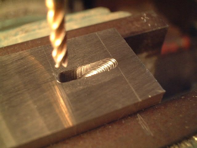

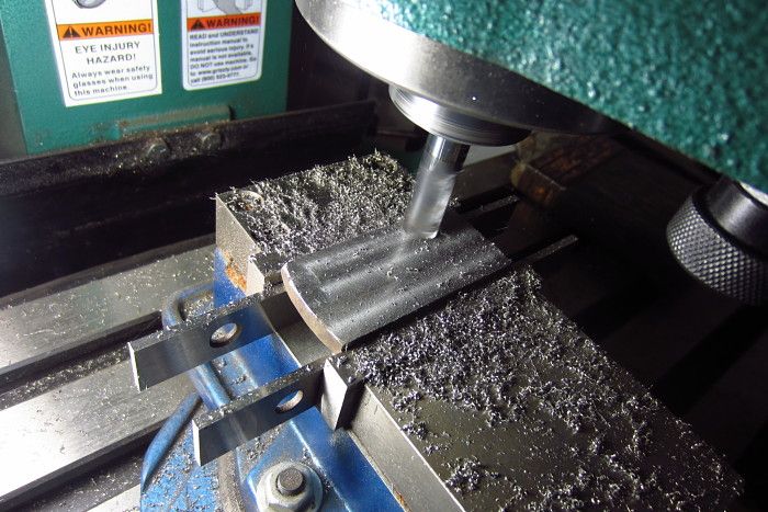

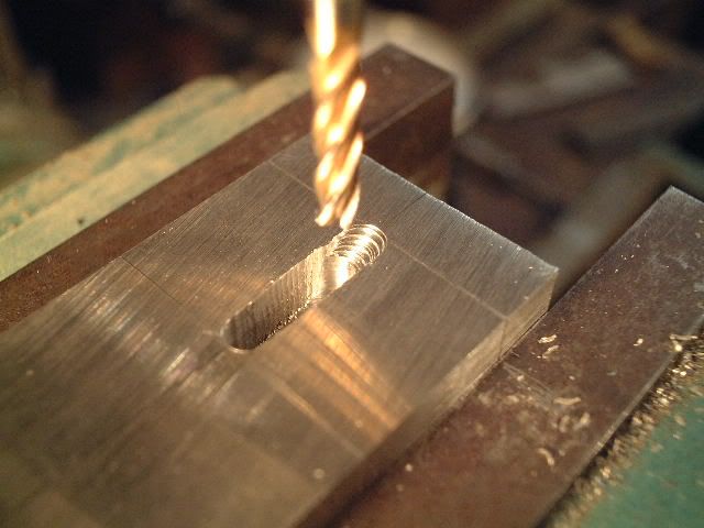

Now, with a stop set in place for the first end, start creating your slot!
Just use the lever and drop the center cutting end mill onto the center line.
Move the table about 1/3 the diameter of the end mill and lower again.
As the end mill reaches the depth of the previous cut, you can feel it hit the bottom.
Then, just give it a tad more down pressure and cut another "step".
Repeat.
Repeat.
Repeat.
When you reach the other end of your new slot, place another stop in whatever fashion you have available, to stop the X axis travel at this end of the slot.
Now, you do not have to even consider your left/right travel for the remainder of the project. :D

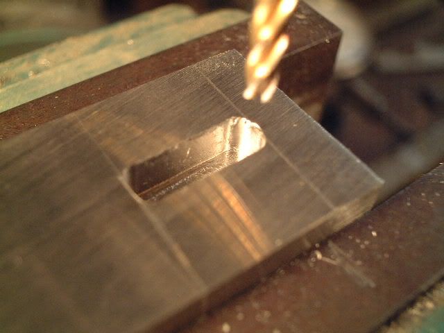

Now, go back in the other direction and chew out those "steps".
When going backwards, you are either going all the way through, or all the way to your depth stop of the thicker material.
This is important.
I slightly eluded to this earlier, but if you are milling 1/2" material, you will only be able to go 1/2 way through in the first pass, so you will need to have set a depth of cut with whatever option your mill has.
If thinner material, you'll be going all the way through.

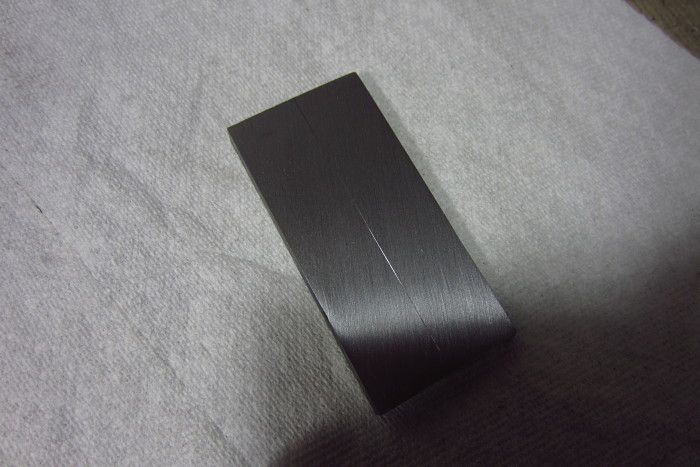

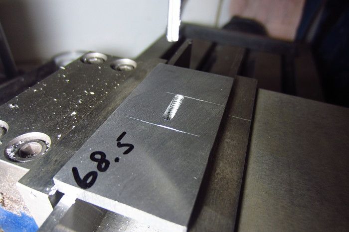

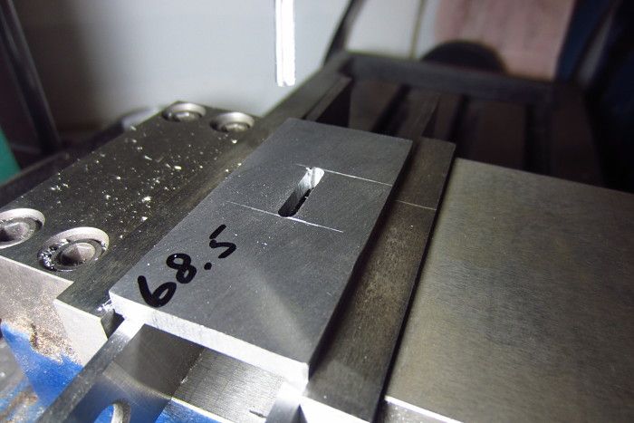

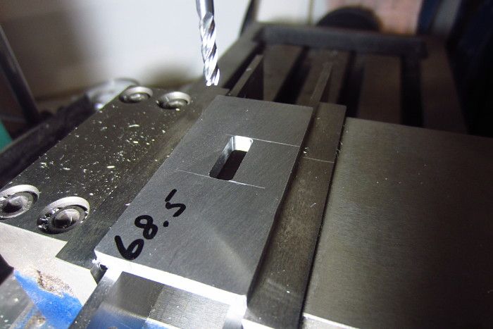

Here, in a piece of 1/4" material, we have a complete slot.
Now, I see that on this one I have marked " 68.5 ".
Here's the secret to that!
My 1/8" end mills measure .123".
I know that that knife ricasso area there was .260." (Forget that previously mentioned .250")
If I cut a slot in a piece of material .123" and NEED a slot .260", then I need to remove .137" MORE. Right?
Right.
But I need to remove 1/2 of that on either side of the center line, or .0685" in one direction, and .0685" in the other direction.

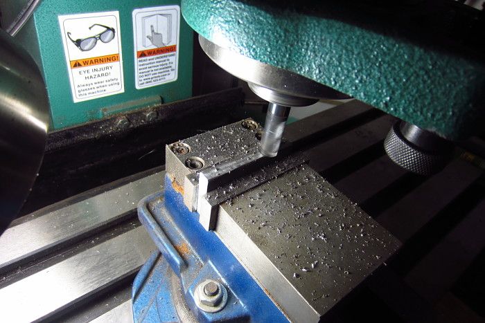

So, I lower the end mill into the slot.
Be sure to LOCK your downward travel of your quill to keep it as solid as possible.
Loosen the Y axis so it can go in and out.
Go all the way to one end until I hit one of the X axis stops and move the table either in or out, depending on what end I start at so I'm always cutting INTO the side, move the table out about 2 1/2 thousandths.
Crank to the other end.
Move the table either in or out the OTHER way and take out 2 1/2 thousandths off the other side of the slot until I hit the X axis stop going the other direction.
Then come out 5 thousandths.
Then 7 1/2 thousandths.
Then 10. Then 12 1/2.
Then 15.
Then 17 1/2.
etc. Back and forth until I hit .685 on either side of ZERO.
Here I am having gone all the way to .685 from zero:

The finished guard:
And walked over and slid onto the knife:
Here is the 1/4 inch slid onto the knife right off the mill:

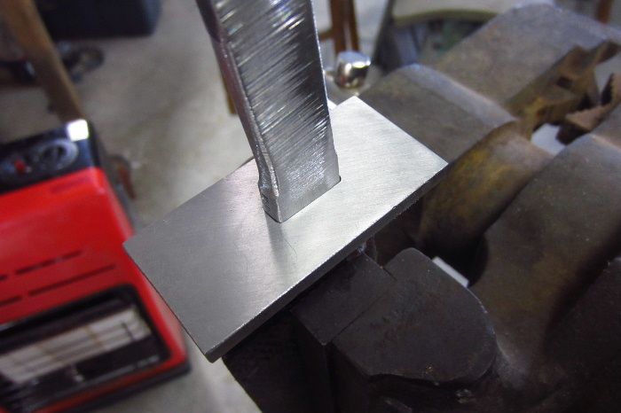

I lock the guard material in a rotatable vise and file the end of the slot to fit the radius:
This is what it looks like from the back side:

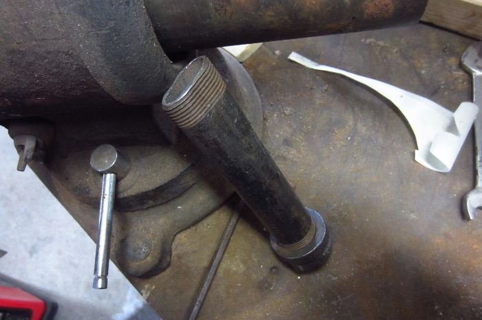

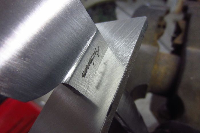

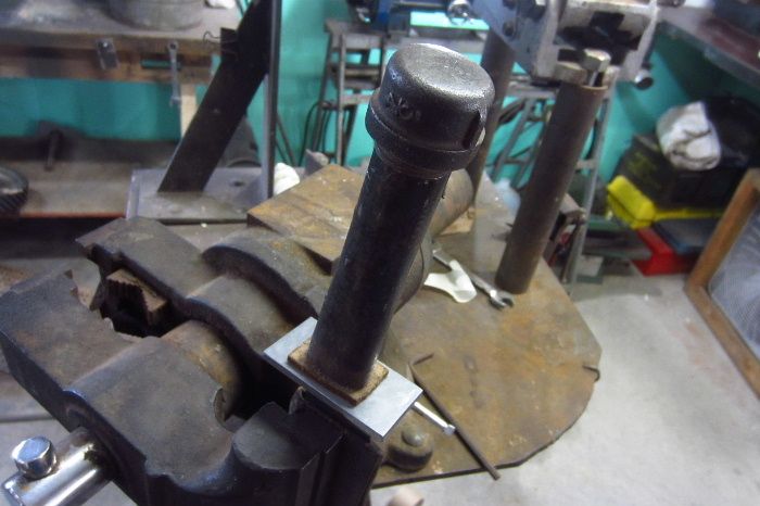

Slide on a piece of leather:
And tap the guard with a flattened pipe nipple:

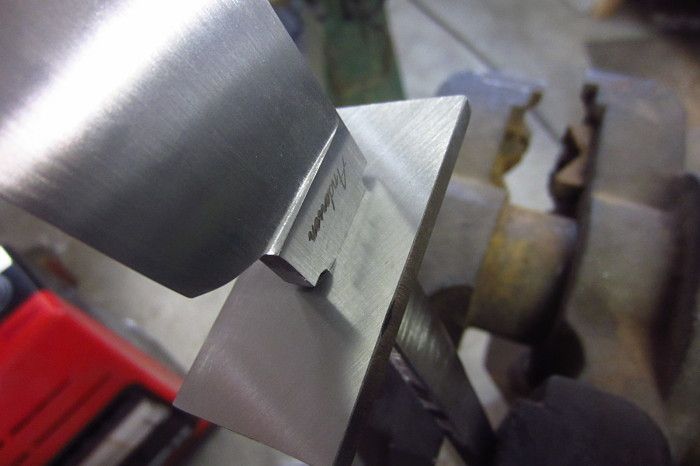

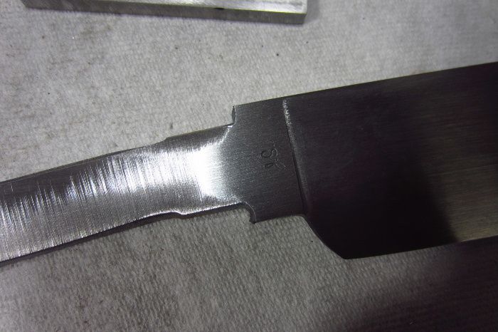

If the guard is too tight, and I'm not dealing with already etched damascus, it will leave slight scratch marks on the ricasso:
They're a little difficult to see but they're the dark marks right behind the shoulders:

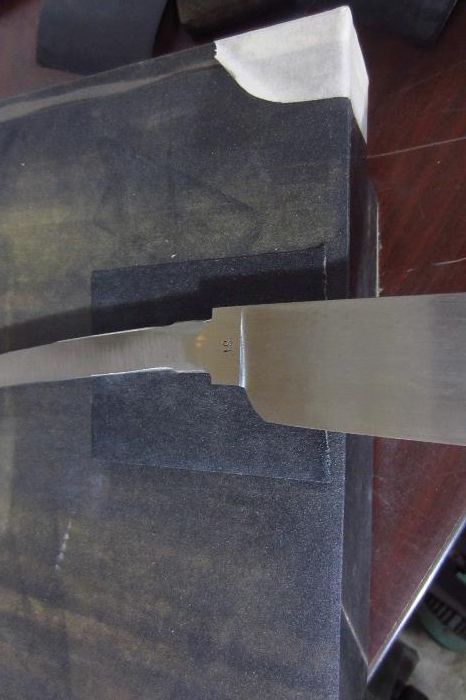

Do NOT!!! do anything to the guard slot!!
Take the knife to the lapping plate and gently sand the marks off!
marks are gone:
Re-try the fit:
Almost!
Little tap with the pipe nipple:
