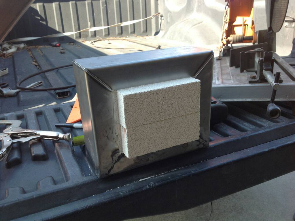

Thought I'd share the build details while I work through this project.

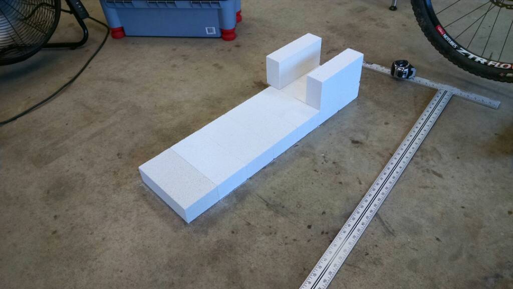

Checking out the K-23 insulating soft fire brick.

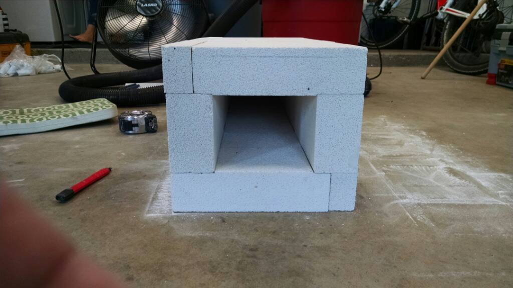

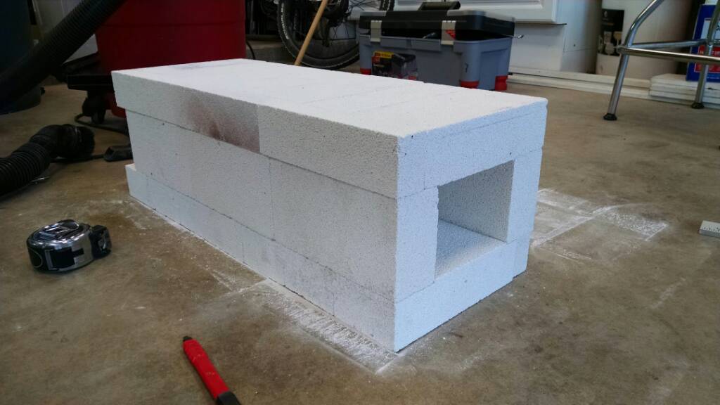

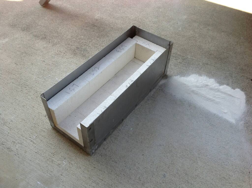

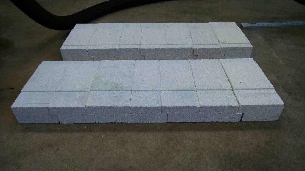

Top and bottom bricks with interlocking joints. Used a tile saw.
Assembled

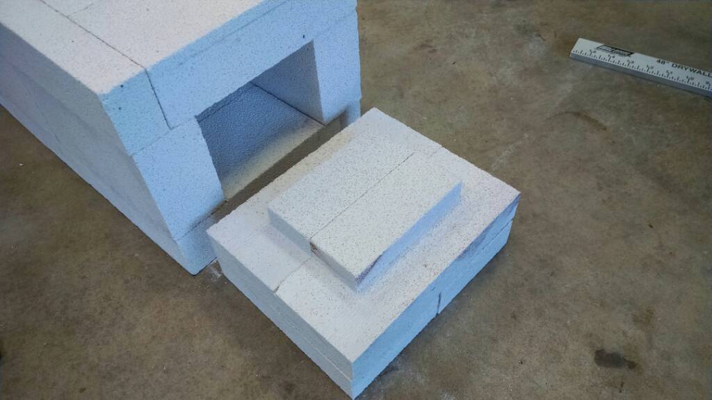

Door bricks fabricated.

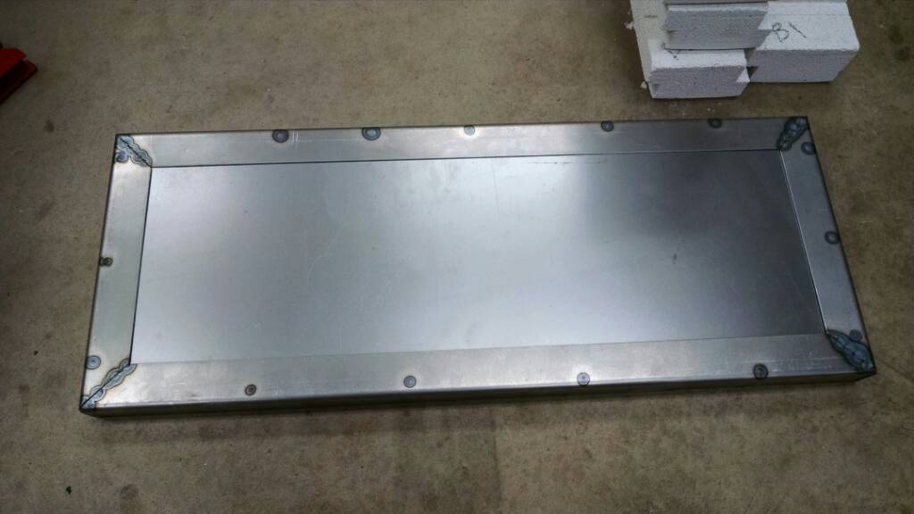

Bottom tray fabricated. Using 16 gauge steel.
Next up will be welding on uprights for the corners and welding in the sheet steel for the sides and back.

Lesson learned #1.. The interlocking joint thing is a bunch of extra work that over complicates things and probably doesn't add much if any value. If I did it over I would simply get some sairset mortar and join the bricks together. I will be using sairset on the bottom and sides when I do final assembly. I will also mortar the top bricks into a single slab but not stick it to the sides. I want the top to be removable in the event I need to service the element.
Be careful with mortar. As it dries it will peel off the bricks. I've heard of people soaking the bricks in water before you mortar them but haven't tried it. Of all the production ovens I've seen. Which isn't a lot, none have mortar. Also, as time goes on you may need to replace one here or there. No mortar allows you to do this. The only ones I interlocked was the top. I did this to keep the side bricks from falling inward. I also staggered mine so that no joints lined up. Anyway, your build is looking good. I can't wait to see the finished product.
As I understand it the sairset mortar is for joints of 1/8" or less.
Tonights progress. Got the lid fabricated.

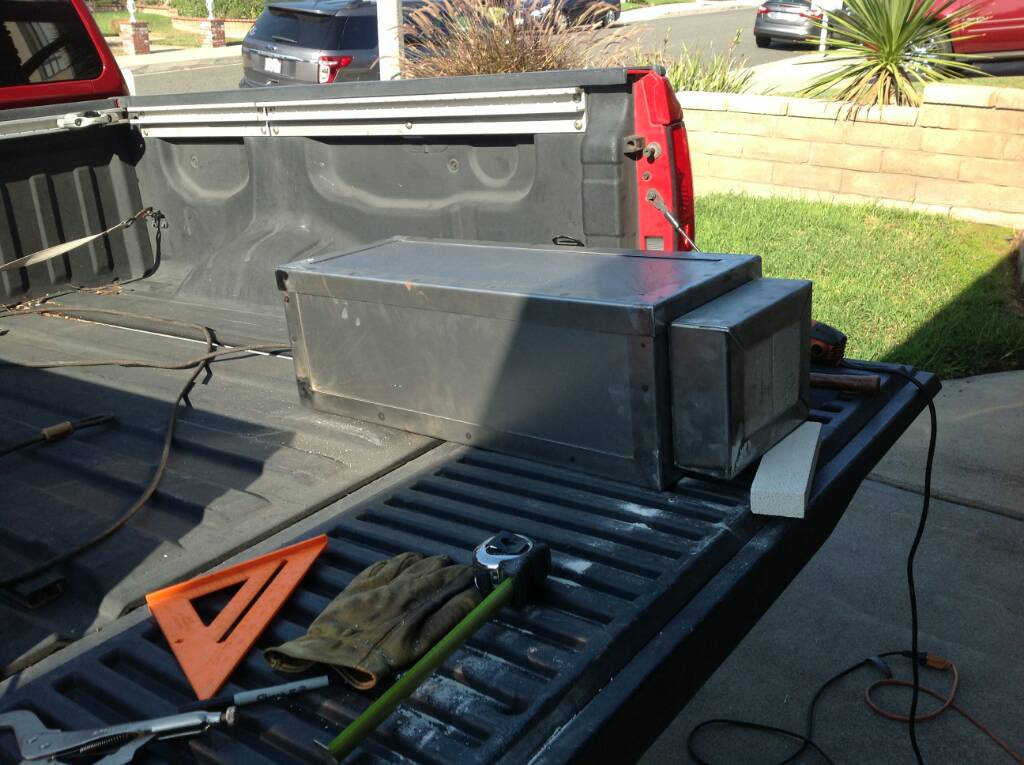

Managed to make some more progress on this project today.
Got the bricks fit nice and snug in the body. Rubbed them on the concrete until they fit in perfectly.

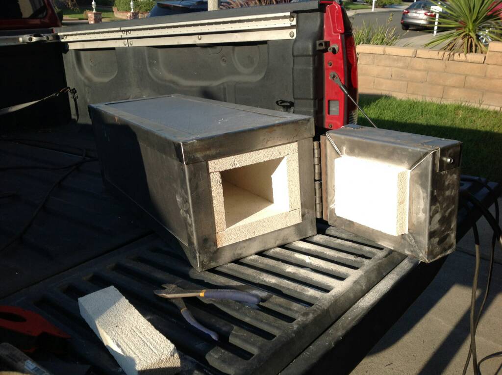

Worked up the door frame. Top of the frame will be removable.
Fit the door brick into the body.
Welded on the hinges.
Door closes nicely.
Next I need to sort out the latch.
Cheers,
Jerid
Very nice build! I built mine and as much of a pain as it was at times, was well worth it, and kind of fun.... cant wait to see the finished project.
Very nice. One thing worth mentioning, air at high temperatures doesn't really convect, so having a gap at the door isn't a big deal.
I can't say I ever heard of this advice for a HT oven ( or any oven). What is the source of this recommendation?
In my understanding, the heating in a HT oven is radiant from both the elements and the refractory.

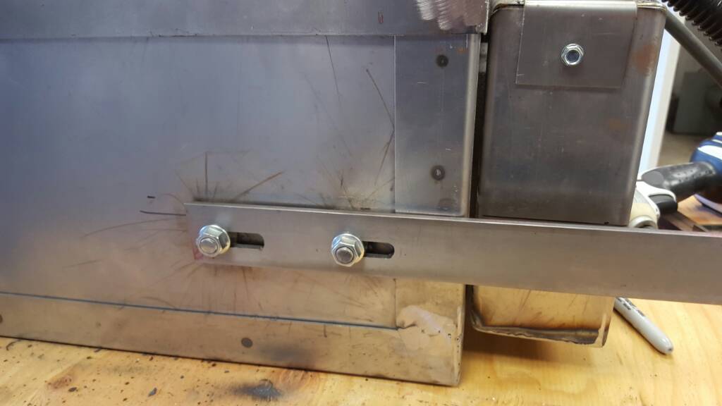

Mounted the fixed side of the door latch. This will be trimmed and notched to mate with the half that mounts to the door. I made it adjustable to control how tight it shuts.
Very nice Jerid, it looks VERY similar to the way I built my oven. I would still think about adding the gasket around your door...
