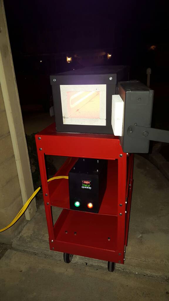

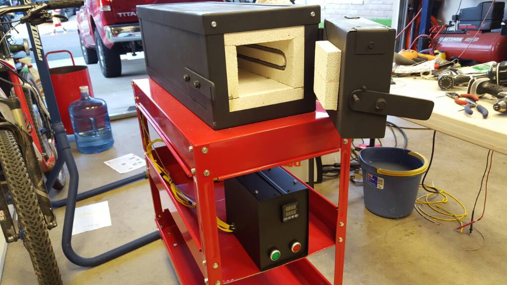

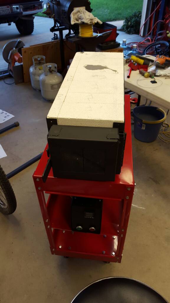

installed the top bricks and the hanger support for the thermocouple.
assembly finished.
fired it up to 1500*
here is a little video of it.
https://youtu.be/TbqvDvsnoO4
still not sure I fully understand the controller. going to need to keep studying and trying things.
the controller wasn't set right so it took a while. it stalled out at about 1470 but I could see the heat cycling on and off and it seemed like it wasn't heating long enough in the cycle to get it to ramp. I ran an auto tune on it and it then continued ramping. I'm still not sure I set it correctly in the end. I'll report back when I'm more confident in what I'm doing.

Nice looking Build Jerid! Where did you get the ceramic insulating blocks and brass connectors from. I have a HT oven that I need to finish building this winter, but still need to gather a few parts.
Is that a Harbor Freight cart the oven is on?
ceramic insulators came from Paragon and include the brass connectors if I recall correctly.
yes, HF cart. not as sturdy as I'd like. probably better off welding up my own.
