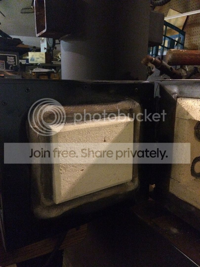

Very nice Jerid, it looks VERY similar to the way I built my oven. I would still think about adding the gasket around your door...
Great job
The protruding door bricks seal pretty nicely into the throat. I imagine over time this will degrade.. I'll definitely be looking at gasket options as I progress.
Here is what I did for my gasket... I cut a frame out of a piece of sheetmetal, the o.d. the same size as the o.d. of the door and the i.d. I made where I wanted the outer most part o the gasket to seal against the brick. I then folded the stitched seam of the gasket under the frame and riveted to the door. It turned out really well.
I just read back through this and I was confused.... so here is a pic! I hope it helps

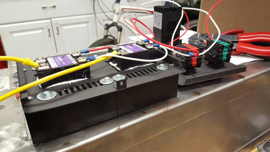

Started working on the electronics..
Not sure I'm happy with the enclosure I selected. Wishing I had more room on the back panel.

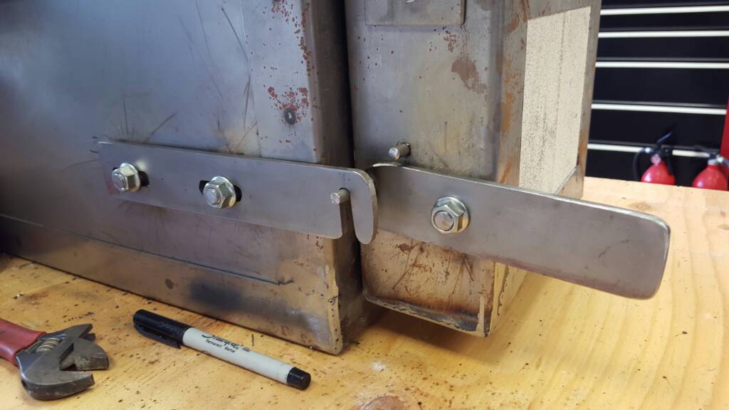

However I did manage to get the door latch completed.

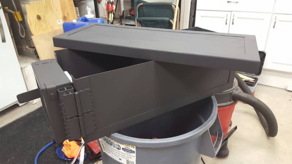

Got the enclosure painted. Used 2000* tolerant paint.

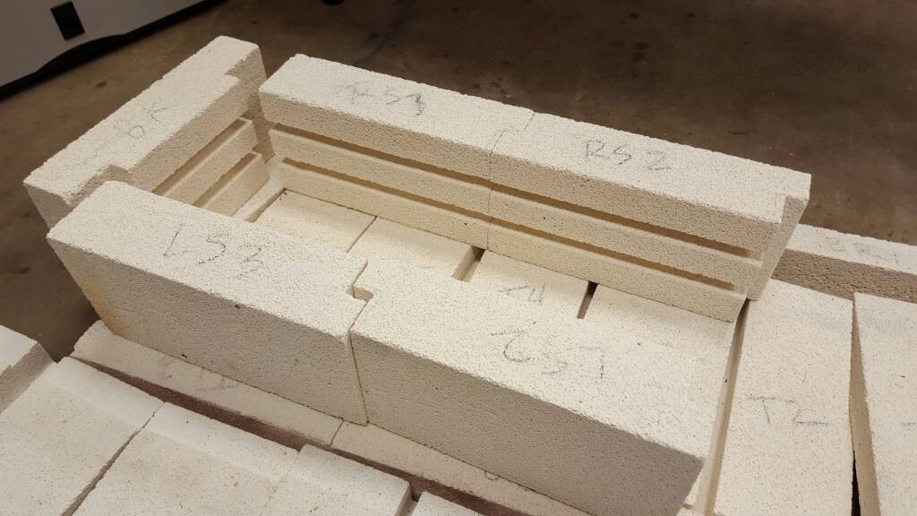

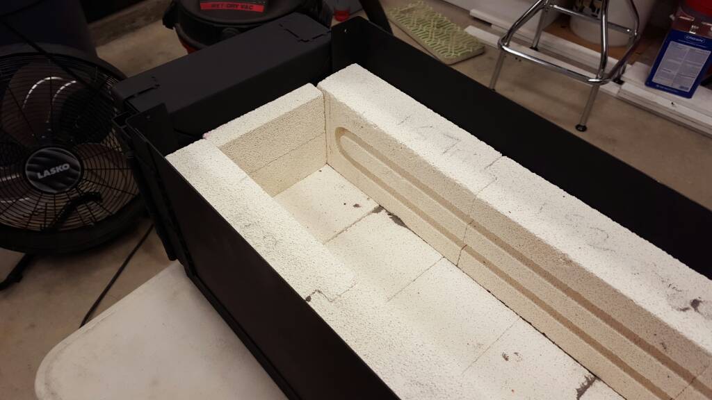

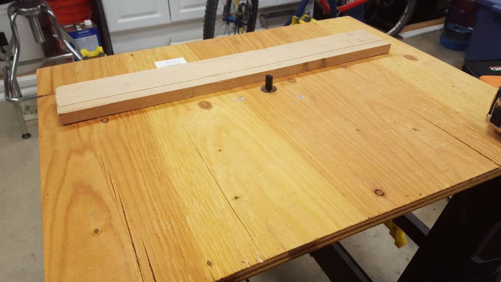

Also built a makeshift router table to cut the channels in the brick to run the heating elements.

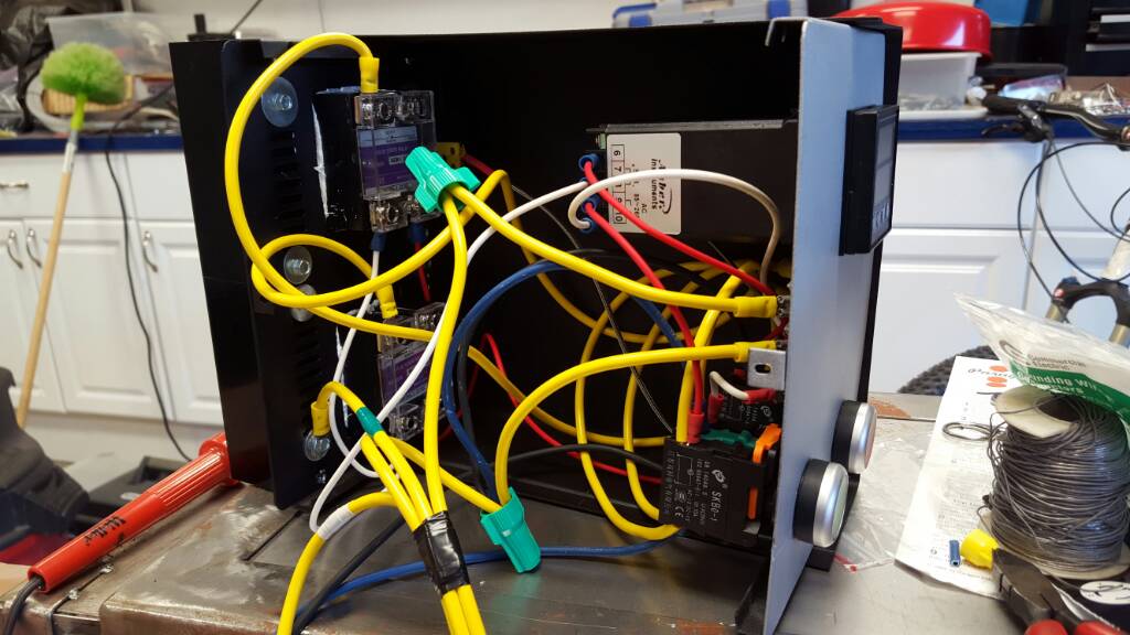

Nice looking setup Jerid. Do you have aluminum heat sinks for those SSRs? I made the mistake of not having them on my first build and started getting random temp overruns that burned up a few blades and a set of coils. It actually could have been worse. When those SSRs over heat, they just stay wide open.

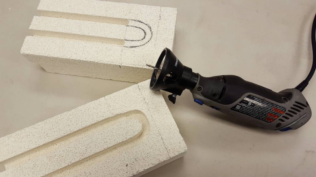

My little router table worked great. Used a 1/2" straight cut bit from harbor freight.
For the ends where it does a return I used my dremmel with a spiral cut bit. It worked surprisingly well too.

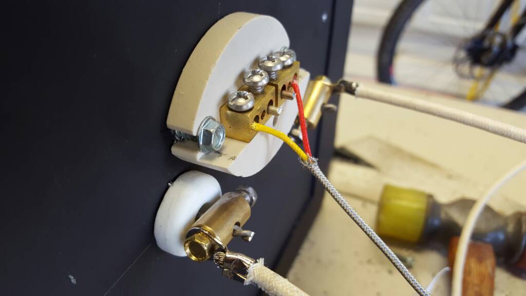

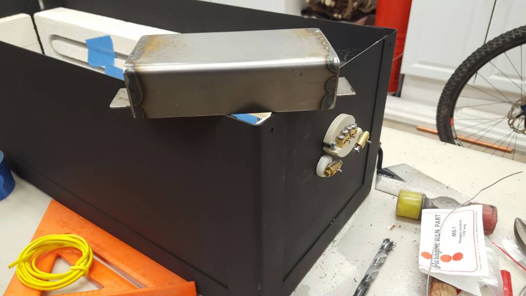

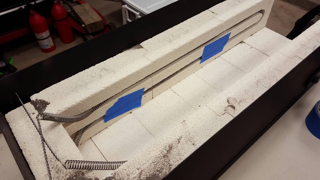

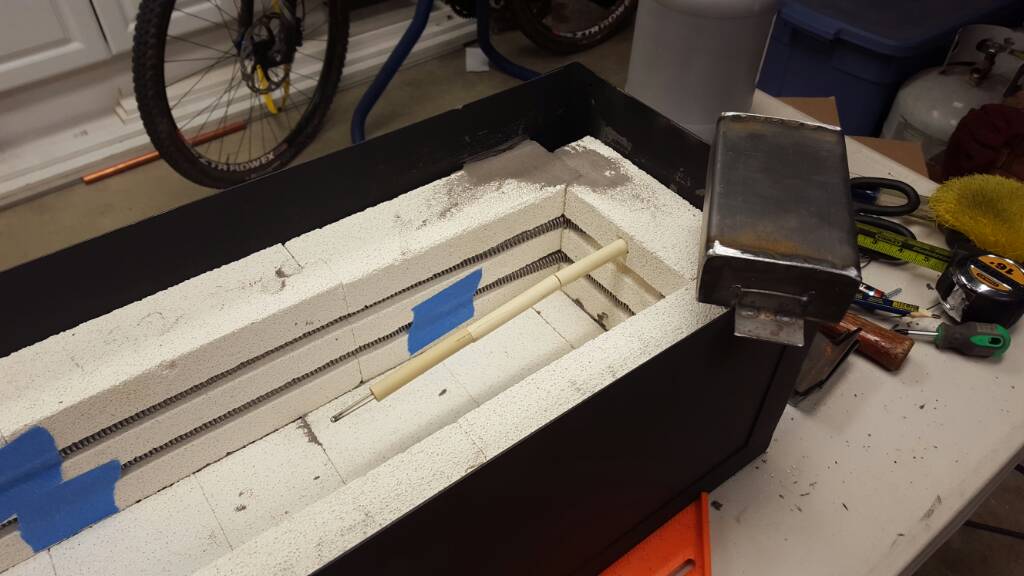

Heating element routed and terminals installed. Still need to put in the staples. Also installed the thermocouple. Fabricated a box to cover the terminals on the back of the oven.
Jerid,
Prevent a problem from happening by putting a long "U" staple as a hanger around the last TC insulator and up through the top brick. Bend the ends over to keep it in place. This will prevent the TC from bending down as it stays hot for an extended time. When installed horizontal like yours they can slowly creep downward.
Where the ends come out in the top brick, make a 1/2" deep groove between the holes. That way the wires end up embedded in the brick about 1/2" when the exposed ends are folded over. Then fill the groove with refractory cement to keep the hot wire from making a hot spot on the oven top.

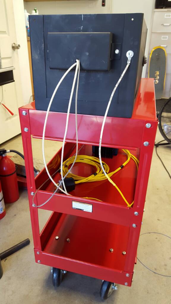

Terminal connections on back oven for elements and thermocouple.
Also look at the back with the wires connected and terminal cover installed.

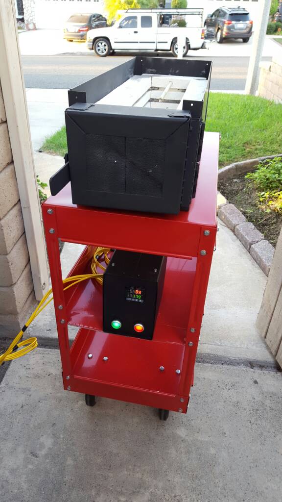

IT'S ALIVE!!! No sparks, smoke, fire or electrocution. I do have a problem with my 110v lighted switches though. They are constantly lit in both the on & off position. I'll need to sort that out.
Now I need to pull the circuit into the garage.
It's also time to read the PID manual for the 6th time so I can learn the programming.
