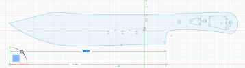

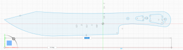

so youre partly responsible for this idear......I sure hope so. Seeing as we spent a bunch of time today devising such a scheme...
I may have brought up wanting to commission something like that picture earlier... David deserves most of the credit though.so youre partly responsible for this idear......
if so, then........well done Anthony.
love the Hudson Bay pattern. got a couple condor versions of it. this looks like its gonna be a bigger one, and that is a great thing......
okay so a well done to both of ya then.....great idear to do a Hudson Bay pattern.I may have brought up wanting to commission something like that picture earlier... David deserves most of the credit though.
I want one......
I'm liking the aebl steel. no one makes a good tough stainless Hudson Bay....This is the sort of thing I am trying to find out. If I do something like this as a one-off, it gets expensive, but the more people in on it, the better price I can make them for. The steel we discussed initially was 15N20. I tried to vouch for AEBL but the Willie was having none of it. I don't blame him. A classic traditional blade style like this, kind seems like it would be wrong to make it in something that doesn't take a patina readily. 3/16" or 1/4" 15N20 would be nice and tough and really perfect for the job. Seems like it should also get wood or micarta for the handle too. If it were to be my knife, I would go with 3/16", maybe even 5/32".
