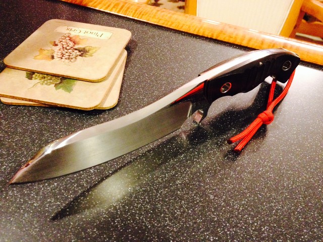

I have a Vox Ripley (Boker version) and it is super thick (7mm) and it has a blunt edge. My guess is maybe 50 or 60 degrees inclusive convexed and it is no longer apexed. It will not cut paper or even a plastic bag. It will, however, chop down a tree almost as easily as my BK-9 that I do keep apexed at 40 degrees inclusive.
I'm still learning but this is my experience out in the field. Knives are complex tools that look so simple.
Eric
- edit -
Sorry I am off topic. Cutting and Chopping are two distinct chores as I have just been informed! I should know the difference by now. Also - here is a picture of my ripley (the Blunt Beast). I'm surprised that it doesn't come up in a google search!
