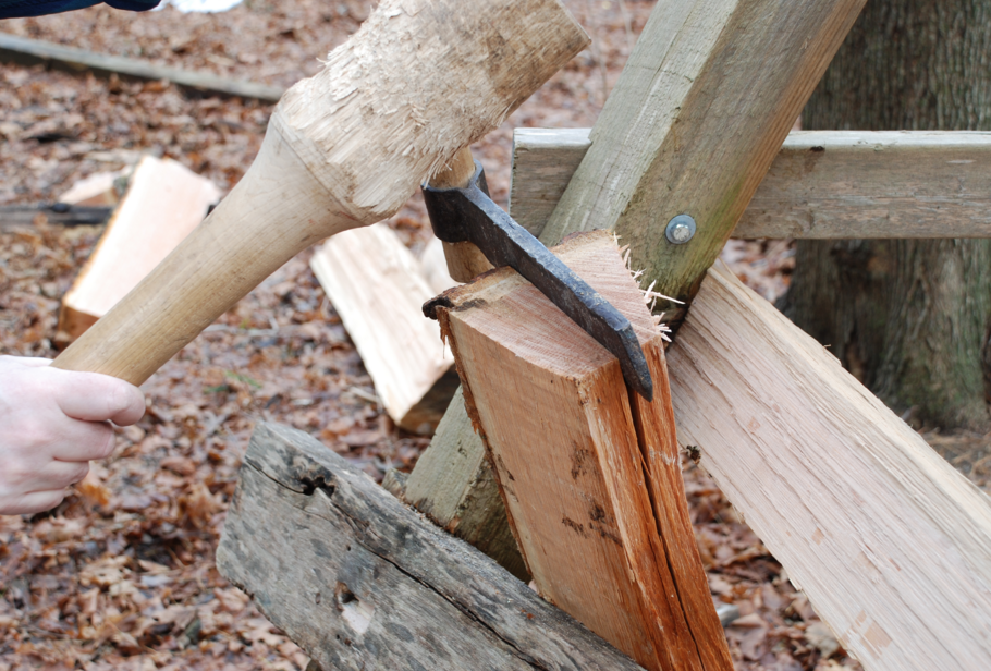

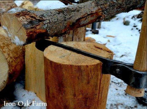

Inquiring Thomas, actually. I hoped there was actually a basis for the statement - however slight. There are, after all, people who study early tool use: "Wood splitting (riving, cleaving) is an ancient technique used in carpentry to make lumber for making wooden objects, some basket weaving, and to make firewood. Unlike wood sawing, the wood is split along the grain using tools such as a hammer and wedges, splitting maul, cleaving axe, side knife, or froe."
Early metal axes had no pole, and an iron eye with a steel blade forge-welded in does not lend itself to much batoning - you end up distorting the eye so the head comes loose.
So was wood mostly split with these axes or, what seems more likely, with froes - a form of knife - and wedges?

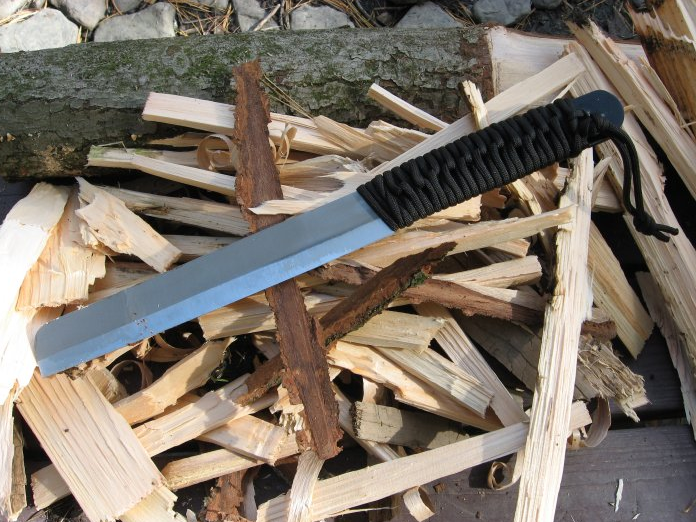

Japanese froe

I don't think there's anything wrong with batoning anymore...so long as one does it with a froe, a tool specifically designed for this purpose. Why don't I see anyone talking about froes? Do what you like with your blades, but I personally will be using an axe or similar tool to split wood.
