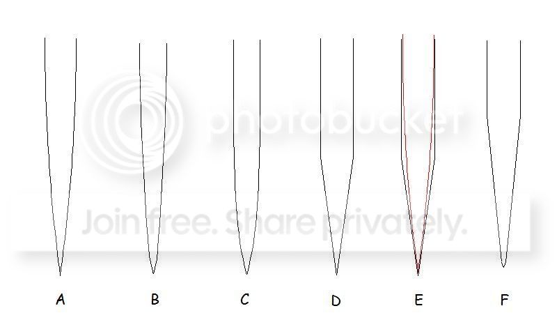

but I believe that a fully convexed profile (A) will outcut the scandigrind (D) on most materials.
B and C are also convex, eventho geometries are quite different.
E shows profile A inside profile D..

So is "F" a saber grind with a convex secondary bevel? (So-called "Scandi" being saber without secondary bevel.)
It's the convexed edge as used by Swamprat and others..
The main grind is flat sabre (if the grind is taken over the half of the blade I call it flat sabre.. above it scandi.. dunno if that's officially correct tho), and only the edge is convexed..
