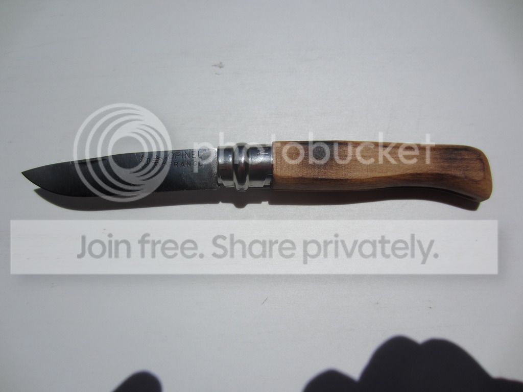

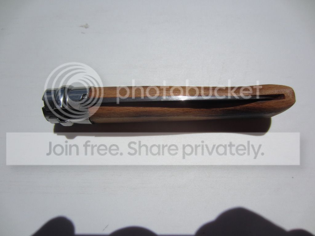

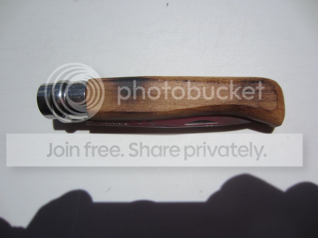

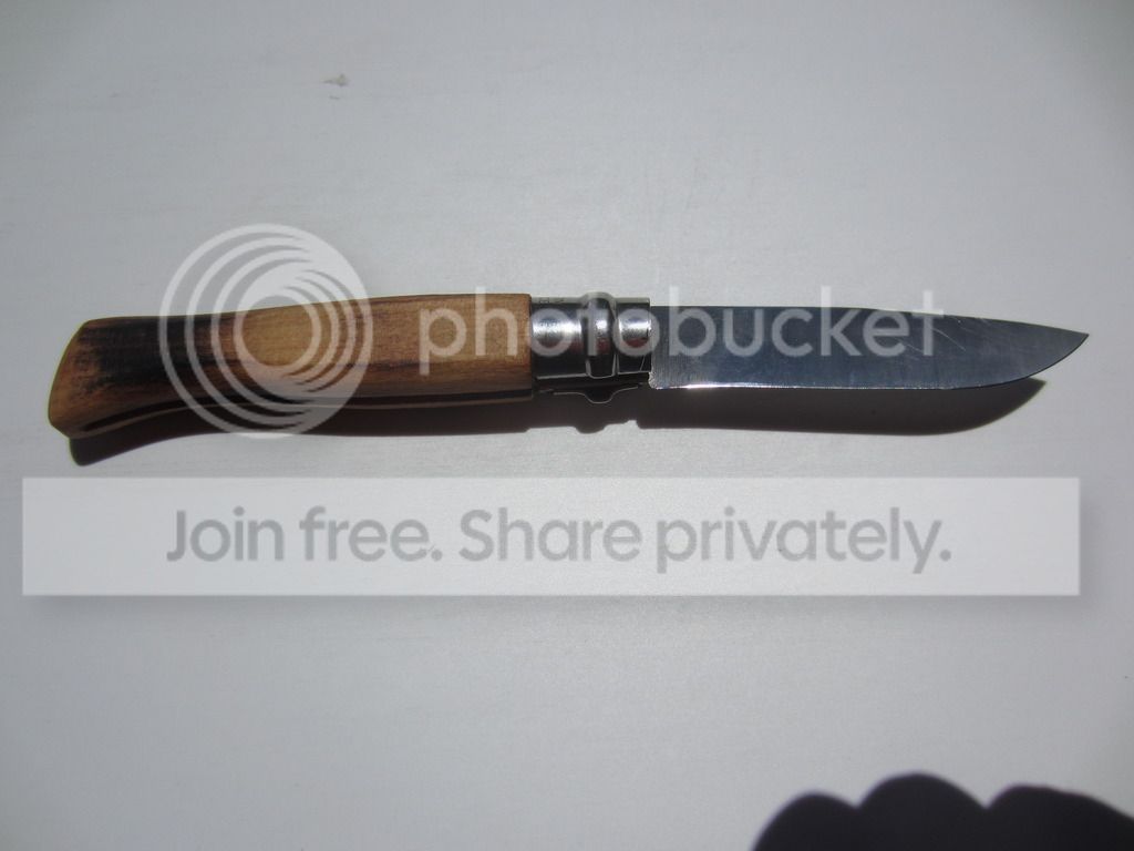

Ok, pictures w/MODS.
Reshape blade to resemble a drop point. Pointed knives tend to bite me.:)
Grind handle to flatten it some, round handles tend to "turn" on me.
Knock off some of the artistic flair of the handle, and ease edges.
"Flame" the wood to make it interesting.
Treat all of the wood to make a little water resistent.
A piece of cork in the blade park, to reduce blade dulling when striking the handle.
