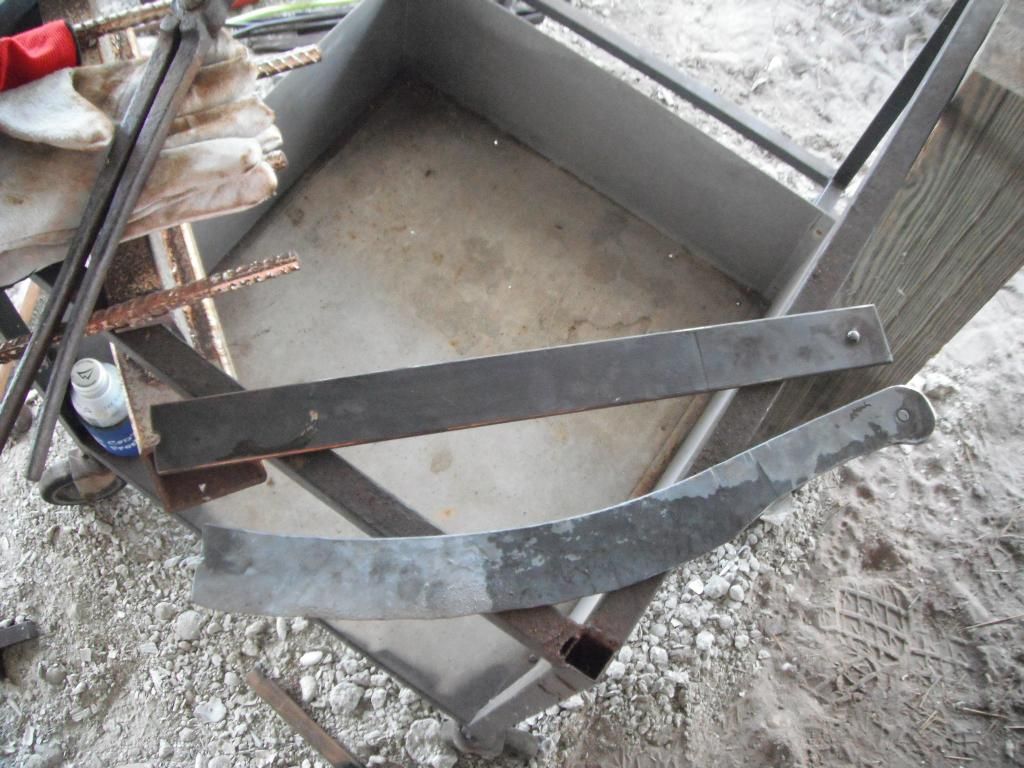

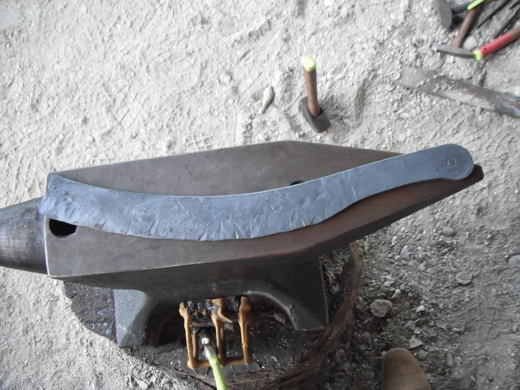

I went over to a friend's house(BF member SinePari) for a little hammer-in today. Had a blast forging out my first blade. I'm hoping to do a little grinding on it later tonight at another friend's house(BF member esnyx). It started life as a leaf spring, assumed to be 5160. I hand forged the edge to shape and then had some help from SinePari with cutting out the handle profile. It's still a bit rough right now but I think it will clean up nicely. I plan to do a convex grind and wood handles.
DSCF6106_zps4a3efc18.jpg~original
On the anvil

Before & after with another piece of leaf spring

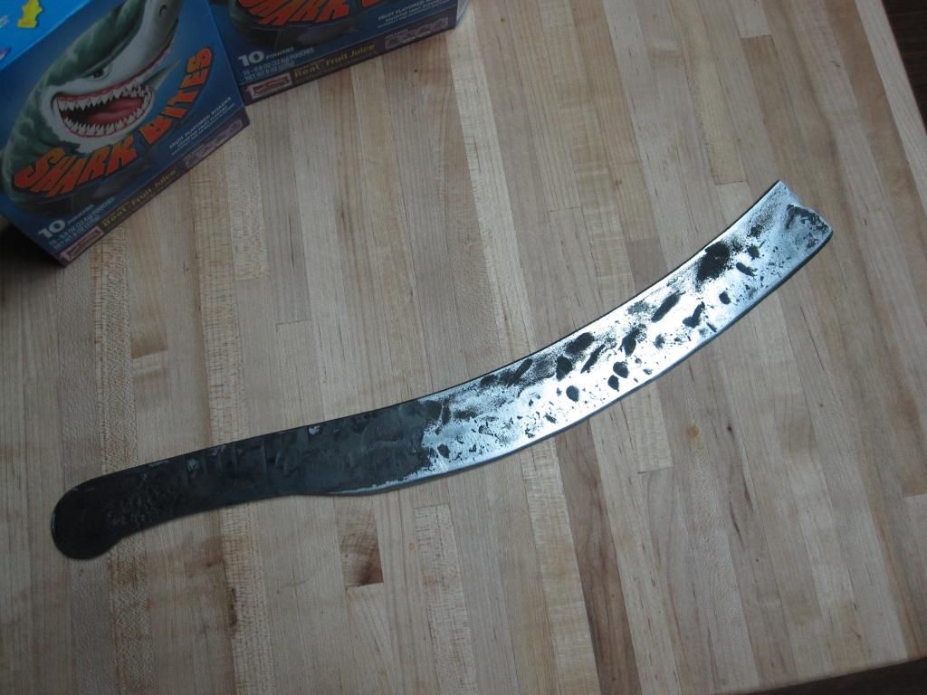

Thanks for the encouragement, everyone. Here is another photo after some preliminary convex grinding, pre-heat treat.
IMG_1957_zpscdf1ebcd.jpg~original
Svashtar, I don't really know enough to fully answer your question. I know we did a triple normalization and quench before putting the preliminary grind on, and then it will go back into the forge and get quenched again in oil, then tempered in the oven (I think). I want to try a differential heat treatment for this one.

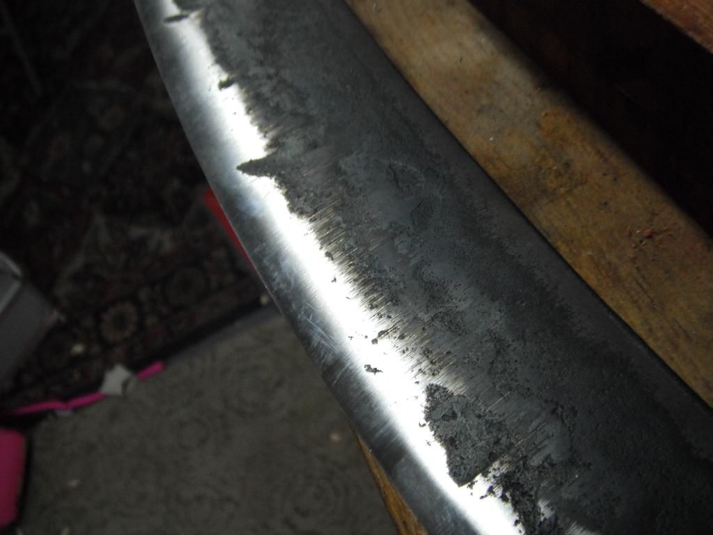

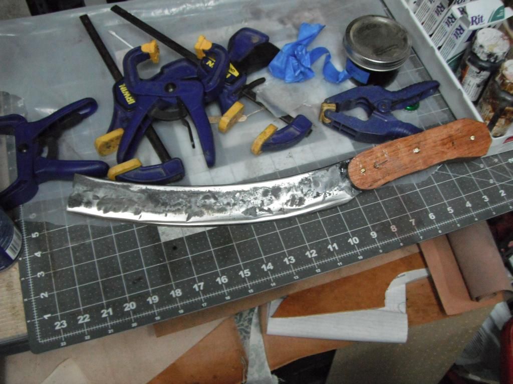

Made lots of progress yesterday! The blade is heat treated (with differential edge quench), convex ground, and sharpened. The Brazilian Cherry handle slabs are epoxied on and curing. Only thing left to do is to shape the handle!
We tested it out and it chops like a beast, with no chipping or rolling to the edge!
DSCF6501_zpsb56608b7.jpg~original
DSCF6484_zpsc9a5d11d.jpg~original
Thanks, J. I am amazed by the chopping power of this thing. I can't wait to finish it up!!!
