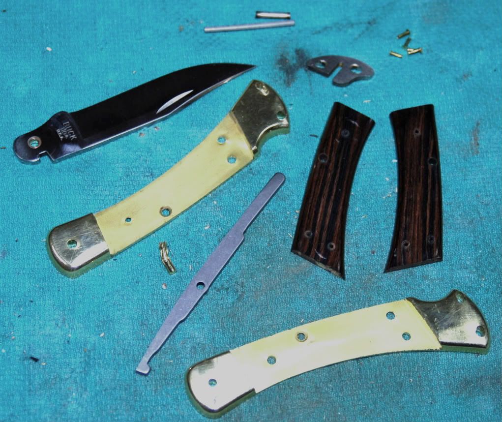

Here you go JB. Note the ugly holes in rear bolsters and spacer.
ooops.... are they too deep to sand out? The scales don't look like they were epoxied down, and this was a 2008, 110, right? Were you using a pin punch and hammer or an arbor press to disassemble?
Here's an idea... maybe not a good one, but..... The Micarta you have, Green/Brown, would look nice if you get some contour to it. The layers show up nice with some contour rather than flat. If you have to do a lot of sanding on the bolsters, to remove the nicks, you might contour the bolster up to the Micarta and back down to the front bolster.... does that make sense? Might look cool....might not....my beers empty....later...
Contouring micarta makes it look alot better. Buck did use ebony on their 110's for 30yrs.. DM

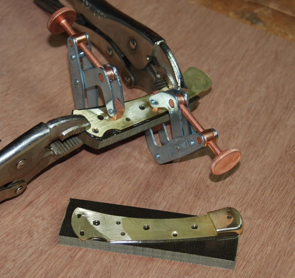

Interesting problem there Gordon. Here is an idea for a fix...what do you think?
Remove the rear bolster
jb4570
An arbor press from Harbor Freight would have eliminated that (and set you back ~$48 :D )...but for the scale rivets, you don't have to drill them all the way through...just drill the peened portion off [the inner part of the rivet], and they will push right out...without harming the scales...
I like that wood you used...nice and dense; no streaking... :)
I like it. That design is called boarshead something like that. That is a fairly easy thing with the Cootes. I am worried about strength of the liner/bolster with enlarged holes. I'll think about it this morning...but I'm leaning towards it with the Micarta.

Yeap...I think a press arbor is in my future. How about telling me about arbor punches and dies etc. I assume the press comes with a very basic assortment of punches..like three. After that, where is the best place to get them. Also, what like press, a 1 ton or larger?
That Cocobolo is nice wood. Credit Pack Rat with the Tru-Oil idea:thumbup: it really brought out the rich color of the wood.
Doesn't come with *any* punches/dies... :D
I use cut down needle scaler needles...They're .120" dia...but drill rod will do...I think DarrellS uses old nails... :p
Drill a hole in a piece of 1/4" x whatever scrap steel strap for your die...locate your pins by the "Houser jeans rub" and make a pinprick in the center...position your punch over the pin and the steel strap/hole under it...punch it out! :cool::thumbup:
One ton press minimum. Anything smaller won't cut it. The bolster holes will measure ~.130" after punching the old pins out, but when you crush the new .125" pins in, they'll expand nicely...just leave 1/16" sticking out each side (make the pins 1/8" overlength)...file/sand/buff...Viola! (that's French)... :)
Jantz and Texas Knife both have brass and nickel silver 1/8" rod suitable for making your new pins...

I decided to go with JB's suggestion on taking off the rear bolster. Here's were I'm at. Both sides are grounded and glued. I'm going to let them sit a bit while I feed my little buddies and have some supper myself. Then the profiling, pinning and contouring begins. I'm going to do palm swells to highlight the micarta.
