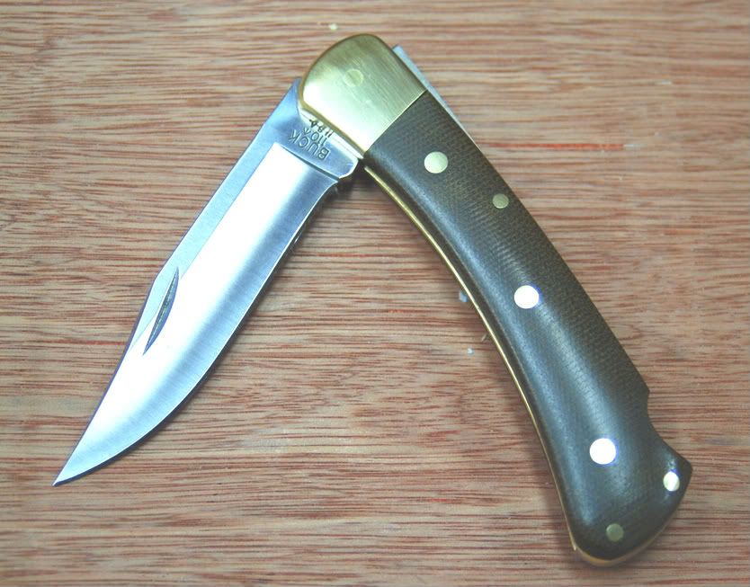

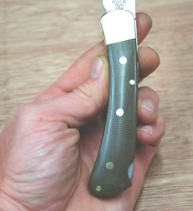

I've got the knife back together. It has a couple of a major faults and couple other small issues. But it locks up tight, no blade wiggle...so I'm calling it an OK result. Probably need to buff up the scale some more but here it is as of now.
That looks very nice to me. I did not inherit my father's shop gene so my hat it off to you for being able to do that.

well i for one do not see any issue with your buck!!!
looking good to me!!!
you were braver then i to take it apart and work on it.
fact is ... well i am thinking of trying it now because of your work!!
i am harder on my work then others..we all are..
i was told it is the craftsman in us coming out..
i think some one should start a "buck work" tinkering thread
and make it a sticky ...
might inspire more to make their buck there own way!

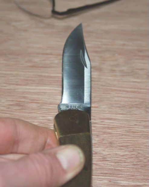

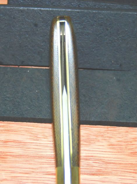

Thanks for the positive feedback. But I went back out to the shop and took some add'l pics to highlight the problem/fault. Its not something that effects functionablity but its not something acceptable. I guess the good news is I know percisely how I got it this way and it shouldn't happen again. I still like the knife...its been bobbing around in my pocket all afternoon.
Note the blade angle and rocker protrusion
I really like the way those scales came out, nice work. What caused the issue with the rocker and blade (asking in case I ever have opportunity to mod one)?
Mike,
When I decided to take the knife apart I made the impatient decision to drill the three bolster pins because my pin punch bent and blah, blah, blah. To make matters worse, I used what I thought was a 1/8 bit. Turned out to be a 9/64th. Since I had the bushing/blade pin punched about an 1/8 out, the drilling only slighted nicked the bushing (I'll skip the breakdown on the two back pins). Plus, the bit ran off at a slight angle.
So now I've got an enlarged hole in the bolster and its slightly off center and tilting slightly. Ditto for the blade bushing. So I thought about my options out of this mess. First was what I did which was try to redrill with a 5/32 hole in the bolster and bushing. Didn't work because I was unable to take the off center/tilt problem out of either. The combined creep on the bolster and bushing resulted in the blade being positioned as you see it. I was again impatient and went ahead instead ordering a new bushing (option 2) and waiting.
What I should have done was ordered a replacement bushing from the knife maker supply guys I use and tried to redrill the bolster at a 1/4 and plug/peen the new larger hole. Now, I probably could drill the 1/8th hole correctly centered.
If I decide to take another of my 110/112s apart I will get/find the use of an Arbor press for controlled pushing. The pin holes are OK, bushing is OK, and all the holes stay square.
I think you can do a barehead without taking the knife apart and that's the way I'm going if I get all torqued up and try another one.
The whole thing blew up in my face due to impatience and doing something I'd never done before. In the end, I turned a brand new knife that worked perfectly into something interesting looking but with issues.
All that said I had fun and learned some does and don'ts and ended up with a different and interesting looking 110 that still does everthing its supposed too. It's just a little cockeyed. ;)
