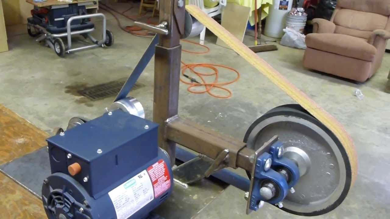

I dont remember where I saw it but another guys design didn't have that second arm on the top. Made it look extremely simplistic compared to most designs, but still very sturdy and durable.. Know anything about that?
This may have been it
I also have a question on how the wheels are attached? Especially the drive wheel?
The drive wheel is just a solid aluminum rod with a 5/8" (or 3/4") diameter hole for the shaft to slide thru. There are set screws that allow the wheel to be tighten to shaft to prevent slipping. Most drive wheels also have a keyway to match keyway in shaft.
That grinder shown is using a Grizzly 10" contact wheel, and a solid shaft bolted solid to wheel and using pillow bearings to support. From the position of motor, it looks like it's using a belt assembly driving a shaft to pillow bearings also. That's how I did my first grinder, but I MUCH prefer the 56C motor mount for direct mounting with drive wheel mounted to motor shaft. google 56C motor mounting and you'll see a lot of info there.

Thanks yes I will be going with a direct drive also. But this frame design is what I'm going for. I hope to be purchasing the motor and vfd within the next week or so.
I believe the maker of that particular grinder put a heavy compression spring in the bottom of that socket so that it pushes the tracking arm straight up and gives the required tension. As for the drive wheel, it appears that he used a set up similar to the KMG: a short shaft with the drive wheel on one end, some pillow block bearings, and then a step pulley. If you're going with a VFD, then just mount your drive wheel directly to the motor shaft.
The tracking wheel is probably just bolted to that pivoting flange (or he may have welded some all thread to the flange).
The contact wheel is a grizzly knife grinder wheel, so it doesn't have bearings, just a through hole. Because of that, it appears he used an appropriately sized bolt and just ran it through some pillow blocks. Another option would have been to bore it out for some sealed bearings.
However you mount your wheels, make sure you use some bushings and not just flat washers so that when you tighten your nuts your not compressing the sides of the bearings and their seals. The bushings will put the force on the inner races instead.
