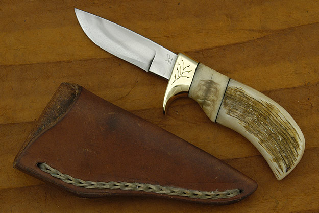

This is one of the 52100 blades I made to test and while grinding I noticed what I thought was a hardening line, so I thought "Cool!" and etched it overnight in vinegar.
I cleaned it up under running water with 4x0 steel wool and it revealed something that I think is weird. Three distinct bands, the upper, softer band and the middle band which I thought would be the hardened martensite but there is a third band at the edge that is dark but has light splotches in it.
In thinking about it, I would have to assume that this band at the edge is probably a result of overheating. This blade has only been snap tempered; I put a bit of oil on the blade and a few drops of water and hold in front of the forge, tang first, until the water starts boiling and after another second or two I quench it.
Any comments?
Without watching your work from the first, it is difficult to say what we see.
I would sharpen the edge and test for edge flex. If it chips I would temper a little higher. If it does not chip I would test it for cut on hemp rope or what ever testing medium you have, cut until the edge is dull. Compare cutting your results with a comparison knife and write down the results.
That does appear to be a transition zone in the center of the blade, but like I said would have to know more to be sure. You can put the blade in a vice, flex it until it breaks and if there is a cone of fine grained steel inside of the blade in the area of what appears to be a transition zone you may have done well.
Use a jig and a torque wrench on the blade while flexing the blade just to have an index of strength of the blade for future reference.
Take complete notes and just maybe they will be of value in the future.

In your test blade, has it been quenched. I am assuming it was since you felt it was a transition line you had seen when grinding. What I see in your blade is an uneven grain pattern probably from over heating (as you mentioned) and uneven or incomplete thermocylcles. Then your edge does not seem to be even either so I would think your forging temps were way too high for this steel. It is easy to do with 52100 and as Ed pointed out you have no second chances with this steel. It needs to be forged at the lower end of the range in order to get better results. Now this is what I see and I will bow to those who have worked this steel much more if they have a better prospective.
Good luck
Thanks for the info Ed.
I will put the blade through at least another proper temper cycle before I do anything else with it.
When I hardened the blade, I used a magnet and checked often for non-magnetic and once there, I continued to heat until the non-magnetic area grew about another 1/2" or so up the width of the blade for 3 times.
