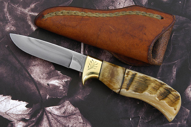

This is the final destructive test of the seminar test blade. As usual with every destructive test we gained more knowledge.
This is a photo of our last 5160 test blade. You can see the transition zones in the side of the blade. Looking into the fracture or "tear" as Rex calls it you can see that the transition zones are not limited to the surface, but mirror the internal micro structure of the blade. This Blade gave up on the 4th 180 flex, it tore in three stages, first along the edge, then to the transition zone, then up to the soft back, then tore parallel to the spine. The blade could have been straightened and used as a knife. If you were at Blade Show West the blade was there for inspection.
This is a photo of our flex testing setup, the vice, smooth jaws and torque wrench jig. The smooth plates are to reduce the sharp jaws of the vice from creating stress raisers in the blade during multiple flexes.

Thanks for posting the 5160 destruct test photos. I see where you clamp the torque wrench jig behind the ricasso, but how do you decide where to clamp along the blade in the vise?
Whose thumbs with the ever ready duct-tape-aids?!
All the best, Phil
The blade was about 5 inches long, using what I call the modified Price grind we need to set the blade deep enough that it won't fly out due to the geometry of the blade during testing. 90 foot pounds of torque is a lot and safety is a main consideration. Before this part of the testing the tip was driven into old hard bone, engraved mild steel and did not deform.
The taped up thumbs belong to Harold Locke a student from California who attended our last seminar. He got a little close to the 2 x 72 inch grinding belts sometimes, in spite of sore thumbs he practiced grinding blades for 7 days and left with some nice blades.
Harold is very strong and each time he heard a snap, he stopped increasing the torque and we examined the blade. We have destroyed many blades this way, but this is the first time we noted the blade tearing in separate stages. We had previously failed to observe the obvious.
The blade returned to withing 20 degrees of straight each flex, after the hardened portions tore, it remained bent at 90 degrees as the soft back had little spring to it.
It is important to note the tear turning parallel to the blade spine, it can still be straightened and used as a knife.
The modified Price grind allows the blade smith to dictate where in the blade the flex will occur. On this blade I ground the thinnest area just in front of the ricasso. I could have just as easily set the flex point further ahead.
Each blade has its own little variables to be considered thus allowing the opportunity for learning a little more with each blade destroyed.
I am not sure what you are reffering to. If it is the zones on the blade in the picture I posted then on what information are you basing this statement?
