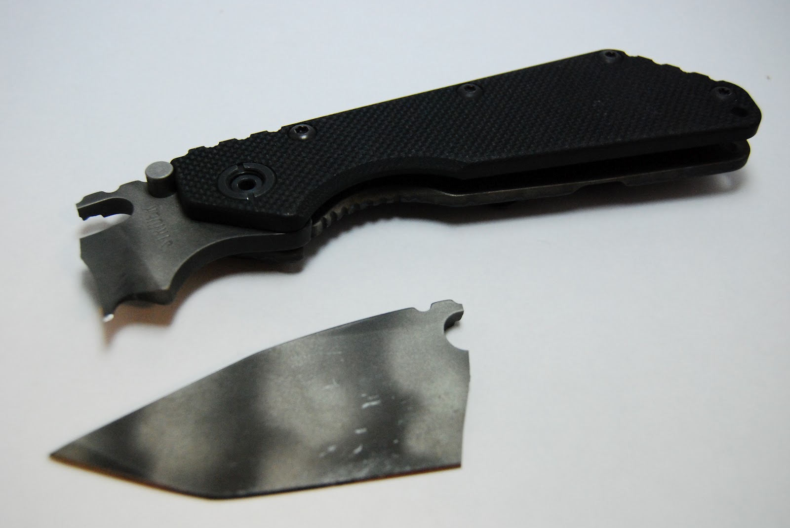

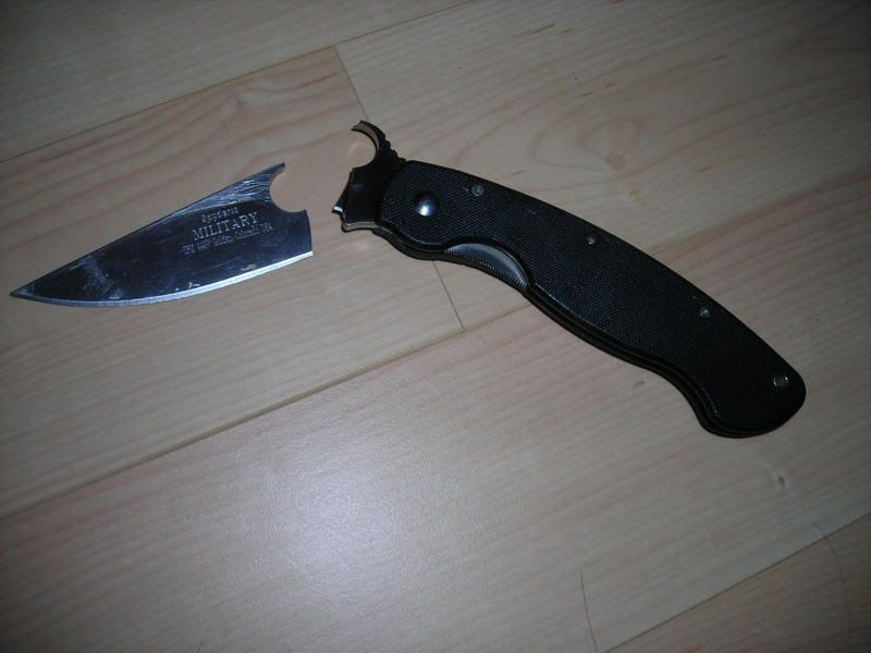

How cool would it be if we had a non sekeletonized blade and a skeletonized blade and then added a handle to test the breakage point. It would be an interesting case study. I don't have knife making equipment or I would do it just for fun.
The spiderco sort of surprises me. I feel like the epoxy should have been strong enough for the handle to at least break where the metal broke and not separate from the blade that easily.
