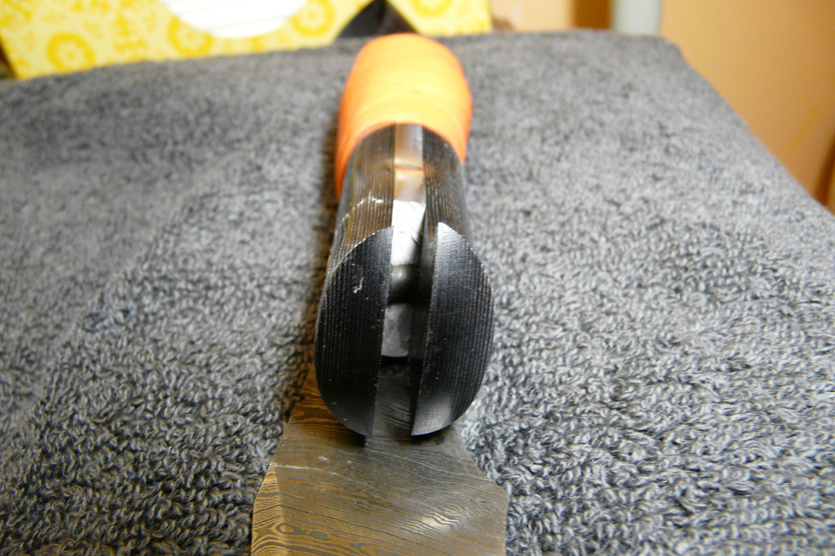

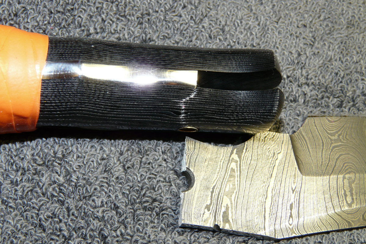

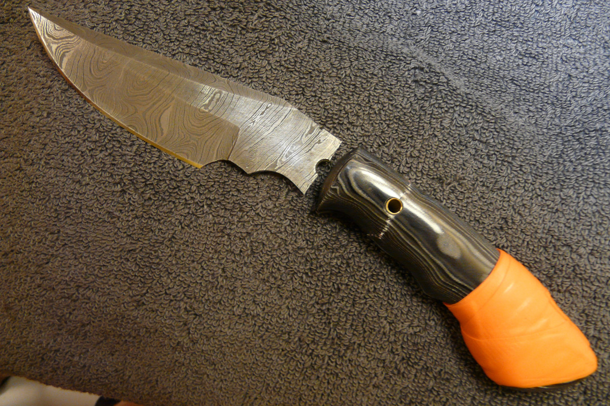

:oops: Here's a pretty nice little knife I broke being stupid . Lateral pressure caused fracture at hole . Note damage to Micarta scale .
Yikes! Hey better to break it just messing around than in the field right =) I really want to do destruction tests on all my knives but I just can't afford it.
Ouch Doc. I'd say that illustrates my earlier point quite well. The pin and scale really did nothing to add strength there. When the steel gave way they went right with it. It doesn't look like the orientation of that pattern weld helped matters either, I'd say.
The problem is more where the holes are located. A simple pin hole for fastening the guard can be quite the stress riser : the transition from blade to handle is where the most stress occurs. Add a hole there and breakage becomes a possibility. And that's why some stick tang knives are way more resistant than some full tang knives : the stress is distributed evenly from the blade to the handle (no holes or sharp corners anywhere). The handle may get some damage, or the ferrule, but the knife as functional unit survives. Some full tang "strong as a beast" knives could very well simply break apart in the same situation if they have a misplaced hole.
