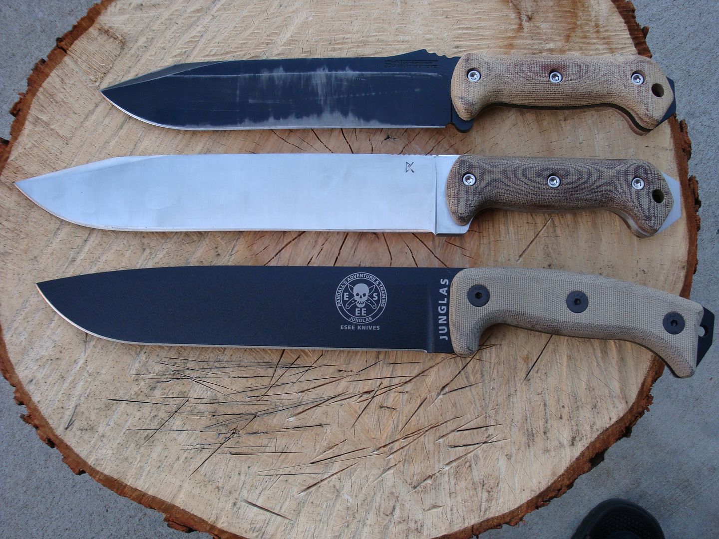

You could always have one made. Had this monster made out of 1/4" thick 5160 steel. Makes the Camillus BK9 (top) and the Junglas (bottom)look small :D
a true 1/4 BK9 would be heaver than even the Camillus, at what benefit? what is that thickness and weight giving you?
plus they'd probably have to tweak the design for balance issues
oh, and it would cost a LOT more. thick stock is harder to work, and just plain costs for material.
would you pay 50% more?
3/16" now and going to 4/16" (1/4") would not cost 50% more. Not even close. They could make a special run and test the market. The Cold Steel 5/16 thick blade is a killer, but I would be happy with just a 1/4" like the BK2.
+1. If you want a thicker blade, you could always have one made for you.
This here is .28 thick, with a 14.25 inch blade.
