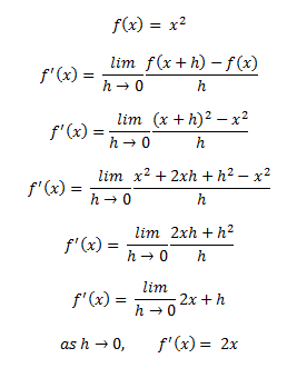

(chiral proceeds to steel images from the web)
The definition of a derivative:
The notation "Lim" over "h -> 0" indicates that the output value is derived via approximation. Why the need to approximate? Because at h=0, you have division by zero. Approximating to avoid division by zero is part of the definition. That isn't controversial, is it?
EDIT to add:
Again, the equation to derive the tangent of a curve:
What is delta-X? It is some (measurable, value-associated, direct) distance between 2 points. A line is defined by two points. If delta-x is zero, then there is not two points, there is only one point which is not enough to define a line and the equation ends up with division by zero. Delta-X cannot be zero, it can only approximate it.
Further Edit: an approximation is a description, and "tangent" describes (via approximation) the changing slope of a curve, but it does so conceptually as applied to a single dimensionless point which is not relevant, and the line it generates eliminates the ability to describe the corresponding curve as "convex".
We wish to describe the "terminal angle" of a "convex" bevel. What is a bevel? A sloping surface, a line, a measurable, value associated distance between two points, i.e. delta-X. Well, how short do you want that distance (length) to be? As short as possible? Alright, I'll give you an approximation by taking the limit as delta-X approaches zero... but i cannot ever reach zero, or the line disappears. Ever notice that "approximate" and "approach" have the same etymological root? :cool: Is the word "approach" used in defining anything in mathematics that might apply to derivatives, e.g. "limits"?

The problem with using the definition of derivative in this manner is that you are evaluating an equation by its denominator, without taking the numerator into account. Rather than trying to describe this to you, I'm including a picture walking through this process. Here you can see inputting an actual function into the definition of a derivative to solve for the particular function's derivative.
You'll notice that I never had to measure h, and there is a clearly defined function describing the tangent slope. No guesswork, no approximation :)
What does the solution to the equation say? In the answer, it still states "as h -> 0 ..." What does that mean? What does the notation 'lim' over 'h->0' mean? To understand the definition, you must understand the meaning of its constituent parts. The limit notation quite literally describes a process of approximation - a value is being approached, but not reached - and WITHOUT the limit notation, the solution is impossible as it requires division by 0. The solution describes the slope of a tangent by approximating a value - that is what "as h -> 0" means. It is telling you, "This is what the slope of the tangent line would be if a single-point could define a line... which it cannot." *shrug* The tangent is conceptual.
As for the "guesswork", that comes in when you are generating an equation to fit the curvature in order to generate a "clearly defined function" to give you the slope of the tangent. In your example, you assumed a known f(x), namely x^2. Try again without f(x)=x^2. If you don't have that initial equation, you BEGIN with guesswork in creating a best-fit equation for the curve (not a simple task, but required if you expect to make formal adjustments to your derivative by substituting the equation of the line into the numerator) before proceeding to approximate a value based upon it (the derivative itself). It is impossible to solve the derivative without the curve's equation... and the result is STILL only an approximation that is neither relevant (since it applies to a single point not a bevel) nor applicable (since the curve is not "convex" relative to the tangent). Wrong method.
