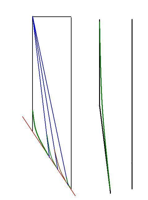

Ugghhh, this thread took a turn to the ridiculous when I realized what you are really proposing behind the math. Is a pointless exercise...
"A V bevel will be thinner behind the edge than a convex, when the convex terminates at the cutting edge at some angle greater than the V bevel, by several degrees at least, but which needn't be specified because it cannot be accurately determined anyway."
Is that about right?
This explains why my earlier diagram and the most recent one sit unreferenced while you go on about what qualifies as a convex arc and to what.
In that case I agree with you 100%. Is unfortunate that statement is meaningless to what is possible when shaping steel in the real world.
Back to your original diagram, the convex structure you drew and the triangle that is supposed to be the best possible means of measuring its angle (to the centerline) start out with different values where they intersect at the apex - meaningless. You aren't measuring the convex arc to anything.
And no, my arc needn't do anything with the centerline except be available to use as a reference only for the portion of the figure that makes up the cutting bevel, so that its tangent can be used to determine the angle they intersect. After that, it picks back up at the primary grind and we have, once again, two figures - one bound by straight lines and intersections, and one bound by three straight lines and an arc in place of the forth intersection and one line. And once again this structure has less surface area than the figure made up only of straight lines while incorporating the same number of degrees internally and the same value in degrees at the apex.
Now we're going in circles, like the circle from which the arc was derived that makes a convex edge with less mass behind the edge at any given intersection with the centerline than a comparable V bevel.............unless said V bevel shrinks the angel of its intersection with the primary/spine and makes larger the angle of its intersection with the primary/cutting bevel.....at which point one could derive an arc using a circle with a smaller circumference that would undercut said primary/cutting bevel intersection and the process begins anew.
You said you would use that to "characterize the function that defines the bevel and determine the apex angle". You mean you CAN'T "determine the apex angle" without knowing the equation that defines the curve and using that to calculate the derivative?
That's the whole point...accurately measuring several points along the bevel will allow you to determine the equation that describes the bevel. For example, if the bevel is an arc then the equation can be determined by taking three measurements.
No. A V-bevel is ALWAYS thinner than the convex which corresponds thereunto by definition of the word "convex". The End.
The "angle" at which a convex bevel "terminates" is defined by the straight line to which it corresponds. If you use a derivative to give the tangent to the curve (which is how we define the angle of intersection of curves), you must first know the equation to the curve which you don't (so it's impossible) and that angle is only applicable to that single point which is utterly irrelevant to the cutting geometry of a "bevel" because a "bevel" must have length (again, definition of the word) which requires multiple points for that angle to relate to, since an "angle" is a measure of distance between straight lines (again, definition).
Knowing the definitions of words and concepts will get you FAR in understanding their application. :thumbup:
If you use the equation generated for the tangent to the curve at the apex-point (and the intersection of two such tangents is how we define the angle of intersection at that point), then input any other point on the tangent line it does not correspond to the curve, i.e. it is irrelevant to describing the geometry of the bevel. This is to be expected since, again, it is only relevant at a single dimensionless point on the curve, and a curve is never "convex" relative to any of its tangents. So why would you use it to describe something that you already know it cannot describe?

I suspect that much of the confusion in these convex vs straight bevel discussions can be summarized with the following sketch. The analogy of taking a shortcut at the intersection of two sidewalks was offered by HeavyHanded in an earlier thread.
Imagine you are walking along a sidewalk, approaching a corner, and decide to take a shortcut; leaving the sidewalk at point A and re-entering the adjacent sidewalk at point B. While the convex (red) path is a shortcut to walking to the very corner, the straight line is shorter still.
Knocking the shoulder off of a bevel with a convex curve (blue line) thins the blade, but a flat (secondary) bevel between the start and end points (green) of that convex curve is thinner still. The key point is that the bevel is convex (curves outward) relative to the straight line connecting the start and end points (the secant line). Comparing those two lines (bevels) the convex is thicker, as it must be by the definition of convex (curves outward).

We are accustomed to using the concept of angle to quantify the thickness behind the edge. Thickness behind the edge characterizes the amount of material that is displaced as the blade penetrates the object being cut - what we generally think of as "sharpness." You can draw a cross-section of any two blade geometries and immediately see which is "thinner" and therefore which will displace less material - not controversial. Comparing a V-bevel to a curved bevel by overlaying the two cross-sections immediately shows which is thinner - not controversial. Comparing two V-bevels, the smaller the angle, the thinner - not controversial. HOWEVER, comparing a V-bevel to a convex bevel by referring to the angle is a problem without additional information.
As soon as you refer to "apex angle" in a convex blade, you raise a red flag. The series of images in Post #50 demonstrate why there is no "apex angle" in a convex blade geometry. We can approximate the angle at any distance from the apex (by drawing a secant line, as shown in the images); however, that included angle will approach 180 degrees as we approach the last few nanometers from the apex (since the apex has some finite width). In the "ideal, mathematical world" the angle can be approximated (again by secant lines) to an infinitesimally small distance from the apex and instead of being 180 degrees at the apex, it is undefined. Using calculus, we approximate that angle to an infinitesimally small uncertainty. Mathematically, there is no "angle at the apex" because it is a single point. In practical terms, estimating something to infinitesimally small uncertainty is equivalent to determining it. If this is not clear, look at the series of images in post #50 and try to determine the apex angle.
Where this discussion and others like it become controversial is in determining the appropriate V-bevel to compare to a particular convex bevel. In your example of knocking the shoulders off of a simple V-bevel without grinding to the apex, it is obvious that metal has been removed and the blade is thinner.
What you have done is chosen two points (two distances from the apex) to start and end your metal removal (thinning). This is analogous to the idea of cutting the corner at the sidewalk above, between points A and B. Although the convex path is shorter than walking to the corner, the straight line path is shorter still. You have chosen to convex the blade between points A and B, meaning convex relative to the straight line between A and B.
Comparing the thickness of the blade being thinned between points A and B - a convex grind is thicker than a flat grind which is in turn thicker than a hollow grind. This follows directly from the definitions of convex and concave.
