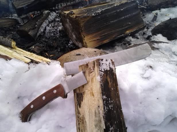

I searched and found this with problem on very light use

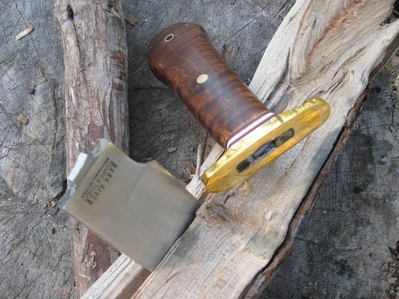

I also found this:

It seems to be issue with BRKT
To be fair, I have seen photos of frozen wood chip 1095, 52100 and busse's sr101... that golok got what was coming to it. Use an axe or a saw for frozen wood.
Edit: just about all of the photos shown can be explained by the explanation I gave earlier regarding the burned edge. All except for the snapped tang which is likely from a stress riser from a 90° angle in the transition, or the first photo which looks to be a failed rod test or conchoidal fractures from an improper HT which happens to All companies.

This thread is hilarious. First guy gets caught in such a web of lies he wants his account deleted. Now this guy is just posting pictures of broken knives with not one bit of context. Completely meaningless.
