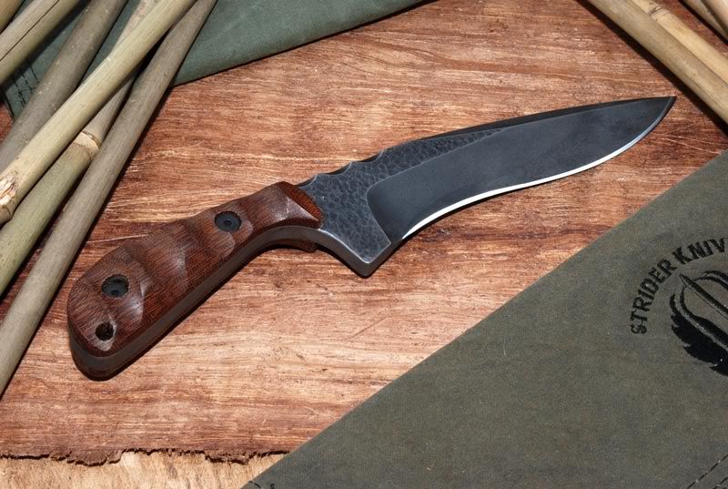

Looks like I'm never going to hear anything about the steels used, the heat treating or whether this is actually a laminated / composite blade as represented. Watching RL work on his entirely transparent victimization complex is getting tiresome. So I'm out, too. Y'all have have fun now.

Roger,
I’m not Mick and I didn’t stay in a Holiday Inn.
From my experience with damascus and the information Josh gave us, I can deduce the following:
1. The damascus is a carbon steel and pure nickel mixture. Could be anything from 1060 to 1095.
2. It is not a San Mai in any sense. I’m not familiar with the term San Mei.
3. From the knife I can tell that the billet is stacked and forged in one shot.
4. It probably has about 119 layers but may be as high as 143 depending upon how the billet is stacked.
5. The knife probably has a good heat treat or the carbon steel would not be “Black”
6. The knife will get sharp but edge holding will be limited because nickel will not harden.
7. The heat treat at a minimum should be a standard simple carbon steel heat treat.
8. You do not need a big hammer to forge this billet. A 50lb LJ would do just fine.

Twisted Nickel Damascus is forged from C-1095 and Nickel 200. The average bar starts out with 250 layers of alternating steel and nickel layered up and flat welded at 2200 degrees Fahrenheit. Our 75 ton hydraulic press sets the weld at this temperature allowing for a very high definition pattern. All bars are normalized and annealed before surface grinding. You can bandsaw, drill, mill or file work the steel in this state. Nickel is a bright finish material, highly corrosion resistant, and will allow you to finish your blades with a very high contrast. You can also hot gun blue or black oxide them for an outstanding look.
IIRC, his Damascus is pretty but not very high performance.
I don't consider your comment to be stupid, necessarily, Keith...just exceedingly frustrating...by the same rationale...why even heat treat it, or sharpen it....at what point is an art knife no longer a knife, and just a piece of art?
It is the case with many knives that are going to be safe queens, that they are not heat treated, or not sharpened, or have elements that will produce stress risers purposely introduced, or any combination of the above. I personally would never be interested in a knife that was made in those ways, but there are lots of folks that don't have a problem with such knives. Making a blade from pattern welded steel that has a high pure nickel content is not done to produce a high performance knife. It is done for one reason only, to make the knife prettier. Just because you and I believe that even art knives should be designed to work optimally, it is obvious that not everyone shares our position on this.
i don't care about the looks, or the price, or the makers reputation as long as the blade can't - for technical reasons - perform as it should. assuming that the bright layers in mr striders own damascus are nickel, i wouldn't pay a cent for such a knife. when it's up for sale, it's close to intentional deception not to mention the poor performance of a knife that looks like excalibur's clone.
don fogg:
"For the brightest contrast pure nickel is often used. I do not recommend it for blade steel. Nickel is a carbon blocker and in the finished billet the soft nickel layers will end up on the edge and affect performance. It is best used in fittings for really high contrast."

One last stab at getting some info:
HEY NEIL - WHAT THE HELL IS "SAN MEI" DAMASCUS?

I doubt we will get any answer about San Mei damascus.
