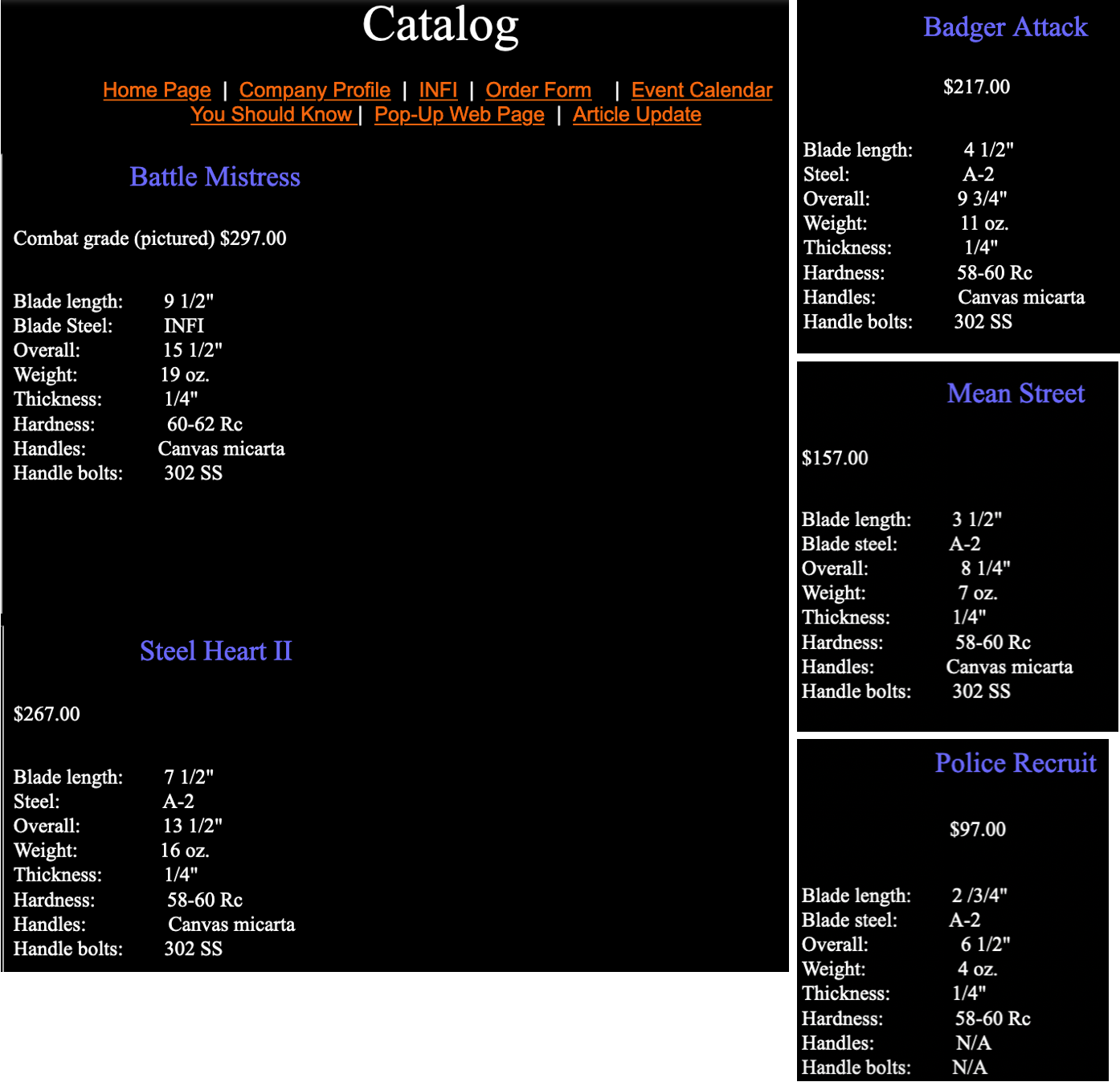

On the wayback machine, the first recorded snapshot of the bussecombat.com catalogue is from 21 Feb 1999.
It lists five knives for sale. Check out the steel they're offered in.
Great find!
One of my favorite past-times around here is reminding people that there were never officially any 'Straight Handle' Busse monikers and that the original Battle Mistress was simply called 'Battle Mistress', lol.
Yet the ASHBM has Straight Handle in the name all those years later...
