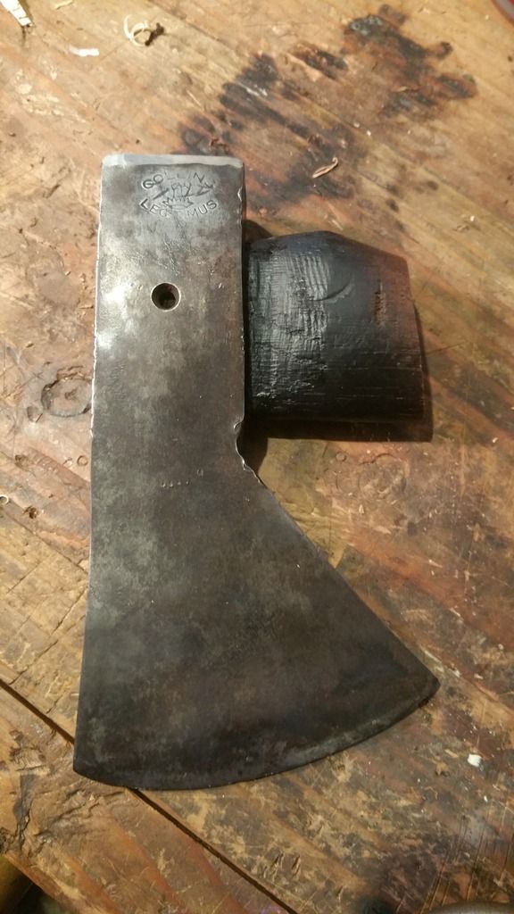

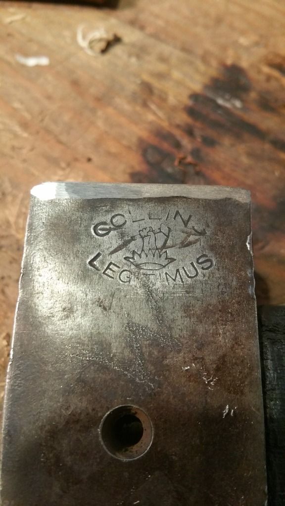

My son and I just picked this one up at a flea market. Covered in black paint which came off quickly with a wire brush and exposed a lovely patina underneath. Not much pitting from rust at all. The head was slightly mushroomed, which I've corrected. We'll sharpen it up and hang it and he intends to use it.
Seven pointed crown without the apostrophe or the space indicating it would be there.
These Apostrophes are driving me nuts. I think just for my own sanity, my new theory is that there was a disgruntled, rogue Collins employee running around putting apostrophes on stuff...;)
I notice that the space between the 'N' and the 'S' at the end of "Collin's" has been increased to make space for the apostrophe. So it's a unique stamp.
