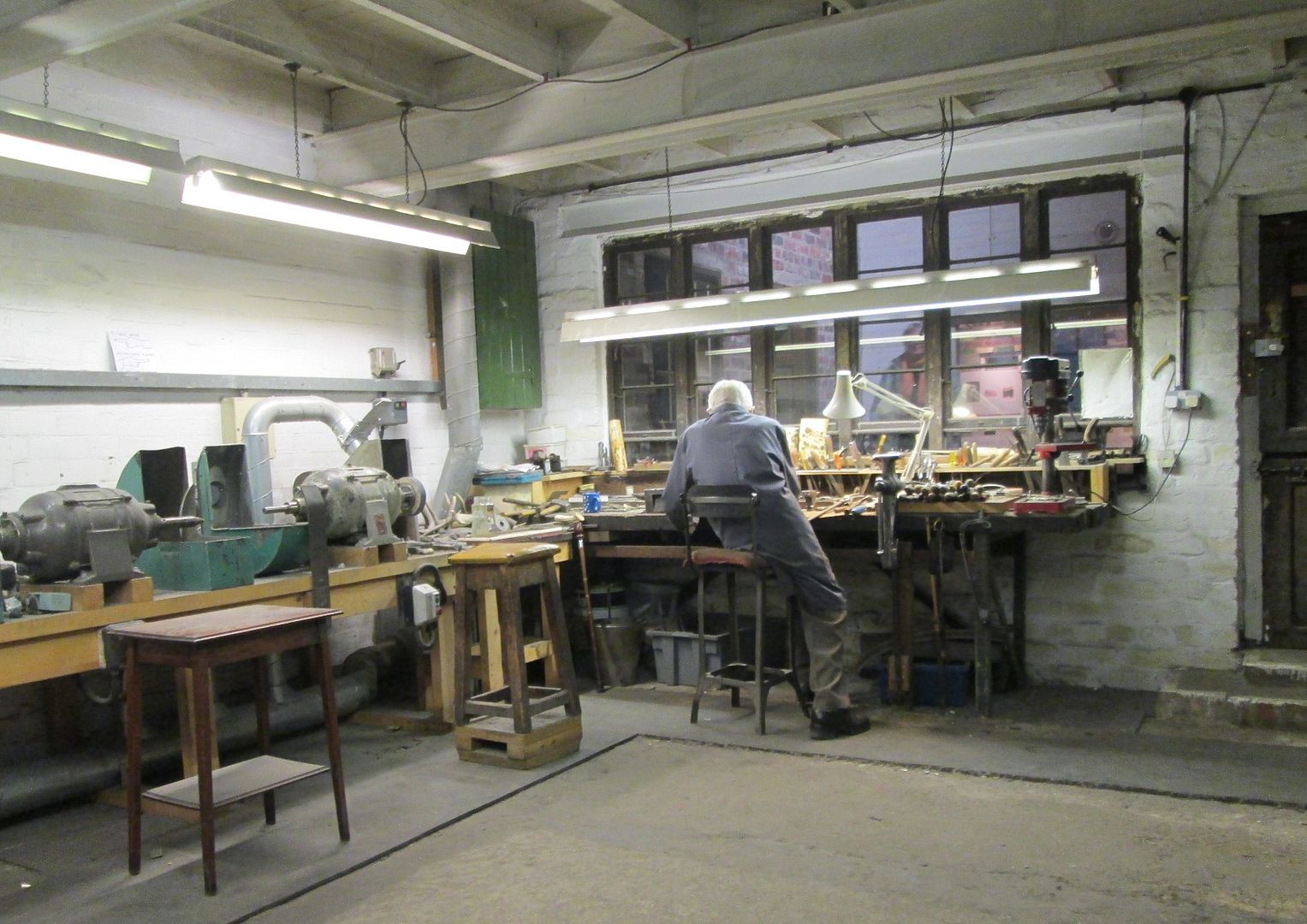

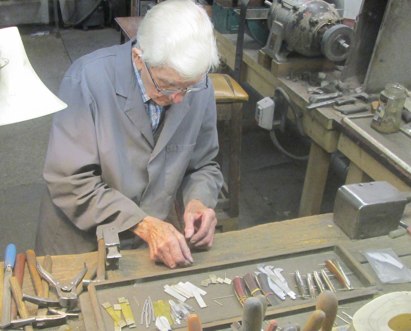

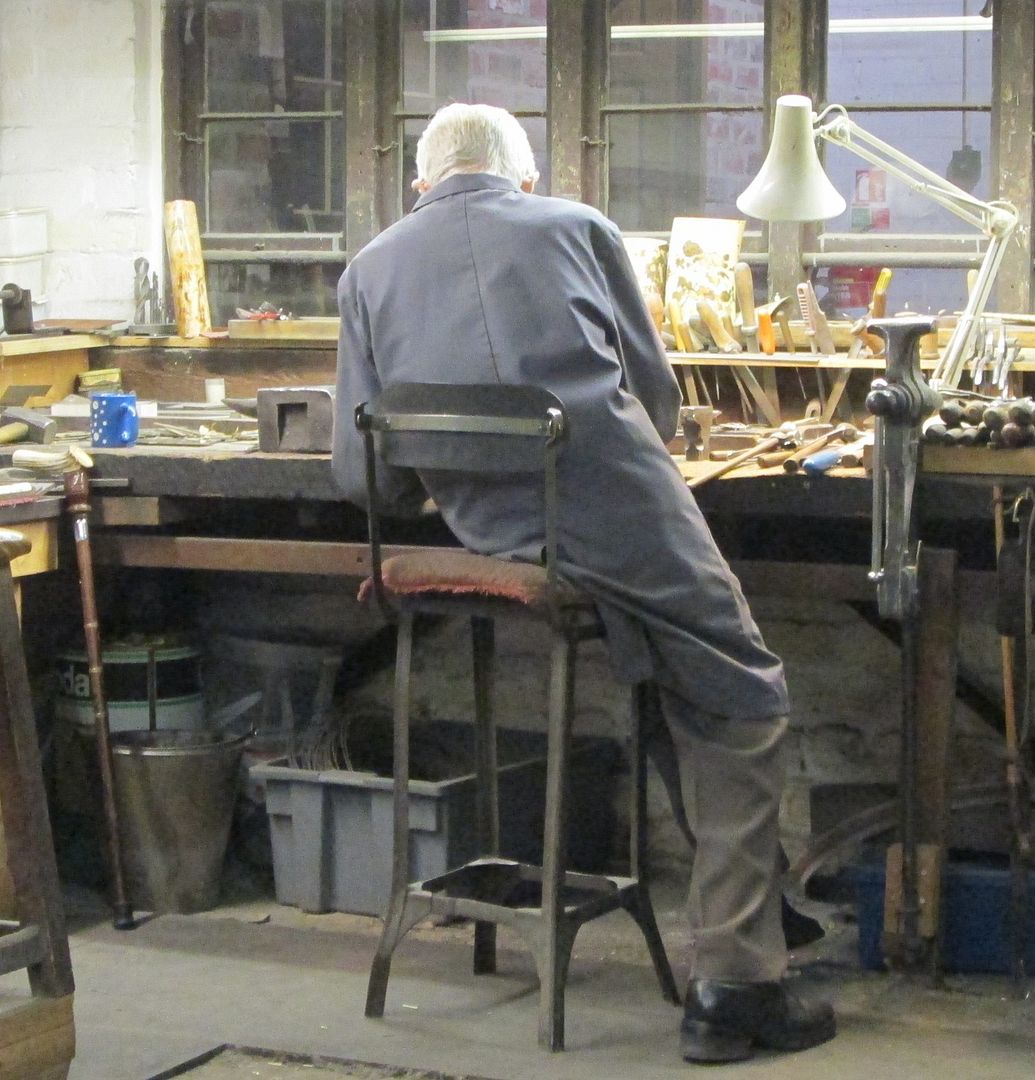

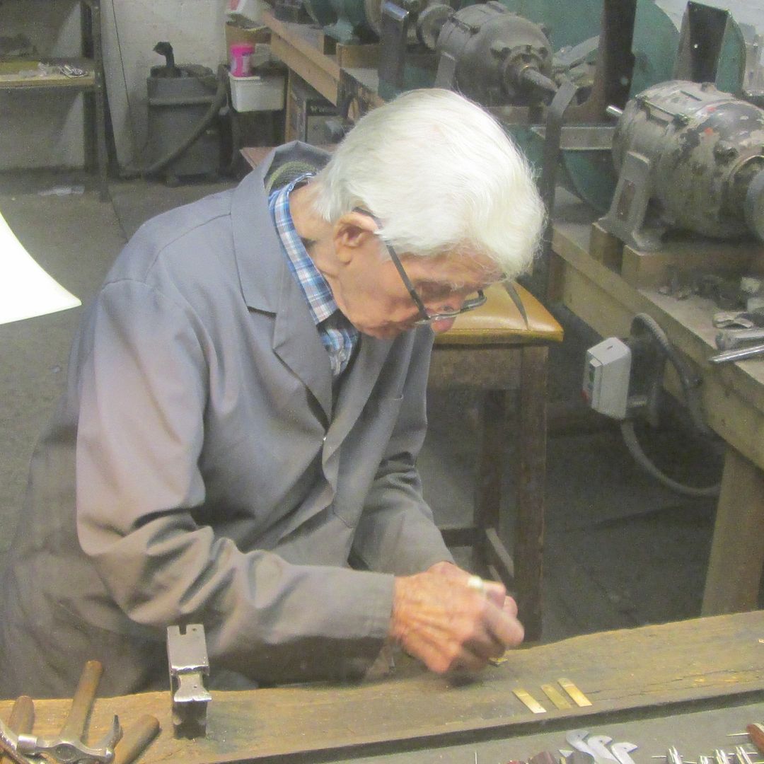

Duncan, I gave Stan your best. I didn't take any photos of him working today, as by the time I arrived at his workshop, he was sitting down to his lunchtime sandwich. He was having a break from his usual marmalade, and had blackcurrant jam (jelly) today. Also, he had another gentleman visiting him.

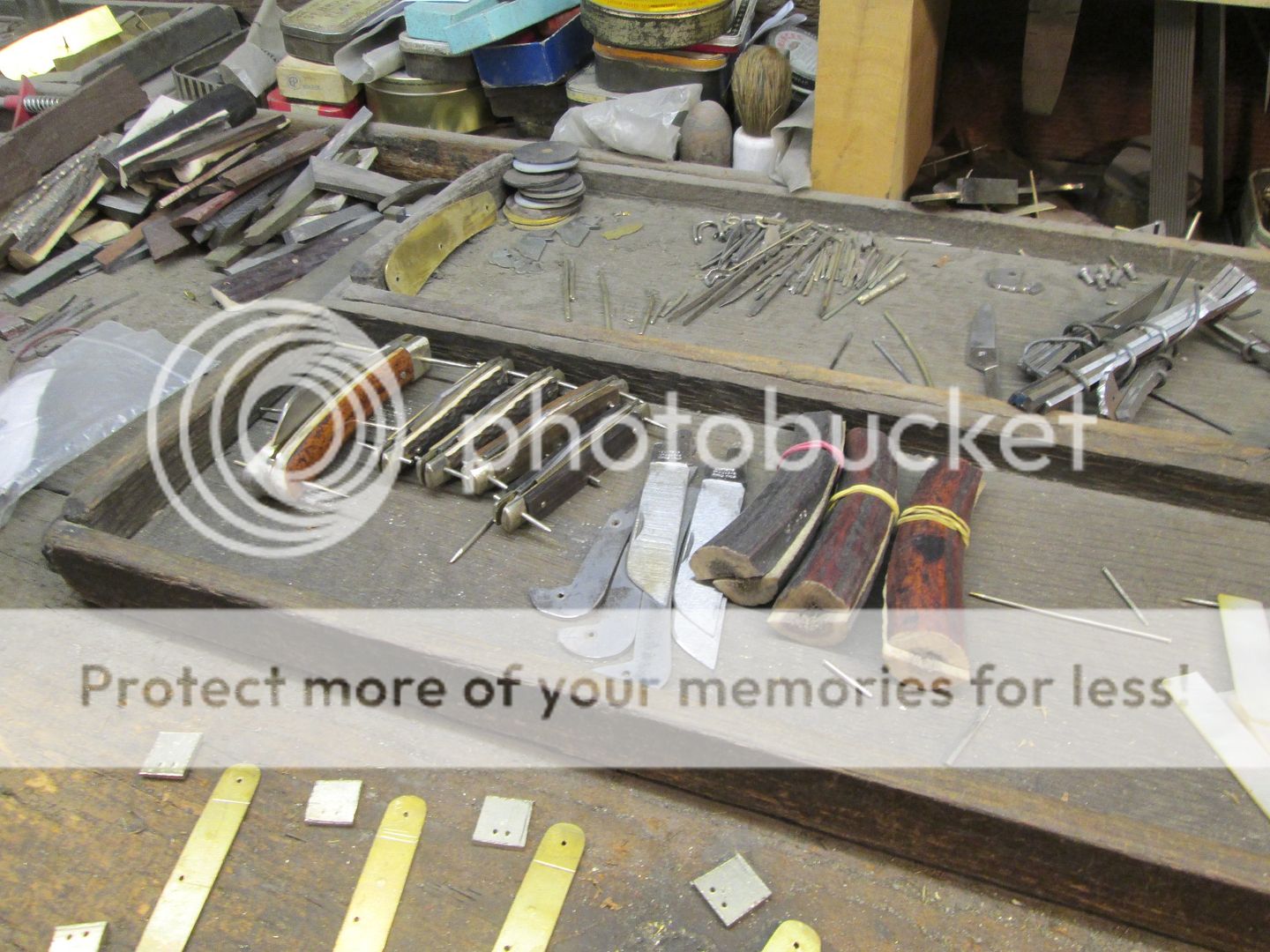

Stan had been doing some work on his granddaughter's Hallamshire Knife, and he had brought in the original, the knife pictured in some of the photos above, for comparison. It looked pretty fabulous. He was also still working on some Sheepsfoot knives in stag, and also showed me the parts he had cut out for a Whittler he was making to order, which will have tortoise-shell covers, with gold leaf behind, and solid silver bolsters. I'm hoping I get a chance to see that one when it is finished.
I asked Stan about the shells, and he said they were too thin to use, so he had put them there so visitors to the museum could see the sort of materials Sheffield cutlers worked with. The ivory item is actually an antique crocodile, and the part which can be seen in the photograph is the tail. Stan cuts everything, including MOP, with a hacksaw.
We got to talking about tortoise-shell, which of course is actually the shell of the sea-turtle, and I asked Stan about working it. He told me that after boiling, it becomes pliable, "like rubber", so that the scales can then be flattened or shaped. Stan said that ivory is the same when it is boiled. I had a nice thick ivory page-turner for him, and he reckoned that he could cover quite a few knives from it, more than I had expected.

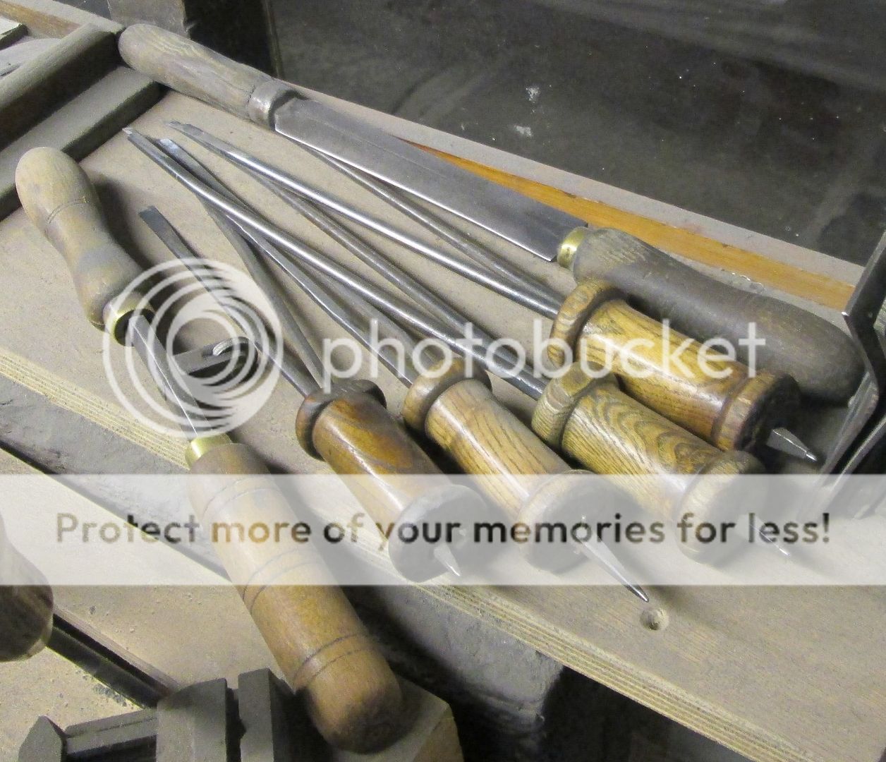

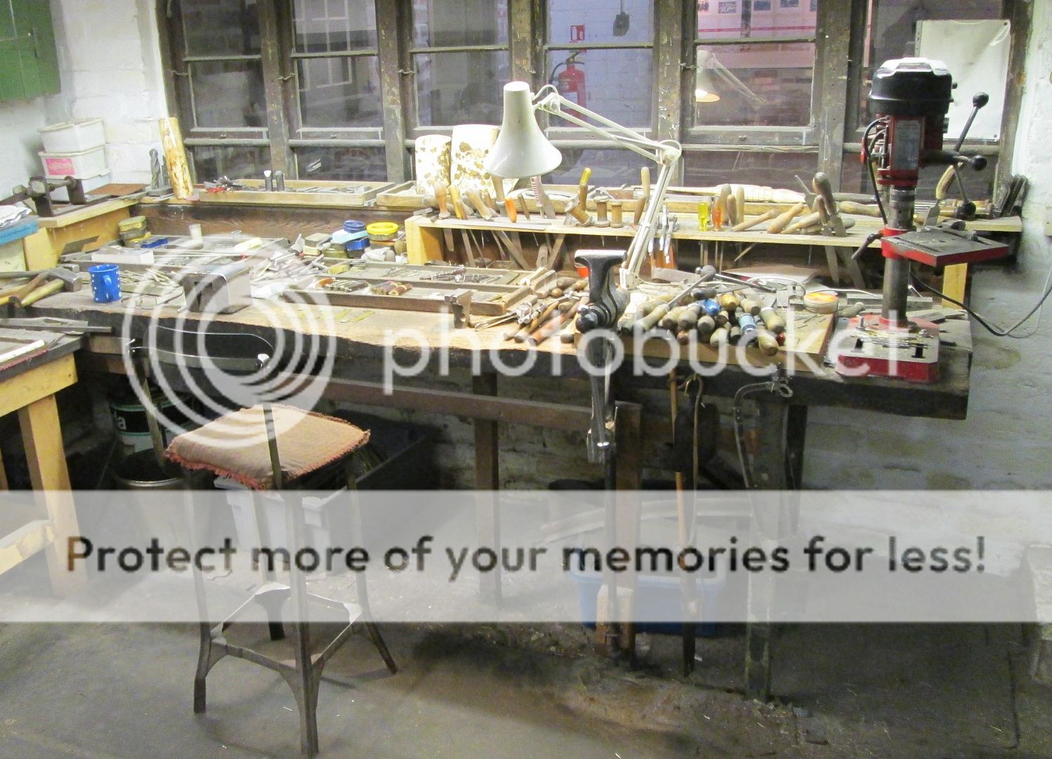

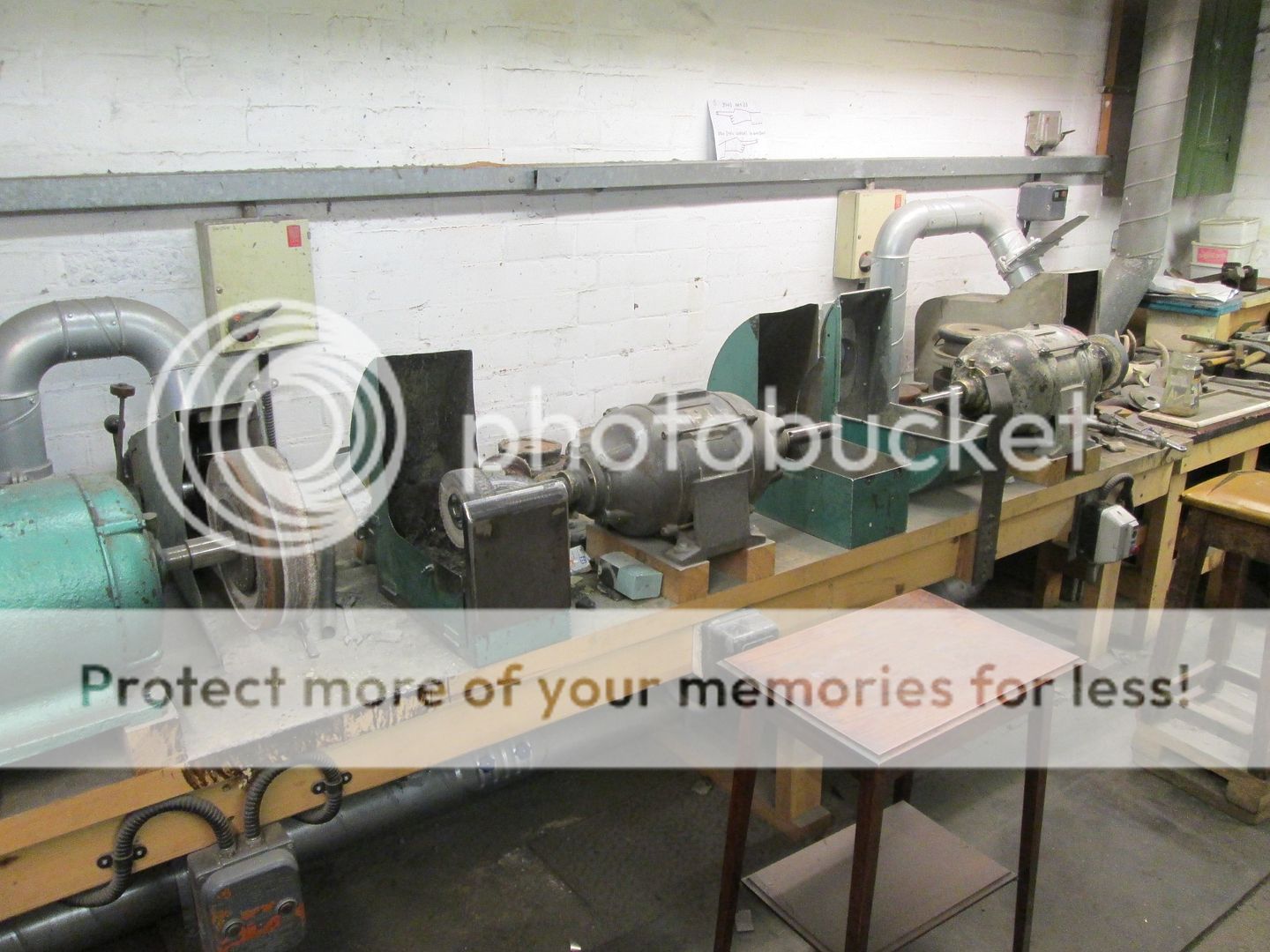

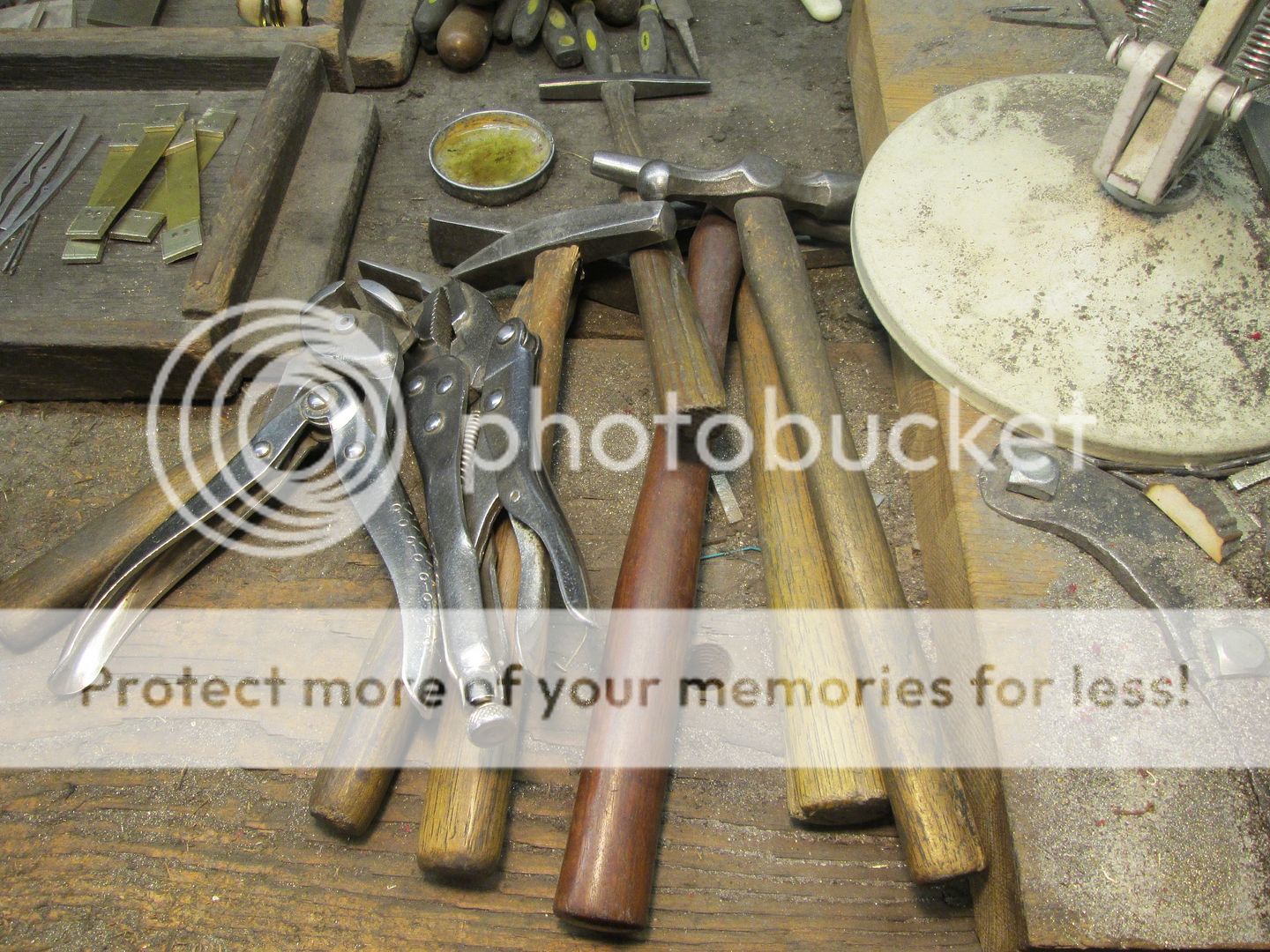

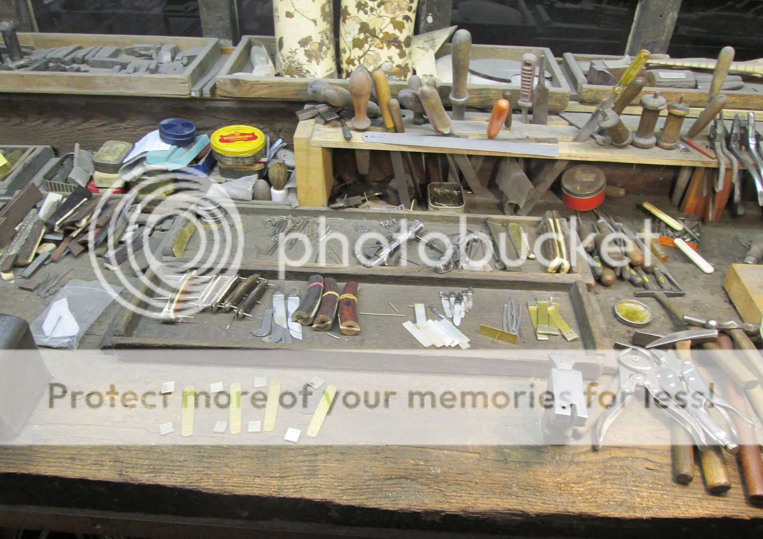

I had lunch with Stan at the beginning of last week, and managed to take a few pics of Stan and his workshop :thumbup:

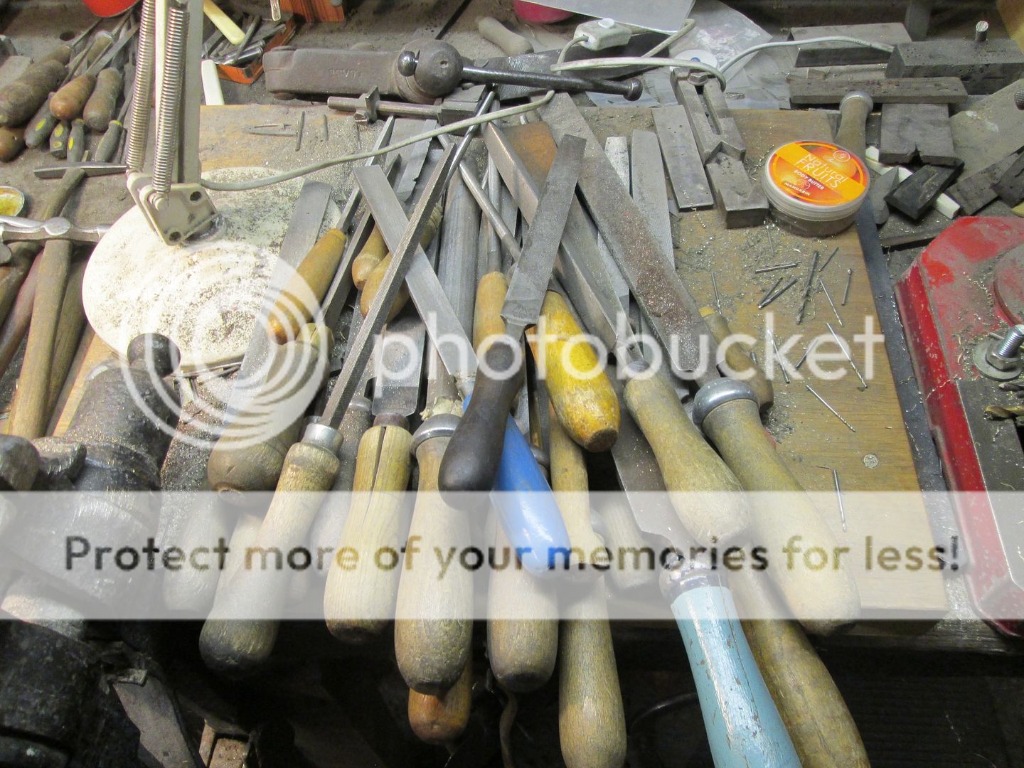

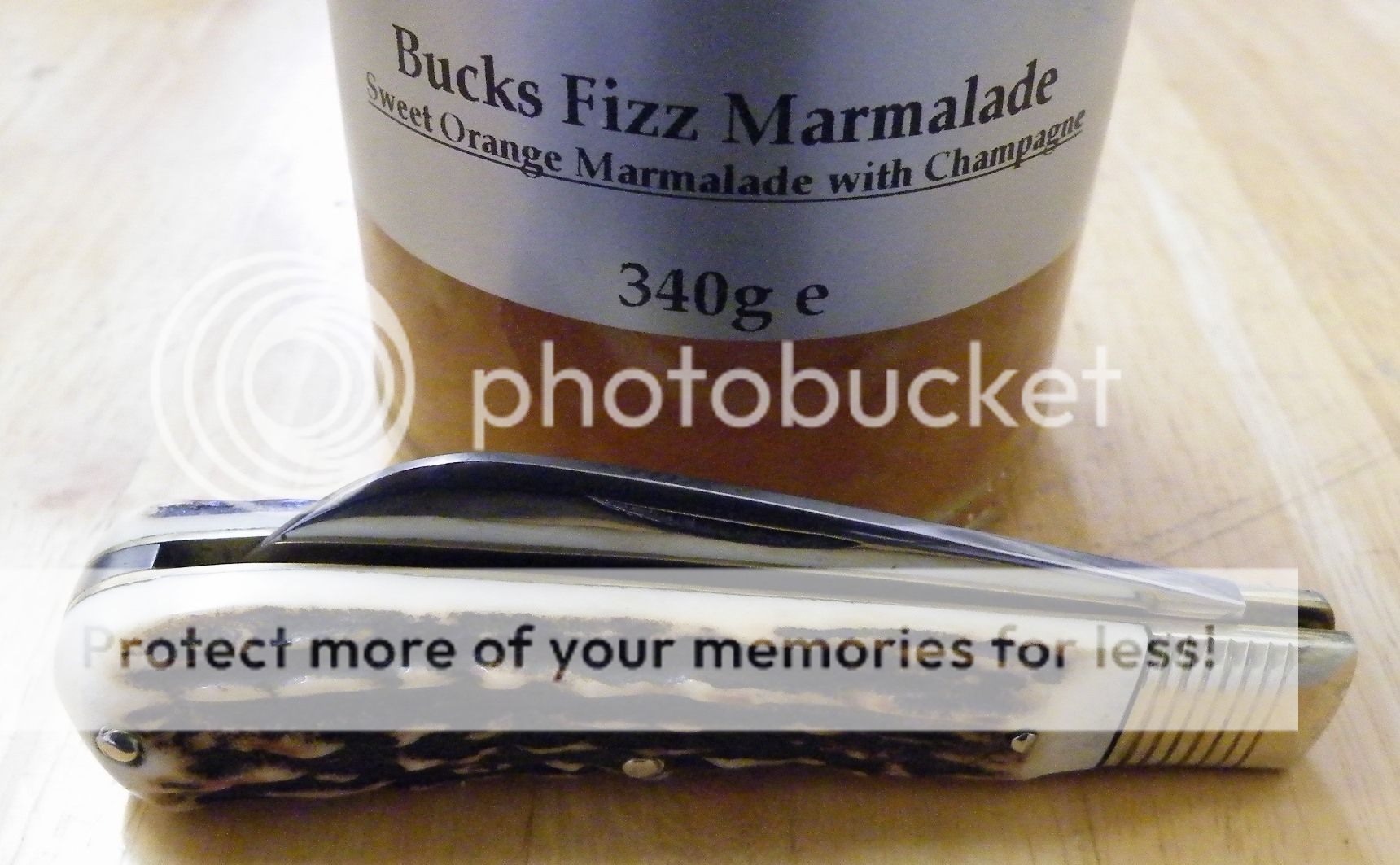

Personally, I find the last photo of a selection of Stan's archaic Sheffield tools particularly interesting. The tool at the rear of the photo is Stan's Burnisher, then there are several Two-legged Parser bits. Stan referred to the other tool as a Thread, but I'm not sure if he was talking about the whole tool or just the wheel, which he uses to apply the thread to bolsters, like on my Sheepsfoot below. He also has a similar tool for coining liners, like on my Lambsfoot seen in the link above :thumbup:
The marmalade was an early birthday present. Stan is 90 on December 2nd :)

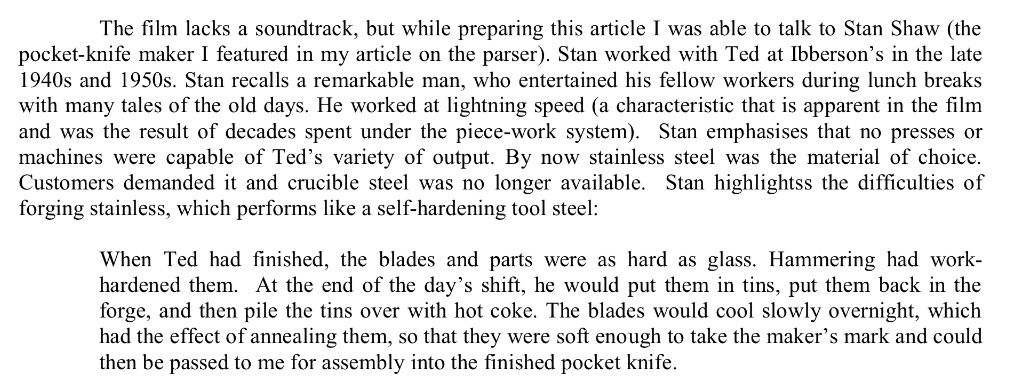

Thanks, excellent article on Sheffield forgers that, well worth the read - not only for Peter Goss's story but for introducing Ibberson's Master Forger, Ted Swinden to me as well.
I hope you dont mind me reproducing a bit here that references Stan.
The author is talking about a film Billy Ibberson commissioned on the advent of becoming Master Cutler of the Guild, and how it shows Ted Swinden hand forging (apparently he could complete two gross of blades a day - amazing).
