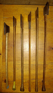

...The photo below is meant to demonstrate the devolution. It is, in fact, a brief documentation of history, because what you see here are commercially-produced ax handles, purchased in Canada between 1975 and 2011. All of them are hickory. (To further qualify, the third handle is a version possibly turned in Sweden -- and sold globally on what presumably is one of the “hand-forged” connoisseur axes today.)
Here (from left to right) are their respective dimensions and weights of the heads they came with:
1. (1975) – 18x32mm, 31 inch long, head 3 ½ lb (my very first ax)
2. (1995) – 23x37mm, 27 inch long, head 2 ¾ lb
3. (2010) – 26x 39mm, 26 inch long, head 2 lb
4. (2011) – 29x40mm, 27 inch long, head 2 ½ lb
“What’s the problem?”, some people may exclaim, “if anything, we are getting progressively more wood (and presumably strength) for the money”. Well, yes, there is nearly twice the volume of wood in each foot of the 2011 as opposed to the 1975 handle. However, as I hope to explain below, this is clearly a case of “too much of a good thing”...
During the 35 years of living in New Brunswick, Canada, I’ve come to appreciate the local old timers’ love for slim and limber handles (examples to follow). These now 80-90 year olds, who did grow up with an ax in their hands so to speak, consider contemporary “boughten” handles way too clumsy and oversize, fit perhaps for a pickax but not a wood chopping ax.

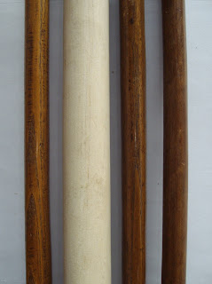

In the photo below you see three locally made handles with the 2011 “white elephant” in-between. While measuring these three (for the purpose of this piece) I was surprised that their cross sections were exactly the same –16x33mm!
The respective lengths and weights of these axes are (from left to right):
32” (sugar maple) with single bit 3 ¼ lb head
27" (hickory) with single bit 2 ½ lb head
29” (ash) with double bit 2 ½ lb head
29” (ash) with single bit 2 ¼ lb head

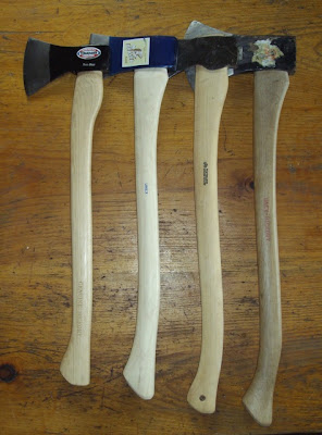

The notoriously popular curvature in the bottom end of single-bitted ax handles is one of those insidious aspects of ax design in general that people have accepted without realizing that by using it they are (sort of) “working against themselves”, so to speak.
For quite some time before we came across Dudley Cook’s "Keeping Warm with an Ax" (the new edition’s title is “The Ax Book”), I had noticed that I could not do as well with axes the handles of which sported this curve. I could not put my finger on exactly where the problem laid – but Dudley explains it all very well. Hence I now turn to him for help:
“The most baneful defect of the modern single-bitted ax handle is its short bottom curve. The lower end is the grip where the chopper guides the ax. The grip portion bends from the adjoining shaft of the handle by about 10 degrees. Unfortunately, this pretty little curve magnifies the effect of wrist pivoting...
"The axis of pivot for a straight-handled ax lies in the center of the handle throughout its entire length from end knob to top side of the eye.
"But with the curved handle, any rotation is controlled by the chopper’s hands grasping the lower curve at the grip. Therefore the real axis of pivot does not pass through the ax head at all because the 10 degree bend of the lower handgrip is not pointed in that direction. The effective and real axis lies in an extension of the grip and passes somewhere to the rear of the entire axhead.
"The trouble-making grip with its 10 degree bend subtends an arc of 4½” at the handle's residual length of 25". That means that the curved-handle axe already has a constructive "foresection" of 4½” behind what we have hitherto termed the “axis of pivot”. But there is also an additional 4½” waiting at that point. Remember, we stated that each ax has a fore-section distance of 4½” forward of the axis of pivot (by the string-suspension method). For curved-handle ax then, the constructive fore-section length between the real axis of pivot and the bit is: 2x4½”, or 9”.
"So the ax with a curved handle will act as if it had an imposing bit 9” long. For a rotation of only 5 degrees, its bit will swing .78”, exactly twice what that same ax would deviate if hung on a straight handle. Greater rotation would bring greater deviation in the same proportion. This is the most damning case against the curved handle. It is substantially less accurate than a straight handle.

Commercial (that is, lathe-turned) handles do come in a variety of shapes. Most of them sport the curve near the grip. The handle supplied with the "Trail Boss" (far left in the photo below) is one of the few exceptions.
To slim down a thick handle is a relatively easy task. To straighten that devilish short curve near the knob is another matter. When the curve is as pronounced (and the overall amount of wood not excessive) – as in Example 4. – no alteration is realistically possible. On the other hand, the Example 2 can be made almost completely straight (as we will show in a later post). Example 3 is somewhere in-between, while the lower handle curvature on #1 (the "Trail Boss" on the far left) is good as is.

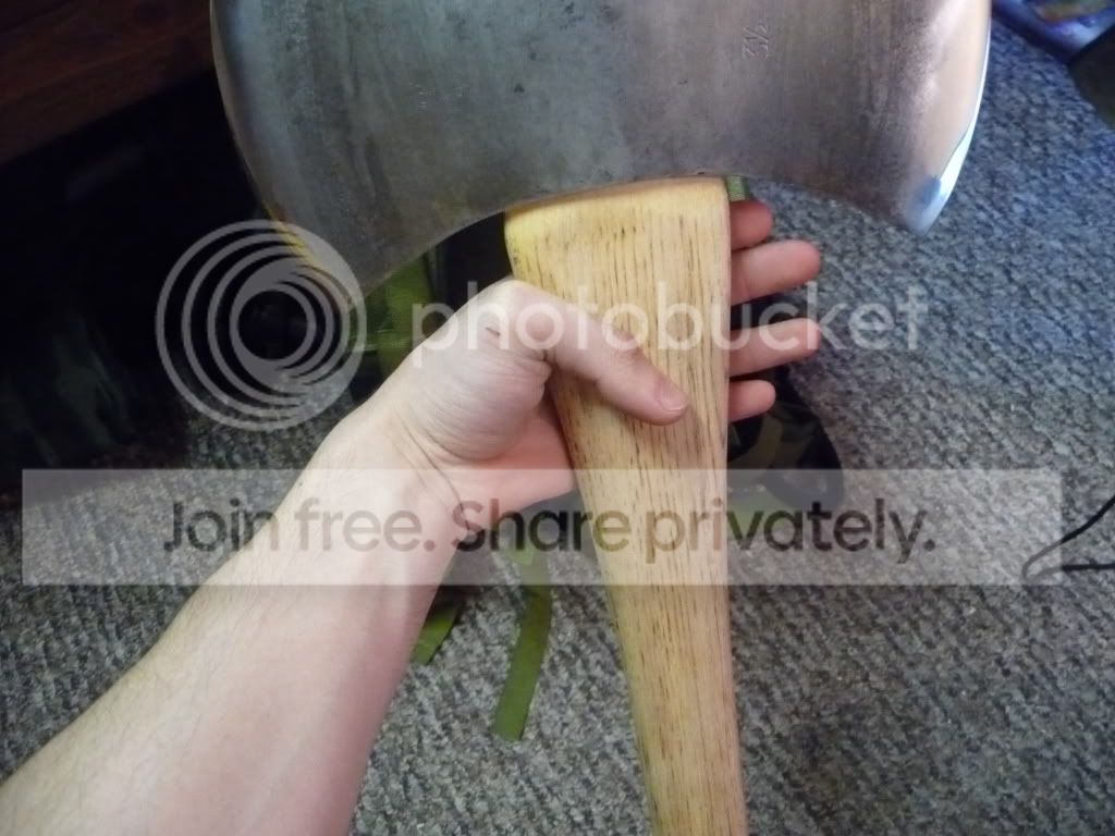

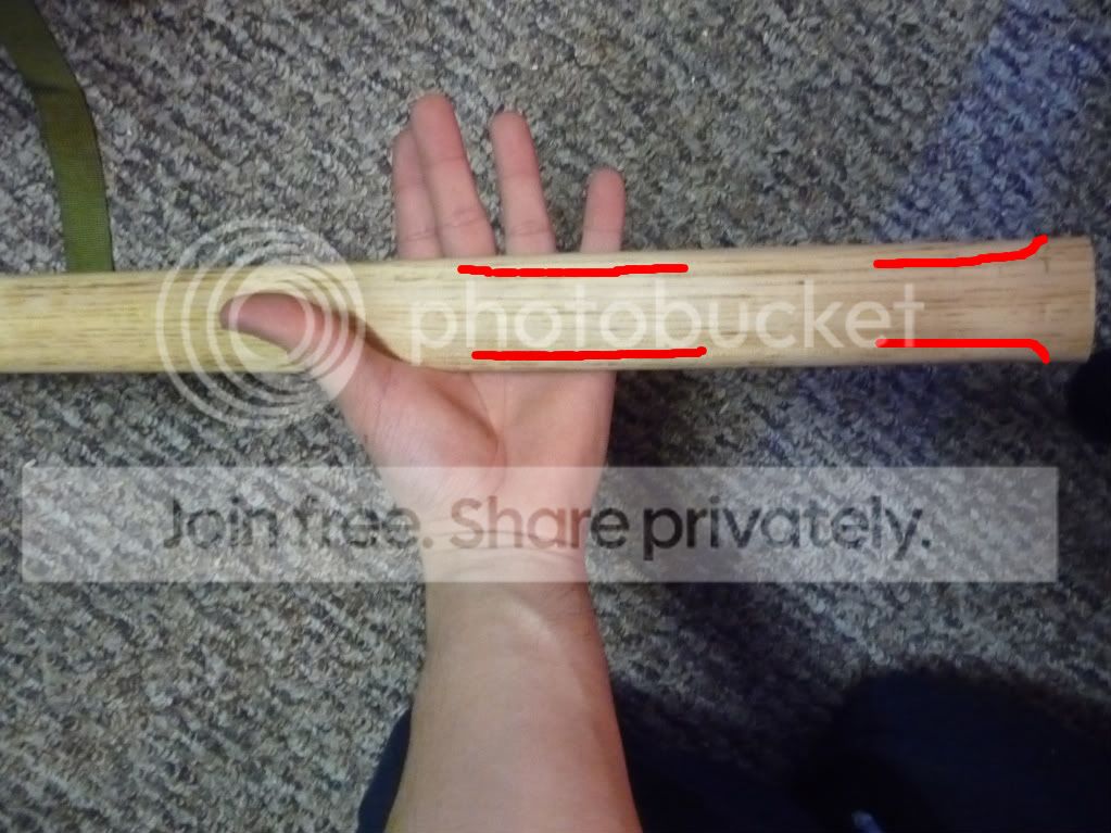

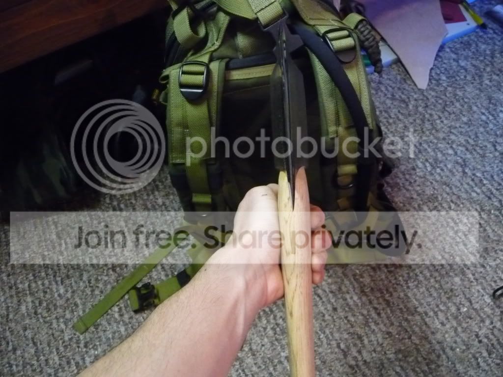

Awesome informative post... I recently picked up a 36" handle for my 3.5lb vintage Gransfors Bruks double bit head. After fitting it on, it felt very bulky and odd to swing (you could say that I couldn't get the hang of it :p). My first idea was that the handle was too long - I think 36" tends to be excessive for a felling/limbing axe and is really only necessary for wood splitting. Anyways, I cut it down to about 32.5" and that helped with the balance somewhat, but it still felt off...
I was already thinking that the thing probably needed thinning down, but this post confirmed that...

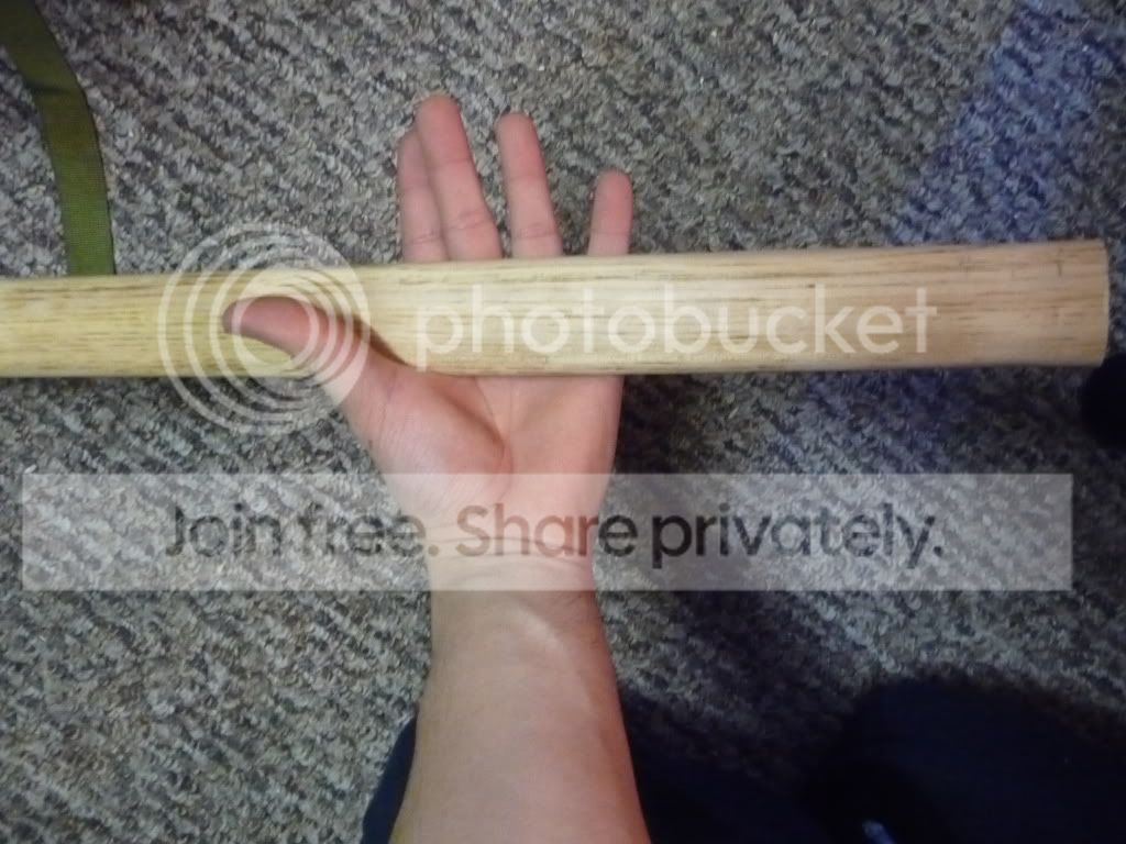

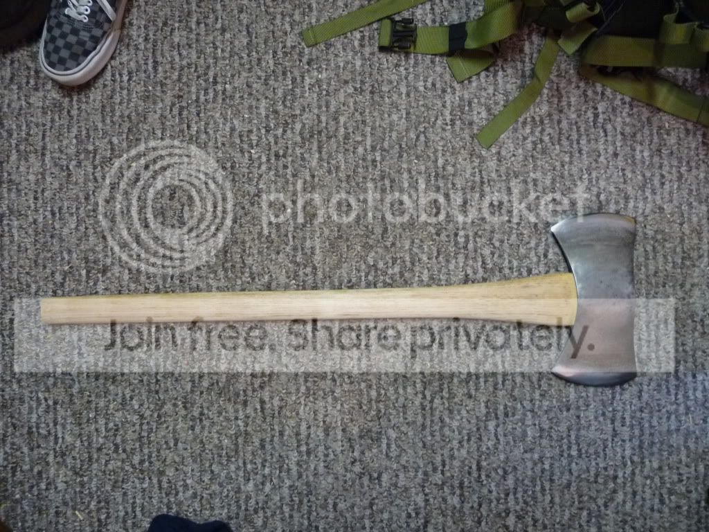

Here are some pictures to show what I mean - maybe you could confirm?:
Too wide and thick at the neck - cold definitely use some removal there
And since I cut it down, it doesn't have a swell knob anymore:
But the width of it seems fairly large for my hand, so I figured I could cut it down and leave a swell at the end in the process like so:
Any thoughts on this proposal Steve?

You got my blessings, killa, but I'm just a greenhorn :o.
But I do think that Peter would also approve, as his 1975 axe handle section measures only 18 by 32mm, for a 3.5 pound head on 31" length, and it has served him well for over 35 years so far.
I think the knob is indispensable for a working axe, to keep it in your hand more easily without having to squeeze it so much.
Flattening the sides (the wider dimension) will also help give better accuracy and keep the axe under better control without having to squeeze it so much to keep it from twisting.
Peter told me his next post will include more info about shaving down an axe handle.
...since I cut it down, it doesn't have a swell knob anymore...
I suggest that you keep the full existing dimensions of the handle at the knob. The sides of the handle, as well as the front/back, can flare out to make the knob more effective. Check out the "side flare" on some of these knobs (photo from Peter):

Haha - well less of a greenhorn than myself... that swedish hatchet I recently restored for my grandfather was my first venture into axe restoration.
Also, perhaps I should wait around until his next post then... I don't really have much in the way of a clue as to how to go about thinning this handle down. I was thinking of just using a knife and rasp to do the major removal then taking care of the rest with very coarse sandpaper. I don't really have a sander or anything that would make the job easier
Yep - that was my intention. The knob at the end is indeed pretty key to axe safety
