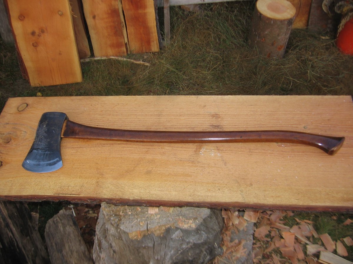

My old Marshall-Wells. My favorite handle.
One of my favorites. 28" fawns foot swell with a slim handle.

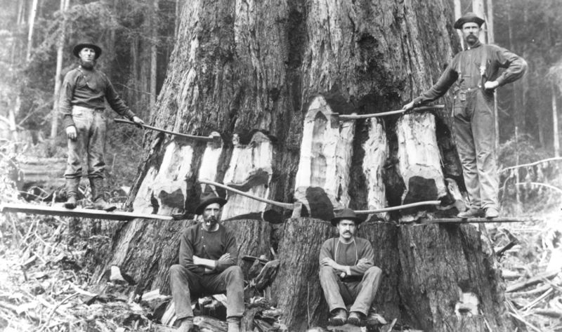

Why would they start the cut so high in the first pic? That tree doesn't look nearly as large as the second tree. It seems like that would waste a lot of wood.
Many trees start their lives growing on 'nursery logs' or 'nursery stumps', the rotting remains of trees that came before them. Over time the roots of the new tree grow down over the stump, encapsulating it. All the wood encapsulating the old stump is worthless.
If you're cutting trees by hand with saw and axe then you don't want to have to cut it again to get rid of the part that the mill won't accept. So they banged on the trees with the polls of their axes, sounding out where the bad wood ended. Then they cut above that.
Here in Washington I've seen roots reaching the ground from atop nursery stumps 20 feet high.
The flared butt is mostly lost as off-cuts when the tree is processed by a mill plus a butt section is awkward to position on a saw platform... and the fellow chopping is not particularly eager to chop through way more than he has to. Lumber itself was very nearly free (ie no cost) for hundreds of years and it was largely the labour and effort involved that determined the price. Up this way the Brits insisted that all export timber be squared on site and have uniform dimensions (something like 12 x 14"). You can imagine the huge amount of waste involved simply because of that.
