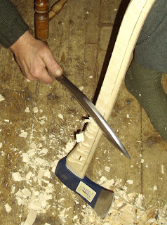

Handle thinning can also be easily done on axes with the heads already attached.
An upcoming post will show this being done using a khukuri knife.
It's almost finished, here's a preview:
