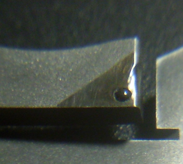

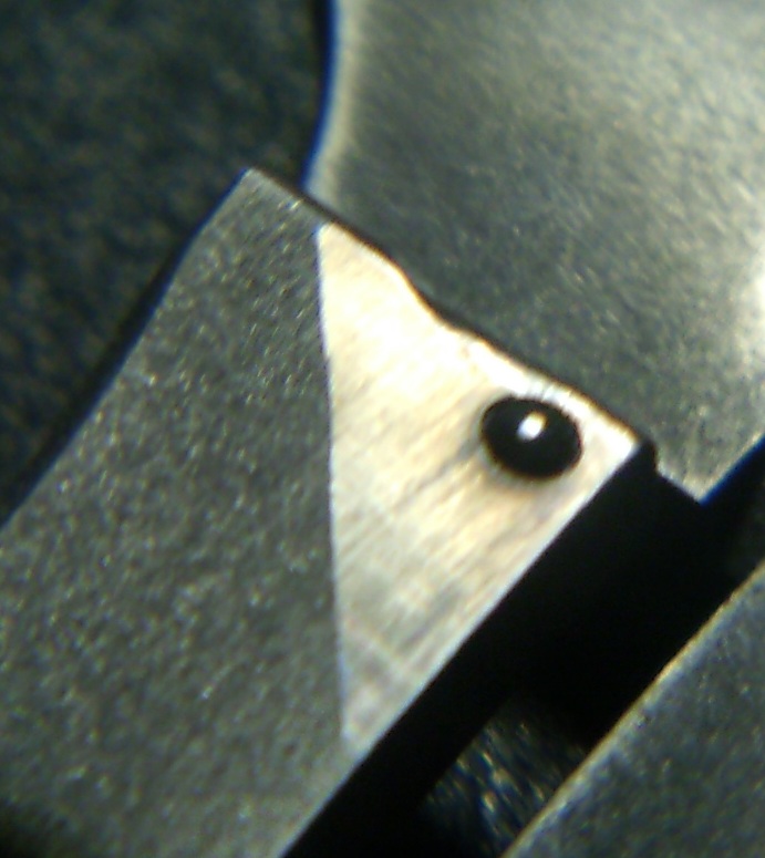

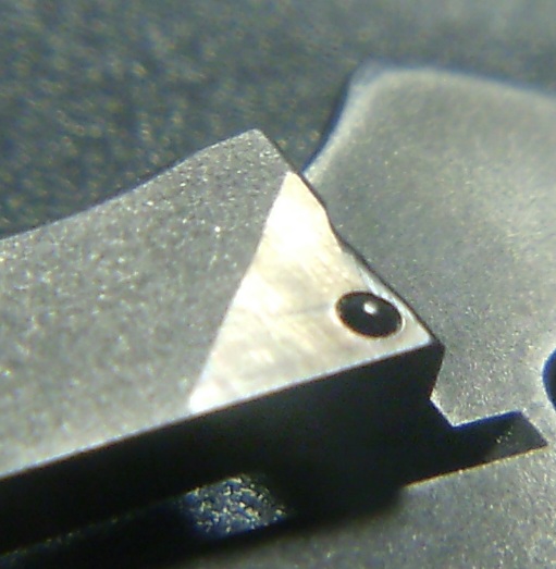

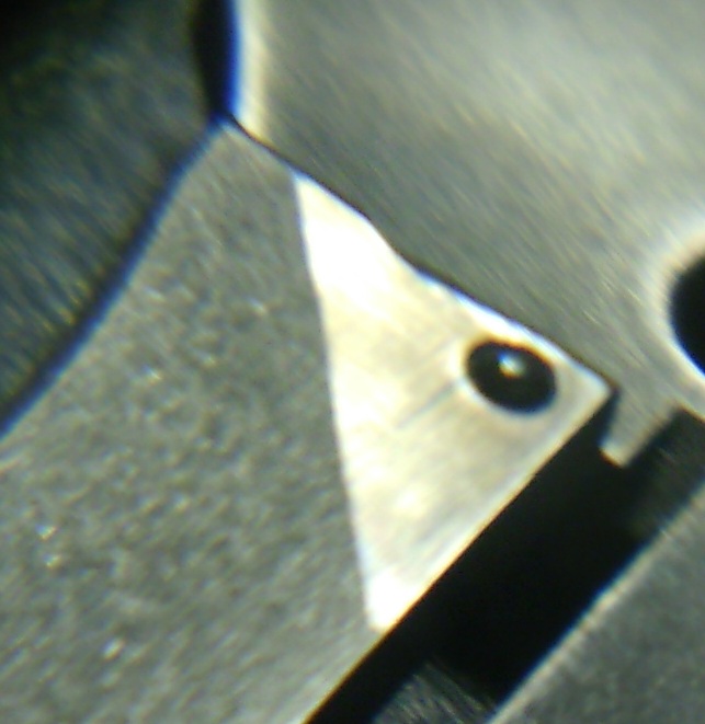

Is it normal for a lockbar to dent like this?
kreole
Jul 23, 2009
4,561
The lock bar on my three week old small 21 seems awfully dented, while my small Insingo's lock bar is nothing like this despite being around since May. I imagine it's not a real issue (it doesn't seem to affect the lock up negatively), but I can't get it off my mind, so I figured I'd ask you guys. It began to look like this right away, and I'm not sure if it's getting worse over time or is now "broken in" and staying the same.
I hope these pictures show it. I tried to take them on an angle to show the difference in height.
Don't flick it open.
The detent is so difficult it is basically impossible to flick. In fact, I open it two handed 95% of the time. It has only faced two flicks, neither involving any wrist movement. Besides, it started to show up well before either of those occurred.
the lock face might not have been heat treated right. Give CRK a call and they'll sort it out for you.
If ever there was knife that needs to go back to it's maker that one has to be it.
Let us know what happens :thumbup:
Looks like the lock was forced to fail slipping off the tang of the blade.
Either that or something else was done to it. Send it to CRK and get a determination. None of my knives look like that regardless of use.
Looks like a bad heat treat to me. I would call them on Monday and refer them to this page.

It could be the result of the blade rubbing the liner there as it heads in rotation toward the detent ball, at which time the blade would be riding up on the ball instead of the lock itself. Keep in mind the blade is significantly harder so it could wear on the ti and even cause the corner to roll some. However, looking at the lock that looks purposeful to me as if someone has peen adjusted the lock contact to remove the part of the lock from position to prevent that area from contacting the blade. Regardless of how or why I don't think its anything to worry about at all though. But not seeing the knife and where the blade actually contacts on the lock its hard to tell if the bottom of the lock is actually going to be hitting the blade on this model or if the area of wear is where the blade connects. Some models of other knives have the tang of the blade recessed down some in the body so its possible that it is a concern if this is the case. Its never a waste of time to get the maker to look over anything you question.
STR
STR
I'm the first owner and haven't modified it in any way. Just now I shined a flashlight in there and watched as I opened it slowly. The bar doesn't ride on the blade until it drops off the detent ball. I noticed the dent in the lock bar is exactly where it contacts the blade when it drops off the detent ball, so that could be where the damage is coming from. Could the lock bar have too much tension, which is resulting in this damage? As I mentioned earlier, it is very difficult to overcome the detent, and that's a result of pressure from the lock bar, right? I know friction at the washers isn't to blame for the difficulty in opening it because the blade falls freely if I push the lock bar over to remove its pressure.

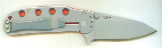

Here is some pictures to show what I mean about the contact and how there are differences from one to another.
Note the Boker Trance. See how the lock overhangs off the tang of the blade. You can see that the blade has to contact the lock not at the bottom per say but as far toward the bottom as it can based on how it was built. If yours is like this then those marks may be issues to have looked at.
If however its like this Strider and connecting just the opposite where the blade actually overhangs the lock instead of the other way around or even if both are flush at the point of contact then you have a lock connection at the very bottom of the lock but it would leave wear marks where it connects on the blade not at the bottom of the tang unless it was flush with the lock. The wear marks on the lock you show pics of seems to suggest something contacts there or did at one time. I hope this comes across for you. The lock may be contacting the tang at the damage area and since I don't have it in front of me I can't tell you if it does or not.

The top of the dent is about where the part of the tang touching the lock bar ends. It appears to sit right in the innermost part of the dent, but I can't really tell with the other scale in the way. I don't really see any gaps between the lock bar and tang, except at the corner where it's dented (because of the dent) and very slightly on the side where the lock bar is cut from rest of the handle (which is like the Boker pictured but the gap between tang and lock bar can't be more than .5 mm). Overall, the contact appears uniform between lock bar and tang.
I can tell it still contacts the dented area when the blade is traveling between the locked position and riding along the detent ball.
I've accidentally started to close it before the lock bar was completely out of the way (being in a rush and not thinking), but it's not my standard way to close it, and it hasn't happened more than a couple times. I don't think that can explain it; while it makes sense that the top and corner could dent because of that, the dent continues all the way to the detent ball, and that area would take sideways pressure, not the downward pressure of the tang, I think.
