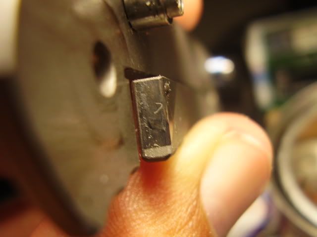

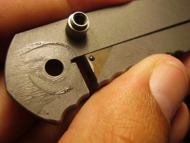

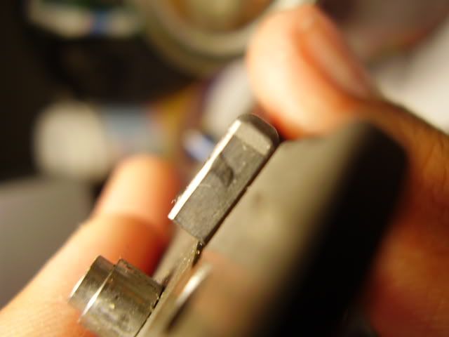

Is it normal for a lockbar to dent like this?
The top of the dent is about where the part of the tang touching the lock bar ends. It appears to sit right in the innermost part of the dent, but I can't really tell with the other scale in the way. I don't really see any gaps between the lock bar and tang, except at the corner where it's dented (because of the dent) and very slightly on the side where the lock bar is cut from rest of the handle (which is like the Boker pictured but the gap between tang and lock bar can't be more than .5 mm). Overall, the contact appears uniform between lock bar and tang.
I can tell it still contacts the dented area when the blade is traveling between the locked position and riding along the detent ball.
I've accidentally started to close it before the lock bar was completely out of the way (being in a rush and not thinking), but it's not my standard way to close it, and it hasn't happened more than a couple times. I don't think that can explain it; while it makes sense that the top and corner could dent because of that, the dent continues all the way to the detent ball, and that area would take sideways pressure, not the downward pressure of the tang, I think.
Anyway, I'll call tomorrow and see what they say.

I took a few pic's of the wear on my 9 day old large 21's lock bar face.
Is this normal wear? can one of you guys please post a picture of a well use older sebenza lock bar face please?

Well I dont know if this is relevant, but here are pictures of my old sebenza I EDCed for more then a year, this was the last cleaning it had in my hands before it was taken.
I had no issues with the knife. Locked up solidly, no blade play, just kept on going. From my experience the wear you see is the sharp corner of the blade over the edge of the lockbar. Nothing more.
I rethought this for a while. On a new knife as in the original posted images I think it is a bit excessive.
frontline29.
I think yours is normal.
I have accidently started pushing on the blade many of times before the lock bar was disengaged and do not even have the start of what looks to be your problem. My lockbar has no scratches on it at all, much less metal being removed from the corner of the lock bar.
From what I can tell from the condition of the locktab in these pictures, I can only see two probable causes for this damage - 1) an improperly heat-treated tip on the lock tab, or 2) forcible attempts to cause the lock to fail, i.e. spine whacking. In either case, you should send the knife back to CR as it appears that there is now less contact area on the tab for the blade tang to rest upon. Conceivably this could cause lock failure. CR will probably raise questions about your treatment of the knife, but they should still fix it for you in any event.
There are other indications of abuse will be evident if the knife has been mauled, so I wouldn't worry to much if you are the original owner and you've treated properly as you've described. Since these knives have a great deal of handwork involved in their manufacture, and with heat treating the locktab being a general PITA, there is always the possibility of human error. Please let us know what the follow-up is.
Well abuse is out of the question. Were still in the honey moons phase. Much less got to the point were I've actually wanted to start using this knife like I would a Spyderco or something similar. ;)
^^ This is what I personally think is happening.
I have to ask but how many of you guys posting these damaged looking lock faces have spine whacked or spine tapped your folders? The damage looks to be something that could only be achieved by just such a shock trauma to the lock face to me other than the slightly rounded off edges where the blade would rub it as its approaching the detent ball in rotation. Some of the indenting and what looks to be chip outs of the titanium I really have to question. I'm not saying you did anything but I have seen spine taps and particularly "whacks" do that in testing locks at times. Its the only way I know of that you can seriously indent a lock face or chip out material like some of these pictures show. Again, though I'm not saying you did that. Just saying its what would enter my mind to look at it if it were sent back to me after it was purchased.

I used and abused (and constantly flicked) my previous small regular sebenza for 4 years, and I had no "denting" on the lock bar face as seen in some of these pictures.
Frontline29, I think that your Sebenza must have a bad heat-treatment. It looks like part of the metal has been chipped away. My old sebenza looked nothing like that. I also took a look at my month-old small sebenza 21 and it has no wear at all on the lock bar face.
