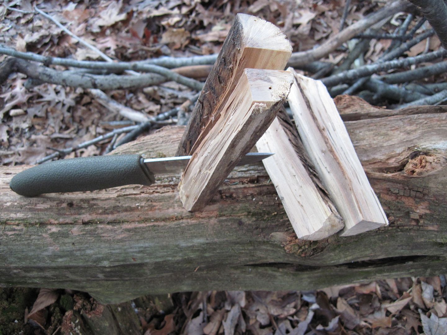

I won't disagree about cheap China SS being total trash or improperly heat treated. I have found that SS, even thin stock from cheap knives which are shaving sharp can baton. Showed my friend how to baton with the .079 Mora clipper I gifted to him. I think he got the hang of it rather well.

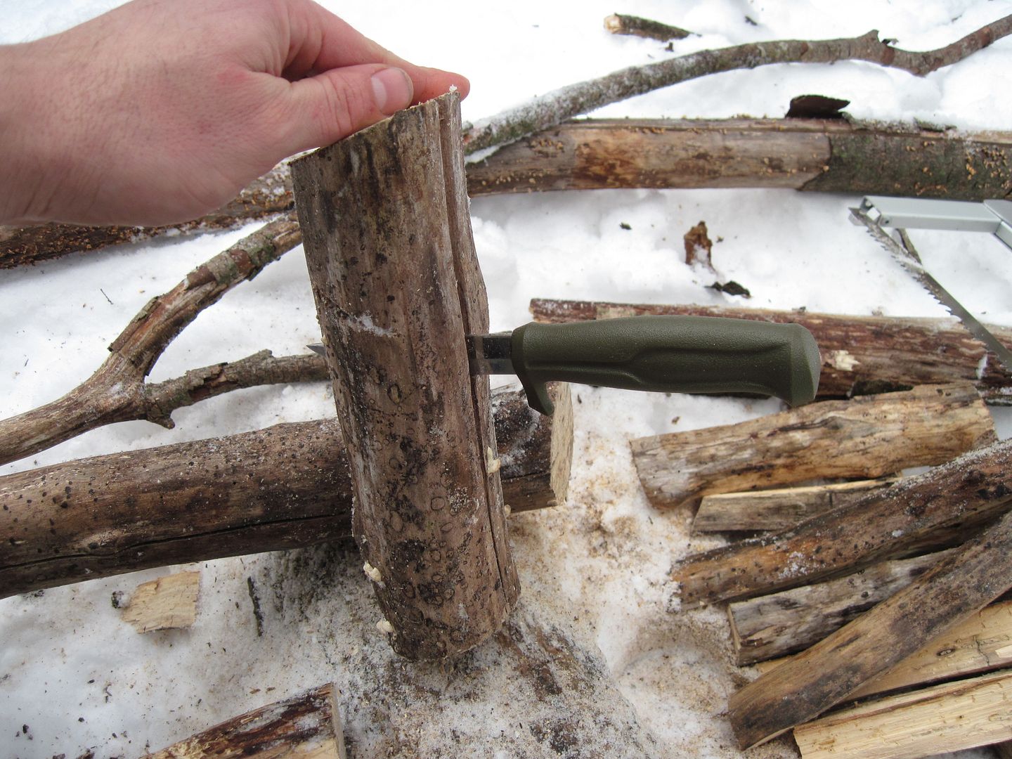

A .098 SS knife. Batoning wood for the small tent stove.

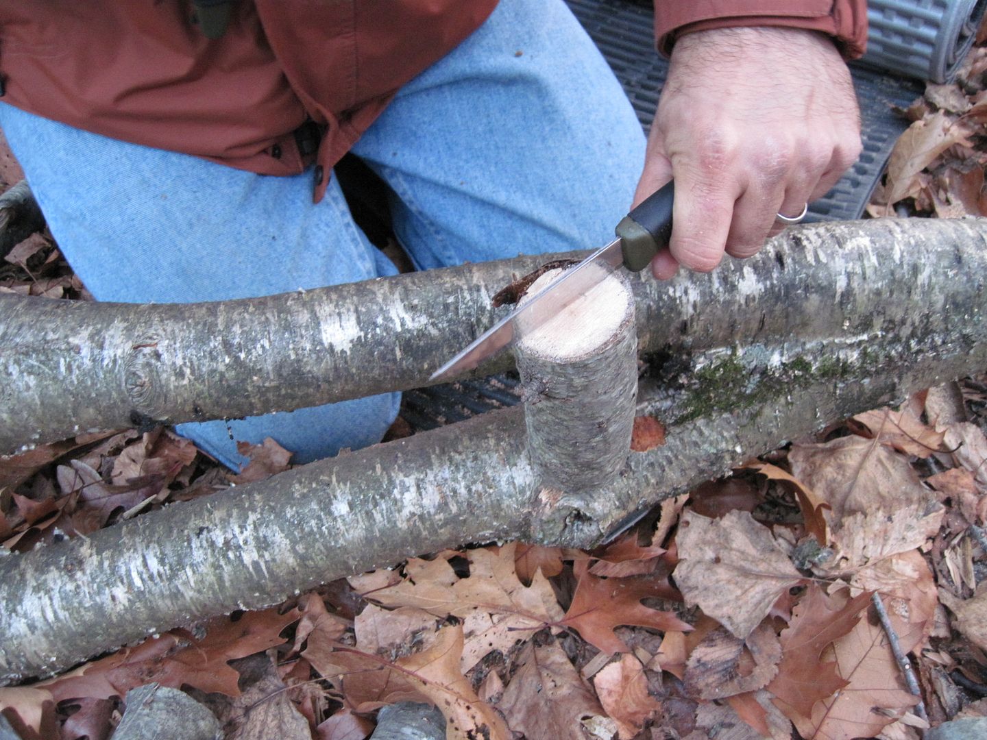

Another SS.098 knife. This one batoning during very cold weather through hard wood.
It got stuck on a knot or something and the beating, which was very hard actually started to pull the blade out of the handle but the knife didn't break.
So thin SS can baton just fine within reason IMHO.
