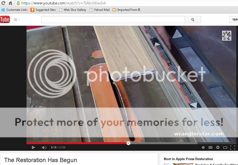

In this video (https://www.youtube.com/watch?v=7IAkxX6eoh4) he is making the staves for the containers under the press.
He is using Red Oak flooring for the staves. I've included a comparison of red vs white oak. According to Cody the original used white oak and it is 100 years old. Red will certainly work, but being more porous will not hold up in this application as the white.

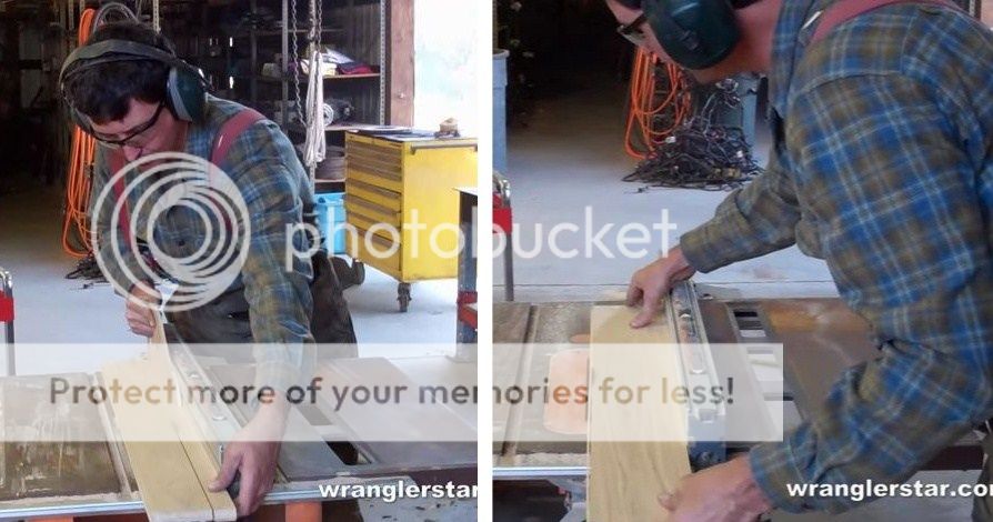

Here he is ripping the staves:
- "Avoid long sleeves, ties, dangling jewelry or any other loose fitting clothing while operating a table saw. The clothing could get caught in the blade."
- "Do not reach behind or over the blade unless it has stopped turning." Stay at the front of the saw.
- "Keep the blades guards, spreaders and antikickback devices in place an operating properly. The spreader must be in alignment with the blade and the antikickback device must be in place and operating properly." Sometimes these are removed in demos and a disclaimer is used. No disclaimer here and no need to remove safety attachments to see a simple rip cut.
Adjusting the fence:
- "Maintain the rip fence parallel to the blade so the stock will not bind on the blade and be thrown." In the still photo above his hand is on the fence. In the video he is actually thumping the fence to adjust it. I had a guy over using my saw once that started doing that. I'm afraid I got quite short with him about it. For one thing, on my saw at least, adjusting the fence is a pita.
- "Ensure that the guides are positioned properly and that the tabletop is smooth and polished. An unclean or rough table requires you to use more force to push the stock through the blade. The more force that you are required to use the more chance that you may slip or lose your balance." The picture shows (to me) poor maintenance of the table. I don't like to see that rust.

safety good. only thing i'll point out is that he has a big metal warehouse kinda building, not insulated, and pretty much no heat. he's shown examples where his slop bucket has frozen solid :D yikes. so, dress warm? i definitely see the conflict. warmth. safety. how does one manage in the real world? curious.
yeah, i see way too many people in a lot of videos with no safeties, guards, and other stuff like that, and it's pretty clear they probably operate that way *a lot* or *all the time*. yikes.
reaching over, or around, and stuff. yeah. bad. a few guys/gals use pushers. some have nice sleds (like http://woodgears.ca/reader/index.html), cool stuff. i'm trying to learn as much woodworking lore as possible. yet stay safe.
oh yeah, and don't stand in line with the work; esp key with ripping on a radial arm saw, apparently. NEVER DO THAT. maintaining parallel is apparently hard, and those things will kill you dead six times. so i'm told :D
yeah, that would drive me nuts...

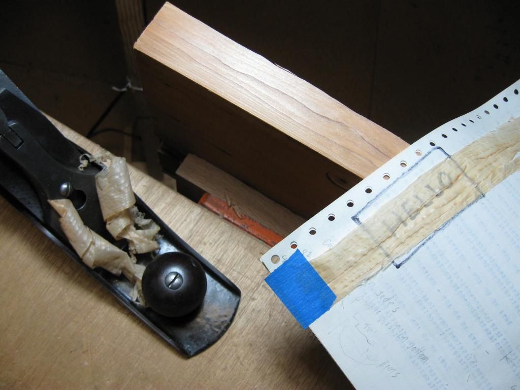

p.s. before pics of plane at the top of the post

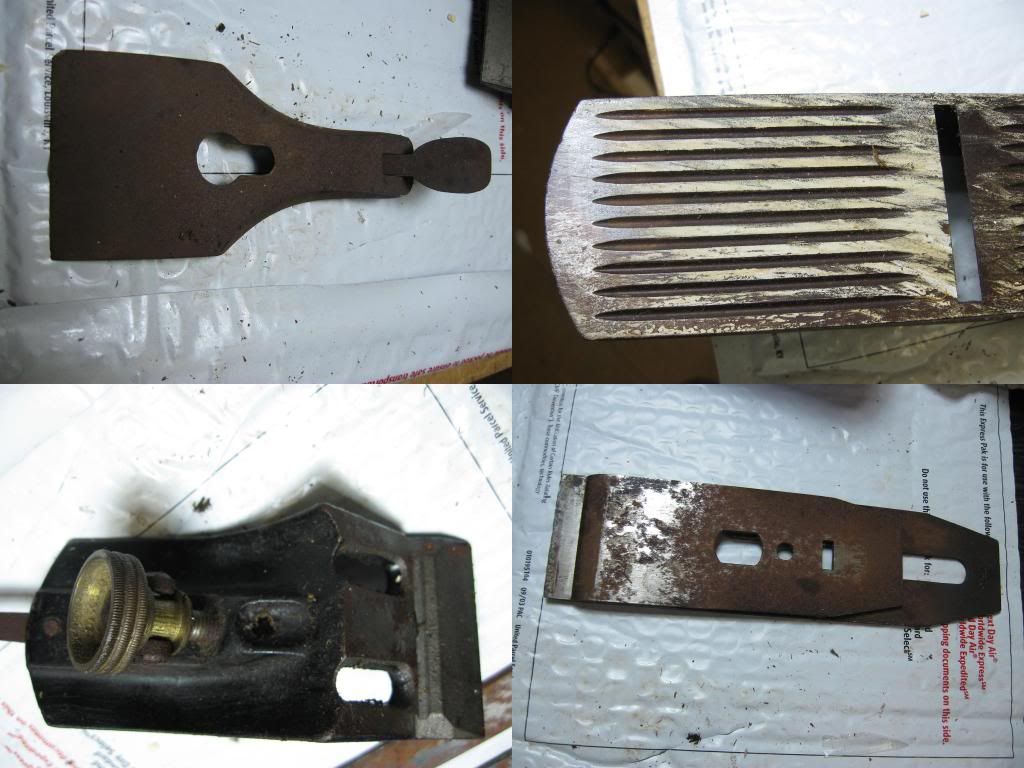

sweet! we should start a thread for restoring planes and tips and tricks and stuff :D
i dig it! took me a few looks to figure out the printout (old school). that's some thin shaving.
me too! i got some stuff to restore:
i scored some guy. some old, some dirty, some... and now i have a grinding station. so, some tooling with occur.
to all:)
