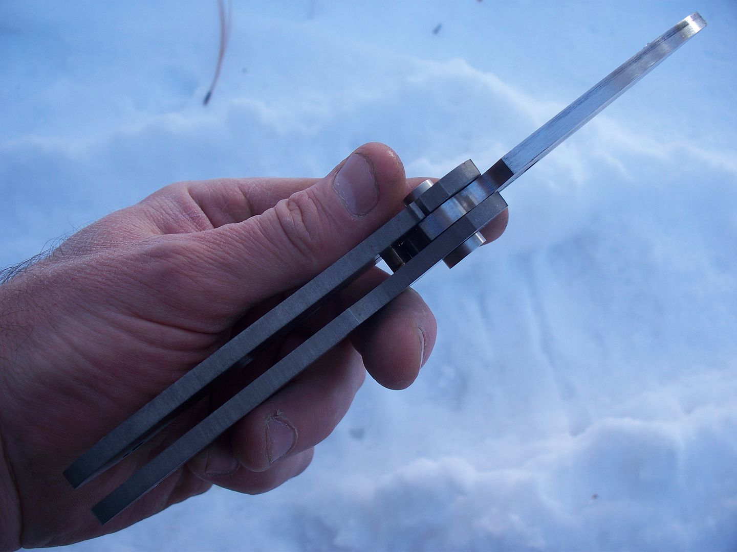

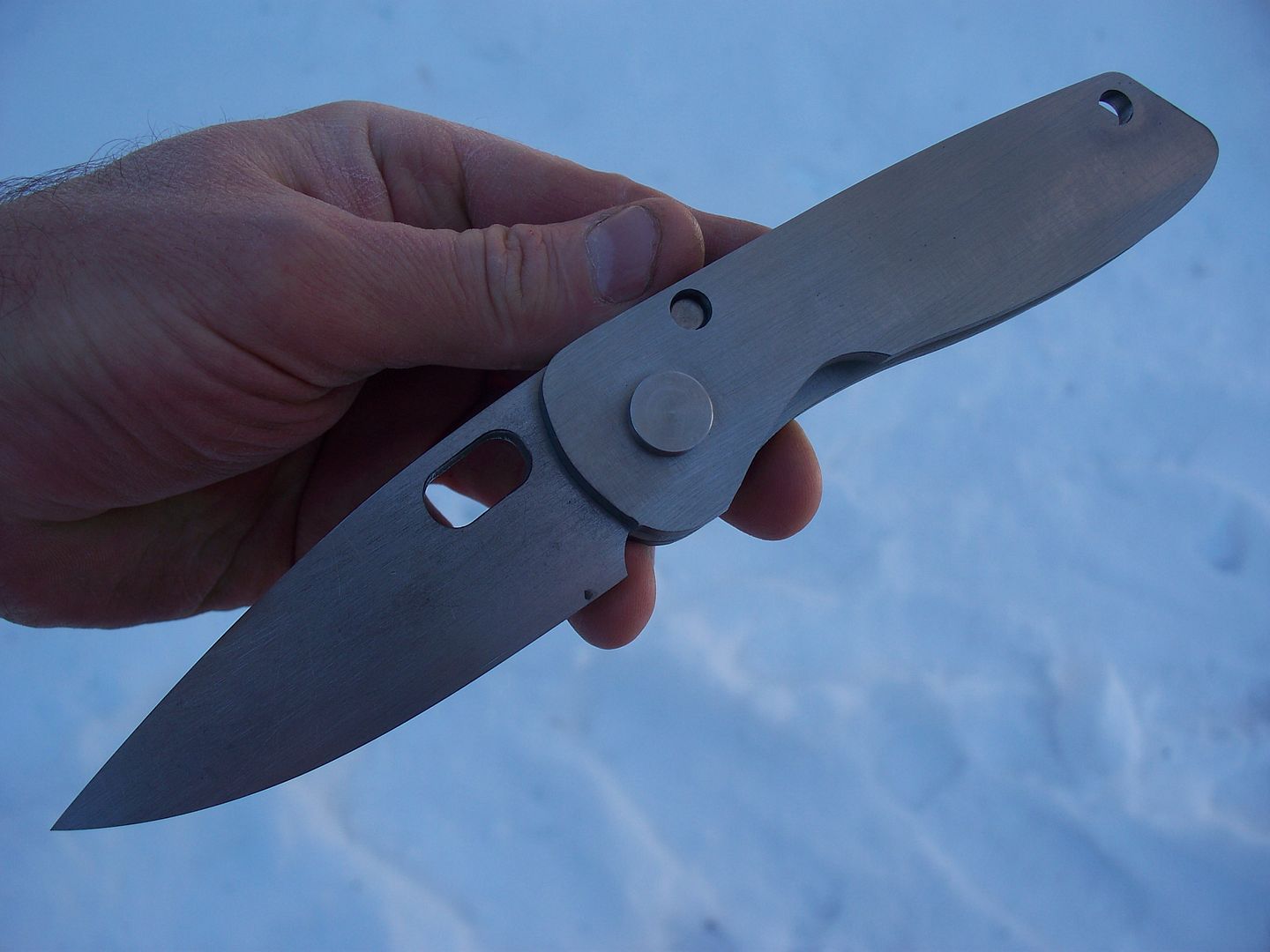

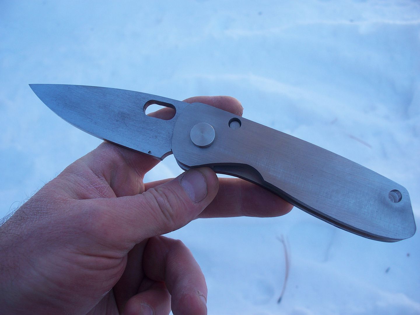

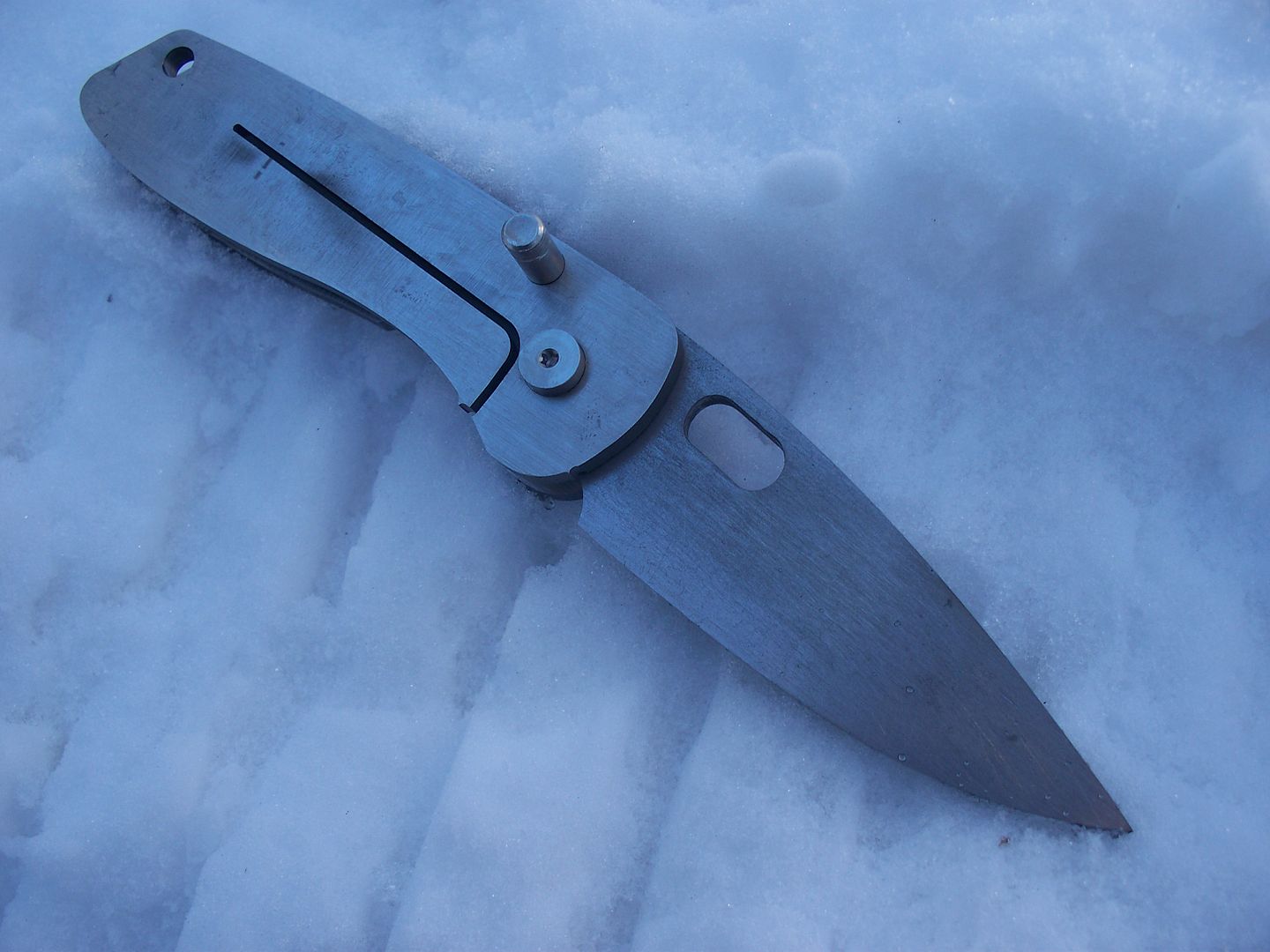

And I'm well on the way... waiting on more parts/bits right now and still have a ton to do but it is looking like a knife! I have about three days into this one so far... :D

One of the big things in my design is the location of the lock face in relation to the pivot, I designed everything around that and the hardware size. In theory the lock should be exceptionally strong. Lock strength has more to do with geometry than anything else.
There is a trick to the detent as mentioned, so far with the one I have done the lock up is rock solid.
One thing seldom mentioned is that the lock bar itself also has to do with the detent. It depends on how much sideways pressure the lock generates as to how solid the detent is. The thicker the scales are in the relief the more pressure can be exerted... of course the more pressure the harder it will be to smoothly release the lock. The more pressure the harder it will be to flick open too... It is a big balancing act in which everything must be right.
