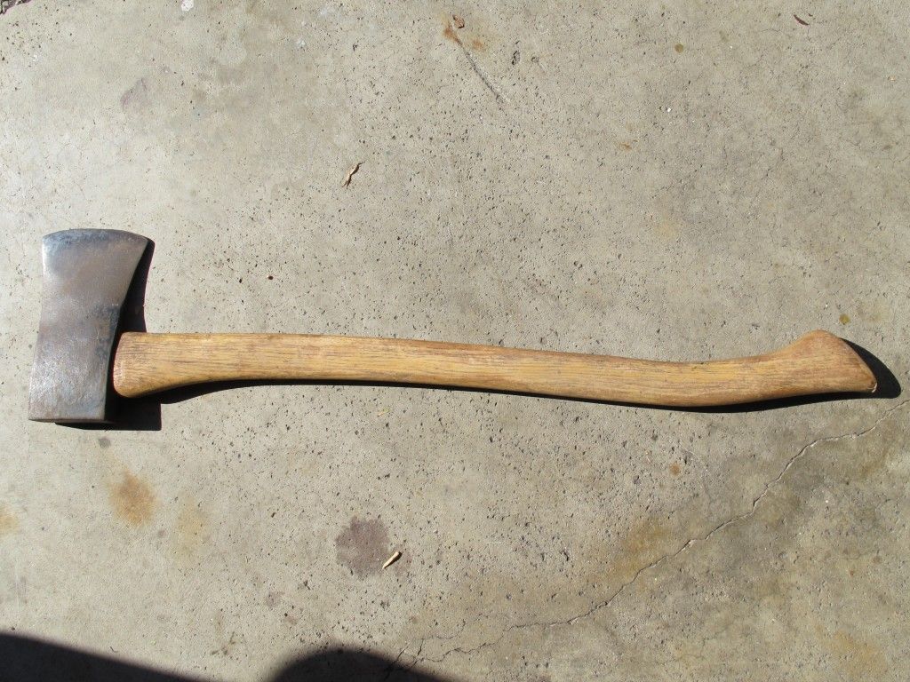

I adopted a no name boys axe, the head has nice contours, and the haft is sound.
That's great. Likely a vintage True Temper, but Collins and a few others also put those ridges in the eye. You can tell the haft is vintage because the fawns foot is unclipped - comes to a point not flat on the end. That's a good handle. Sand it down and give a a few coats of BLO.
It cleaned up real nice, used a cabinet scraper to remove the varnish and gave the haft a hot wax, then cleaned and sharpened the head. I can see why folks like these little axes, it feels good in the hand, can't wait to swing it.

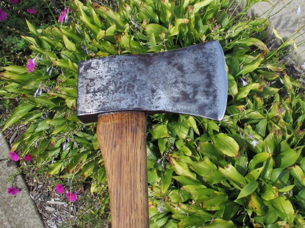

i think the fact that the eye ridges are evenly spaced, directly across from each other would suggest a collins, or possibly another manufacturer. from what i have come across, all the TT/Kelly stuff had 2 and 3 ridges, unevenly spaced across. for some reason i remember a TT/Kelly Pulaski that had evenly spaced ridges though... could be remembering wrong though.
I've seen plenty of TT's with 3 ridges on each side (there's one sitting next to me on my desk right now). But I've seen 2 & 3 on TT's as you describe as well. I haven't reached any conclusions about matching ridges to a particular maker. I suppose a forensic expert could but I ain't that.
One thing I have found, all the axes I've owned with eye ridges were at least decent axes. I haven't found a POS among them ever.

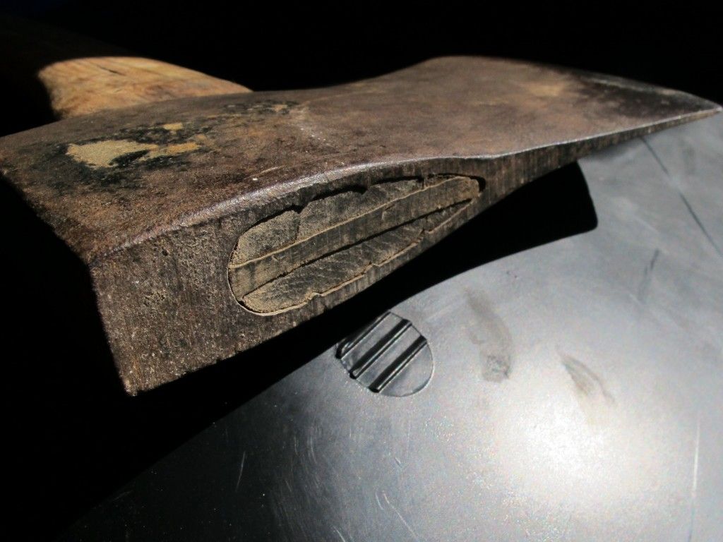

Hudson Bay with ridged eye. There's some sort of stamp on it I can't make out under the paint, looking forward to getting that cleaned up. I'm NOT looking forward to re-hanging it... I had a less-than-fun time rehanging a Norlund Tomahawk due to the lack of contact between the haft and the eye... any tricks anyone can share?

That Husdon Bay looks really nice. Is the handle broken or cracked? it seems like a great candidate for a sanding/BLO refurb which would get it back up to speed without a re-haft.
No, the head is a bit loose though so I'm planning on rewedging after removing the metal wedge. Handle is in great shape otherwise.
I have one of those ridged eye Hudson Bay axes. I think it's a True Temper. It's quite a bit heavier than the Collins, Norlund or others. It might be a 3 pound or heavier axe. The problems with the narrow eye that people complain about may be increased in this axe due to the weight. I don't see too many of them.

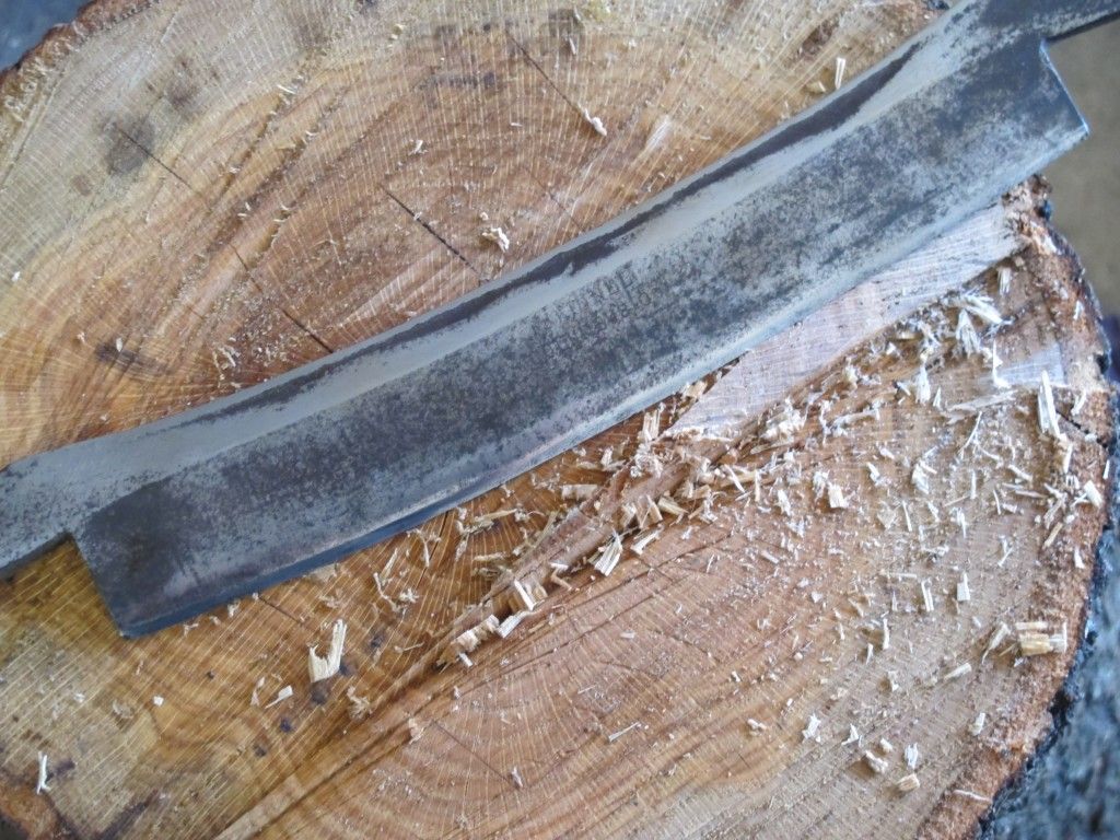

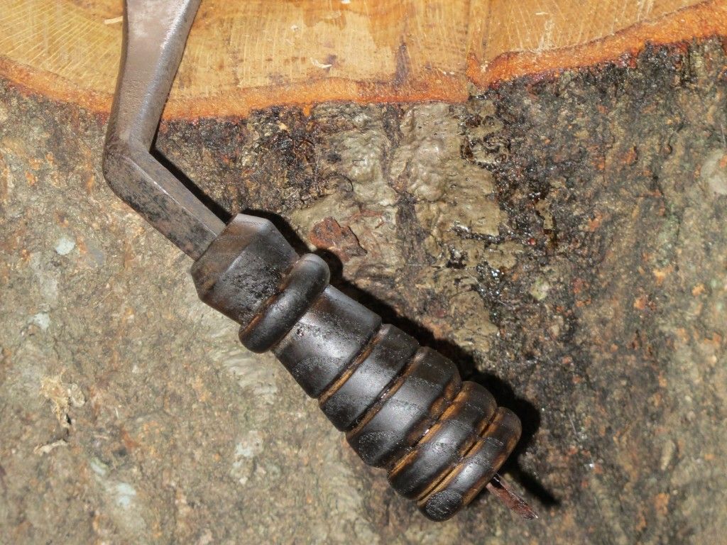

A rusty old $5 draw knife. Bubba used it as a froe at some point in it's life. The edge is good, I could feel it through all the rust, and it is very hard, all my files do is remove rust, skating is an understatement.
Found a name but it looks more like a personalization engraving than a makers mark.
RH Kinnel
Columbus OH
I have not really sharpened it, I just concentrated on rust removal, but it cut through the oak fairly easily and can't wait to see how it performs after stoning and polishing.
I think finishing the new grips before honing the edge is the safe way to go.
