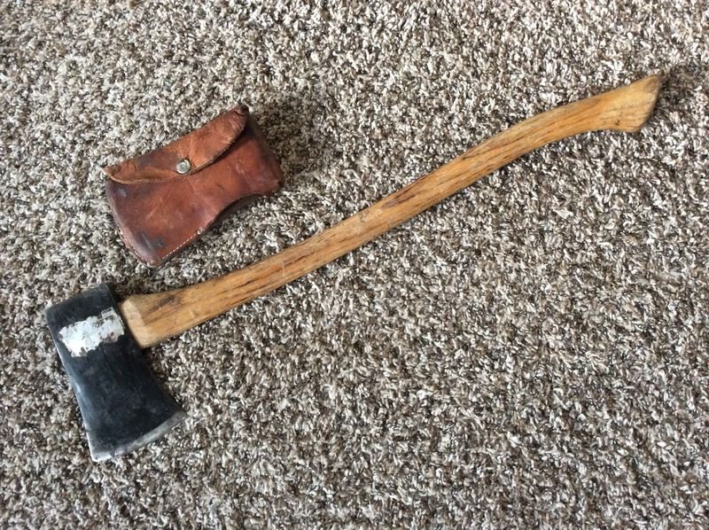

Lost my job on Friday , went out today and looks like I got myself a new job ,
and I scored this boys Woodslasher for 5 bucks ! I've had worse days that's for sure. Like Friday I guess lol
I've been on the hunt for a leather sheath for a small Boy scouts axe and I can tell you $5.00 for that nice sheath is a great deal never mind getting the axe as well!

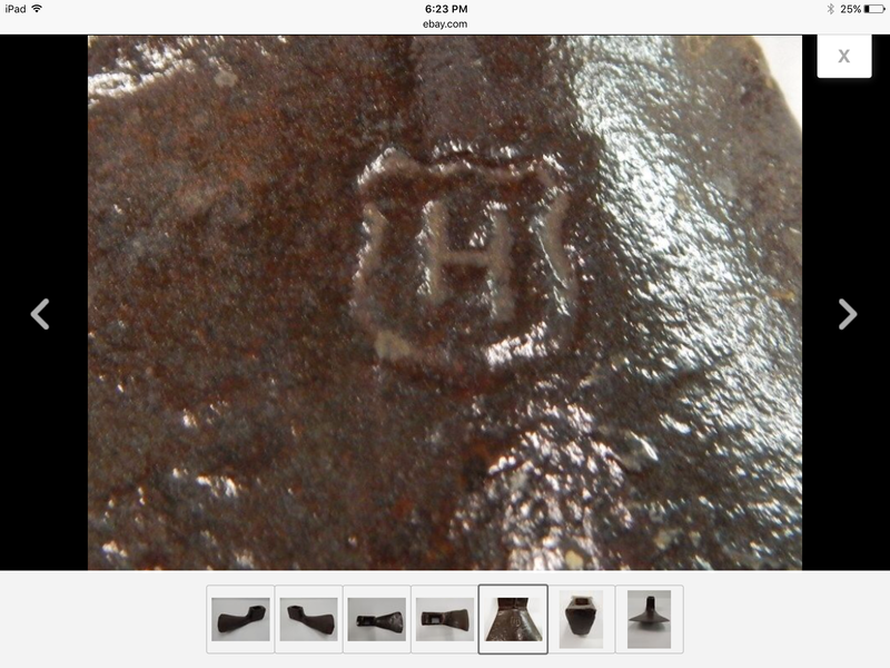

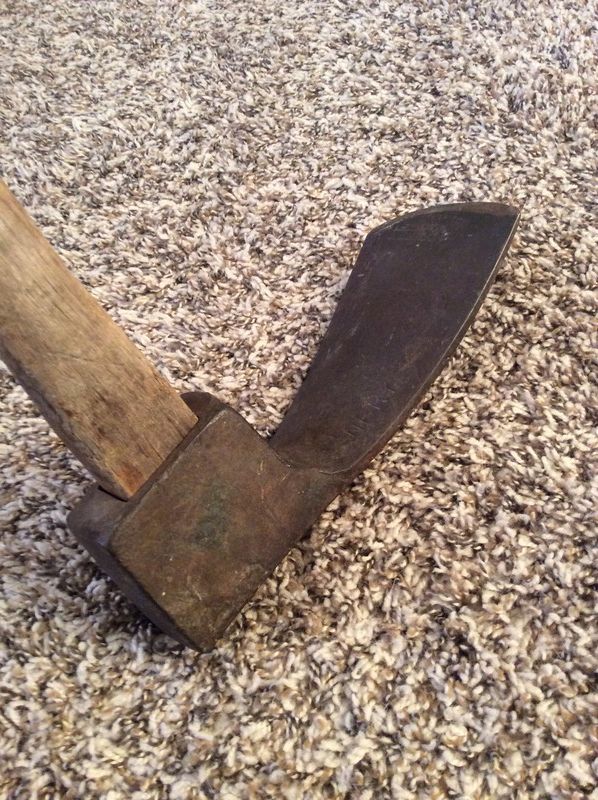

Got this feller today for $10. Any ideas ? Looks to be a "H" in a shield stamp ?(Charles E Hall Co ?)

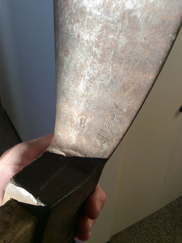

NPRY ? Googled a bit and Northern Pacific rail road comes up. I'll add a pic of another adze I found online that shows a similar stamp?
Nice ! That would be cool as hell. Any ideas on dating this thing ? I did see a thread about adze's here and one about them being used to cut spikes ! That's nuts.
