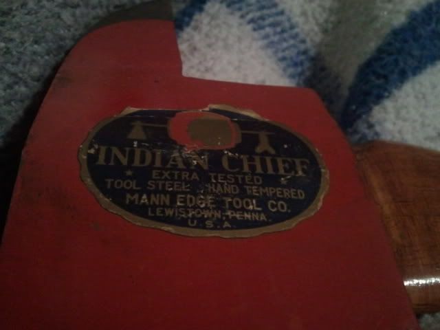

This would be a Mann "Chief" would it?
	Has hat poll been chipped and broken? Is there a hardened poll on that?![]()
Has 5 under pole, weighs 5.1lbs on scale.
Mushrooming I haven't touched, the previous owner must have hit something hard on only that side. I might try to peen it down with my anvil, I figure if it got that way with no heat it can go back with no heat.Has hat poll been chipped and broken? Is there a hardened poll on that?
