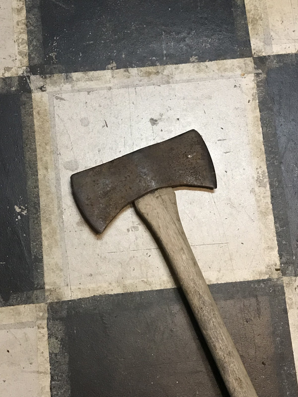

Yes sir it was the prize of the day for sure!! I couldn’t believe it when I saw it. And $15.... got outa here!! I know some would say this is “just” a Woodslasher but for me it is a long awaited union lol. I am rehanging it now and it’s turning out great! Better than I could ask for really. I’m going to let it set today so I can set the wedge a little deeper then I will sharpen later. The file test compared to my Flint Edge hatchet. I think it will become my new truck axe and see a lot of use!!! Thank you for the kind words!

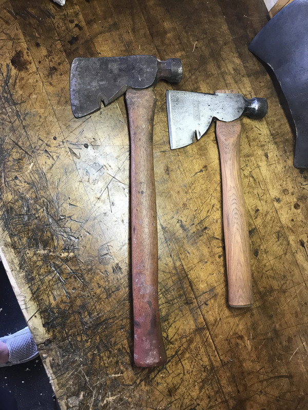

So the one on the left followed me home today. It is a Keen Kutter. I put it next to a Collins half hatchet to show the difference in the handle. It is like a normal half hatchet handle then it is longer and has a swell that is curved for the hammer side. The head has red paint on it and the handle also has a reddish hew at the bottom. It is either an original handle or a vintage replacement handle. The handle shows no sign of being homemade. But it is possible. Has anyone else seen this type of handle??
...has a swell that is curved for the hammer side. The head has red paint on it and the handle also has a reddish hew at the bottom. It is either an original handle or a vintage replacement handle. The handle shows no sign of being homemade. But it is possible. Has anyone else seen this type of handle??
I'm guessing it's a Plumb "rigster" hatchet handle (replacement) on that Keen Kutter hatchet head. The Keen Kutter catalog from 1939 has a "rig builders hatchet" on page 847, but the handle is white and doesn't have a prominent flare on the hammer side.
The Plumb catalog from 1965ish was still showing an asymmetric flared knob on their "rigster" hatchet handle, and it's red.
That's a sweet Keen Kutter.
I think the user probably modified that handle. And judging by the bit I am guessing that tool has seen some use, the milled face is probably also worn? Those things break handles like crazy. The handle has probably been replaced many times over.
Garry, It is hard to get the likeness in the picture but if I could I bet you would see it hasn’t been altered. But it is possible.
BookReaderImages.php
https://archive.org/stream/PlumbTools1965#page/n9/mode/2up
Steve, the head also has a waffled face on the hammer... when was the earliest mention of the waffle pattern? If I had to guess it would probably be an new example right?
The "rig builders hatchet" on page 847 of The Keen Kutter catalog from 1939 has a "checkered face", and the 1912 Keen Kutter catalog has a lathing hatchet with a round "checkered face", and a tobacco hatchet (3-1/2" bit) with a "checkered poll", but the 1912 catalog apparently doesn't have a"rig builders hatchet".
