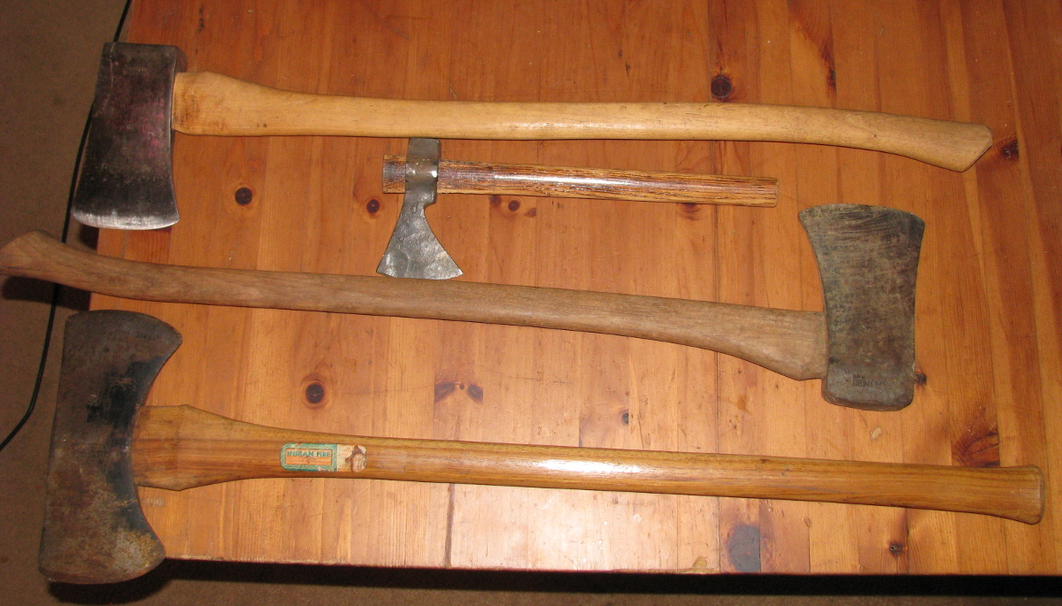

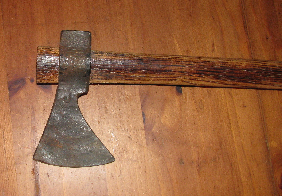

I bought a few old axes from my neighbor the other day. The DB is a Vaughan Super Steel re-hung on an Indian Fire handle. The Michigan is a Craftsman (so likely a Vaughan) that is old enough to have convex cheeks. The little guy is a 3J Buck Hammer Head Hawk. The top is a Vaughan Value Brand Dayton.

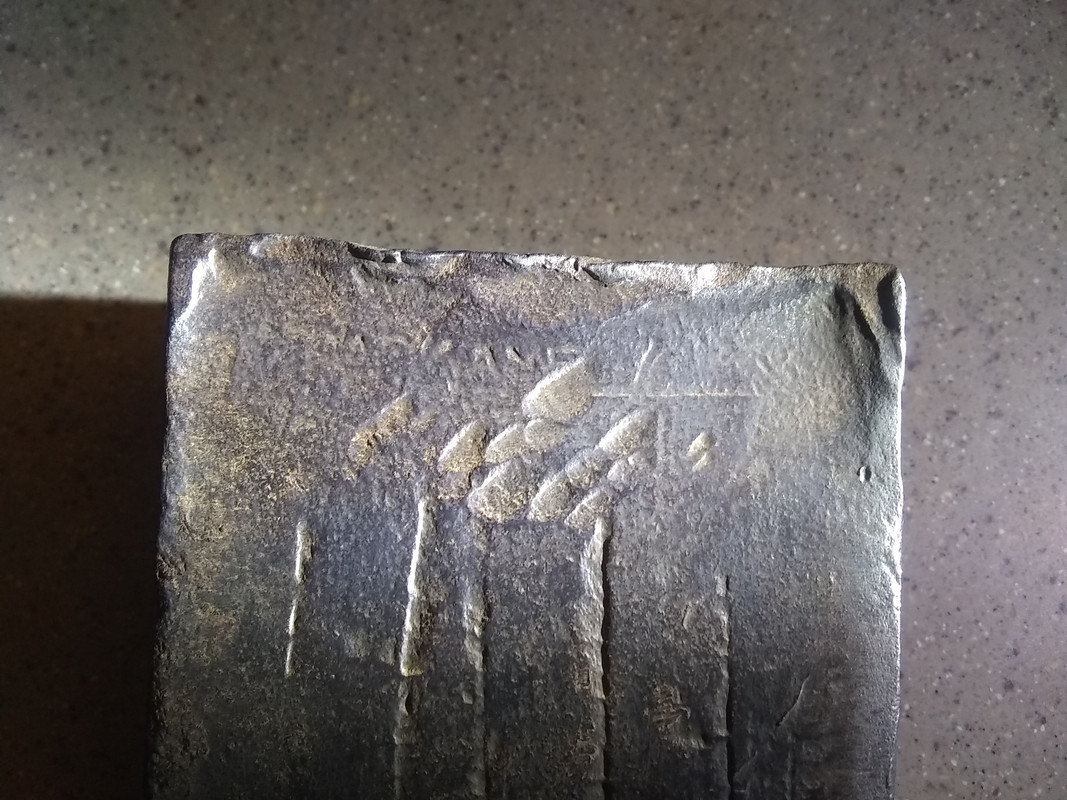

Here's the stamp on the little hawk.
I'm pleased with the Super Steel axe. I don't find a lot of Vaughan axes up here. But I now have a Value Brand, a Super Steel and a Sub Zero.
A story about the Value Brand axe. I had sold that to my neighbor about 6 or 7 years ago. I originally bought that axe in about 1982. I bought it from an elderly gentleman named Ted Arnsburg in Wenatchee. I had worked with Ted at the local country club as a summer job between high school and college. He had a heavy German accent. He was well into his 70's then and still hard at work. A few years later I lived just a couple houses down the street from Ted. When he passed away I wanted a souvenir so I bought this axe with a broken handle at his estate sale.
I carried that thing around with me from house to house for 25 years before I ever got around to re-hanging it. That's what got me into restoring axes. At 4 pounds it became my primary splitter for several years. When the neighbor took a liking to it I sold it to him cheap and hung myself a new splitter. Now the neighbor has moved on to an assisted living home and I've bought it back. I think I'll keep it this time. The Ted Arnsburg Axe. I think Ted would be pleased.
The story behind the Value Brand is probably worth more than the axe. Also, if it's anything like mine, that 3J will work well on a longer handle with a thinner bevel. My 3J is my favorite hawk.(It's also my only hawk:D)

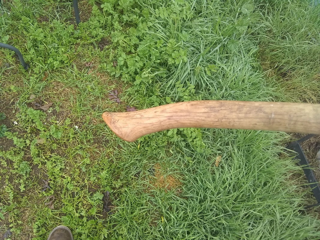

Here's the 36" off that brush axe, I didn't get any before pictures but trust me it was pretty bowed.
It straightened out really well, there's some wavyness on the right side but there's not much I can do about it.

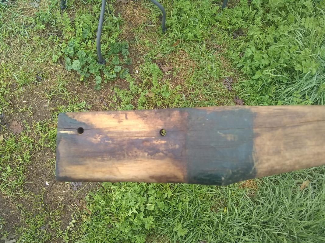

Here's the crack I've got to fix after I pick up some food wood from the hsrdhard store later today.
I suppose I'll just find a way to get some glue in there then wrap it tightly with a strip of bycicle innertube until it's dried.
How does one go about straightening a haft? Soak it & clamp it?
Heat, by steam or a heat gun.
I'm no expert but I'll tell you what I did which was easy and worked well.
Make sure to wear gloves.
I put the handle over a stew pot of boiling water, covered it with aluminum foil and put a folded towel over that to help seal the steam in as best as I could.
I let it steam for 20 min then bent it back by stepping on it , then I just clamped it to a board to keep it straight while it cools.
Theres a recent thread on the subject in this forum if you just scroll down a bit , in that thread there are links to other threads with good information.

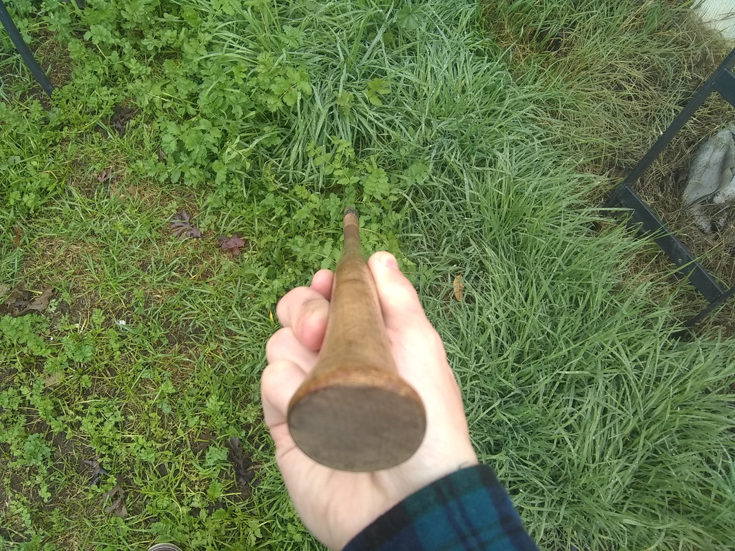

Love the fawns foot on that thing. It'll be a fine old haft.
Me too, and it's really the only reason I brought the brush axe home.
As it turns out the brush axe is a bit too easy to file anyways.
I think this will be the perfect haft for my great grandfathers homestead Michigan, I've had it for years and never found a haft for it I was satisfied with.
Really they were just plain crap.
