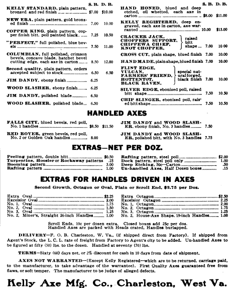

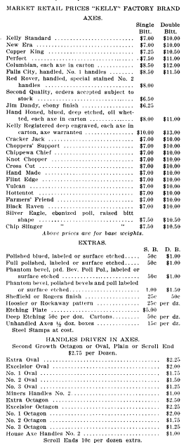

I recall that Flint edge and black Raven were the same cost originally as well.
What exactly is the difference, apart from the branding? Same steel and fit and finish? Commercially branded vs. consumer branded?
Square Peg do you know when Kelly(AF&H) switched to mono steel axes?
I do not. My guess would be pre-WWII.
Yes, in the old catalogs that were posted here Flint Edges and Black Ravens were the same cost. One would suppose they are materially the same - just different marketing. Then again maybe the Raven stamp cost more to make and they skimped elsewhere?
The 1957 TT catalog lists everything as being made from single bars of steel, even the Woodslashers. Also, there are no Black Ravens offered by 1957, still before eye ridges were made.
1913 catalogs show Flint Edges and Black Ravens were the same cost. They are even grouped together in one ad. I'll get pics up tonight to tomorrow.

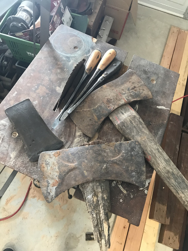

I bought these from a guy that was visiting a scrap yard. One is a Plumb the other dB is a kelly with the bevels and the boys ax is a firestone. I almost left the boys axe because it was so rusty but I could see the convex shape so I got it. After cleaning it up I was very happy. It is the first time I have ever found a firestone axe. Thanks for looking!
Oh yes and two perfect handle screwdrivers from the scrap yard. One is in mint condition. The other is in mint condition other than one grip got scorched by something. The third is a made in German perfect handle style screwdriver.
